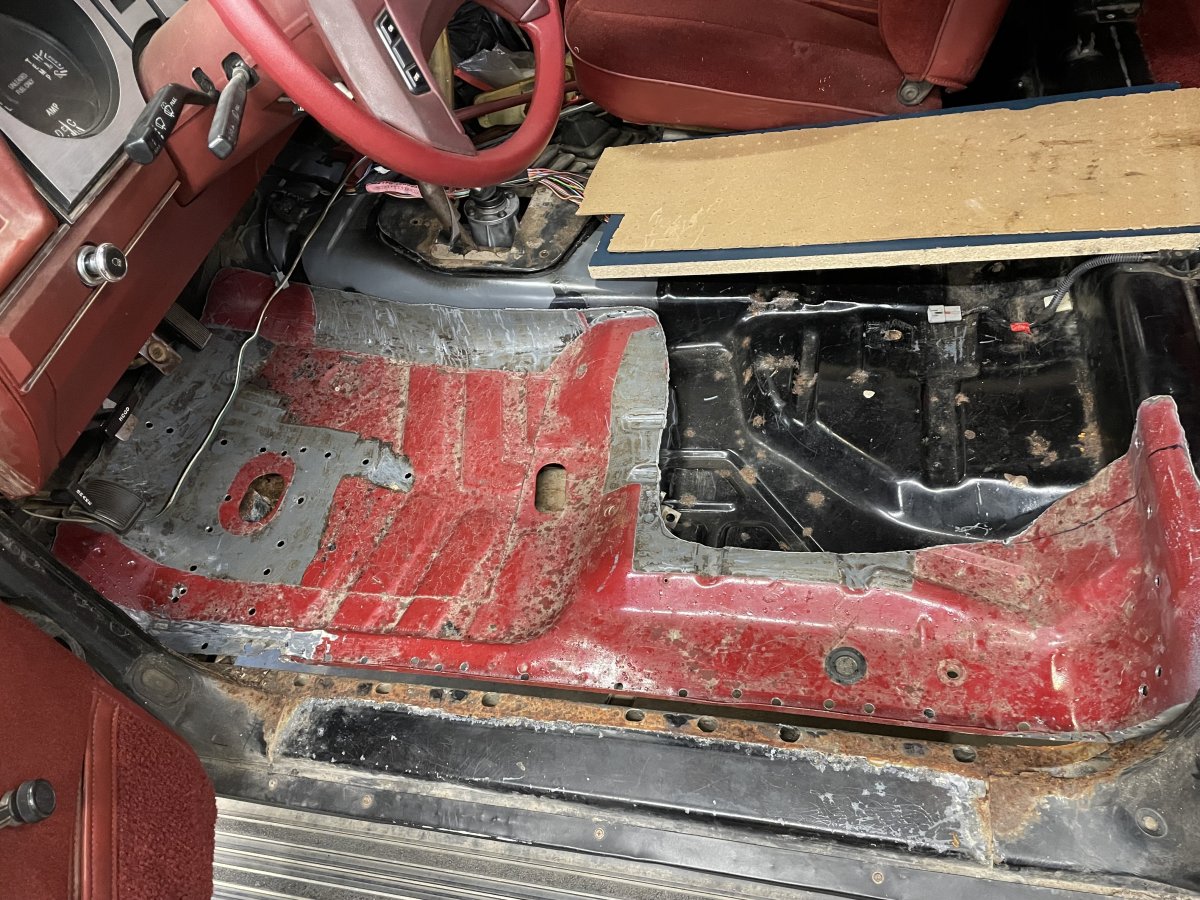

Finally getting around to doing something with this truck and it is a MESS to say the least. After getting the carpet out we discovered that it pretty much has the entire driver's side floor pan deleted by rust. Transmission was toast (knew that) but it's also got a broken axle shaft in the front and some of the diff bolts are loose. Weird. Front brakes locked up, rear wheel cylinders leaking. Wires going everywhere for what I'm assuming were lights that are clipped off. :bad:

The floor is horrible. The seat was only held in by two bolts and it would lean sideways against the door if you sat it in. The seat tracks are actually rusted through as well, big chunks of them stuck to the carpet. Seatbelt was rusted off... lot of years of mouse pee and rain took a toll. But it is fixable.
Yeah, will take a bit of work. One of the prior owners did some redneck body work fixing the floor pan. With the carpet on you don't realize it until you press on the clutch/brake and the whole seat leans back with a popping noise. Once you lift the carpet you see the white, flat sheet metal with self tapping screws holding it in place. At least they went down with them. LOL

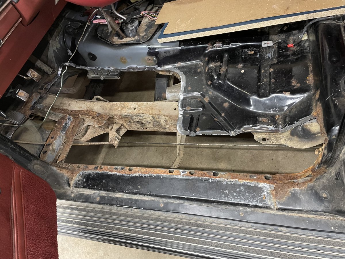

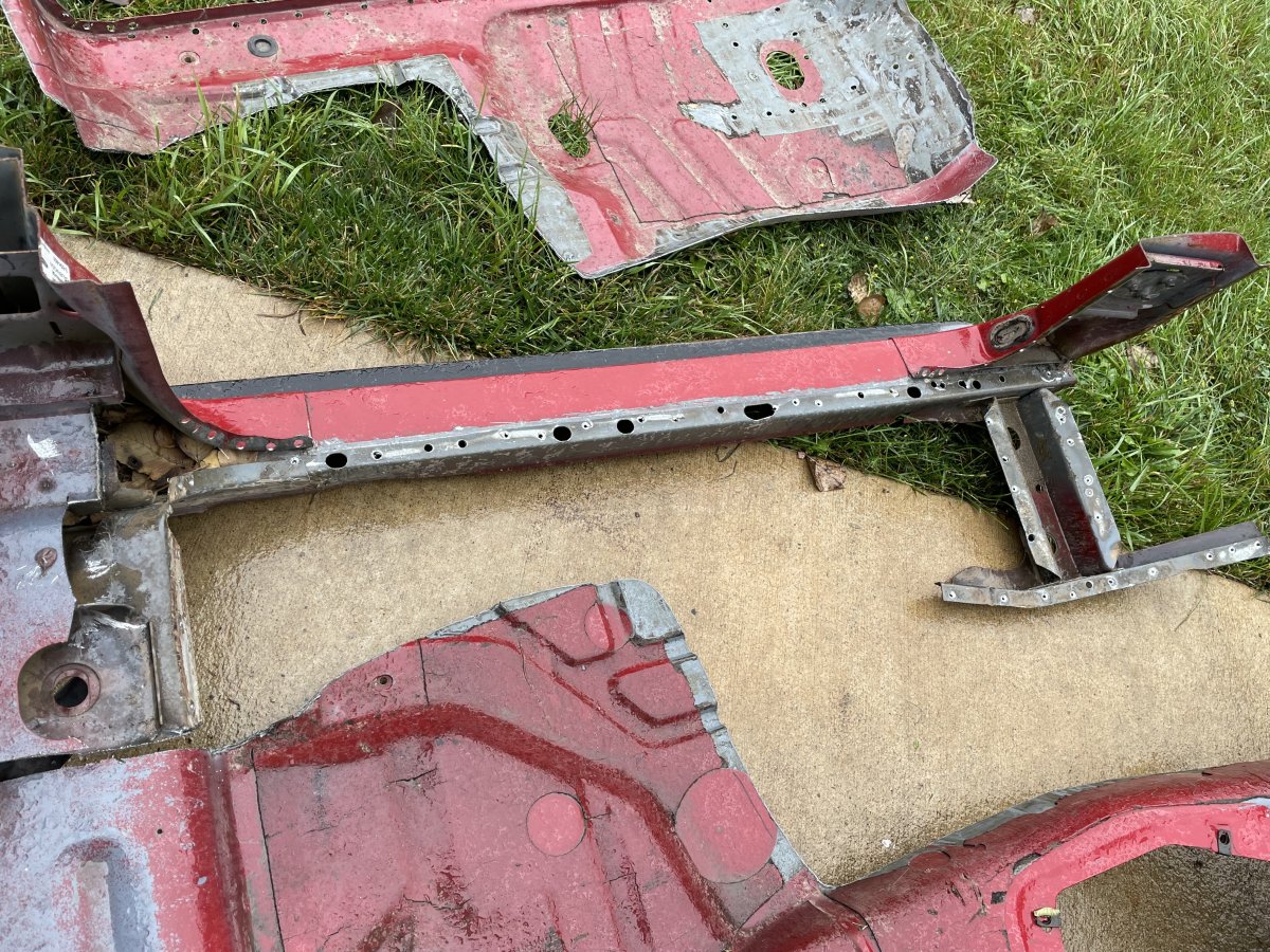

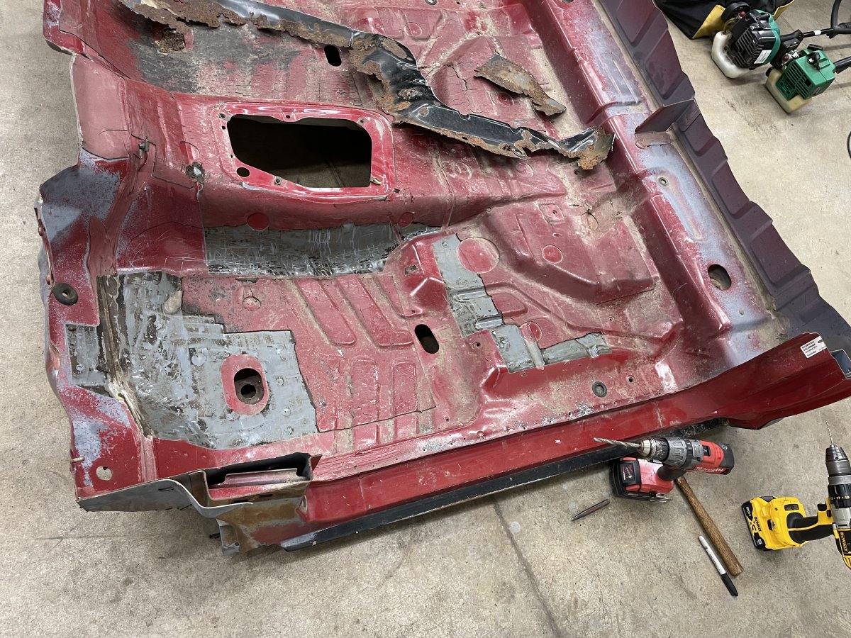

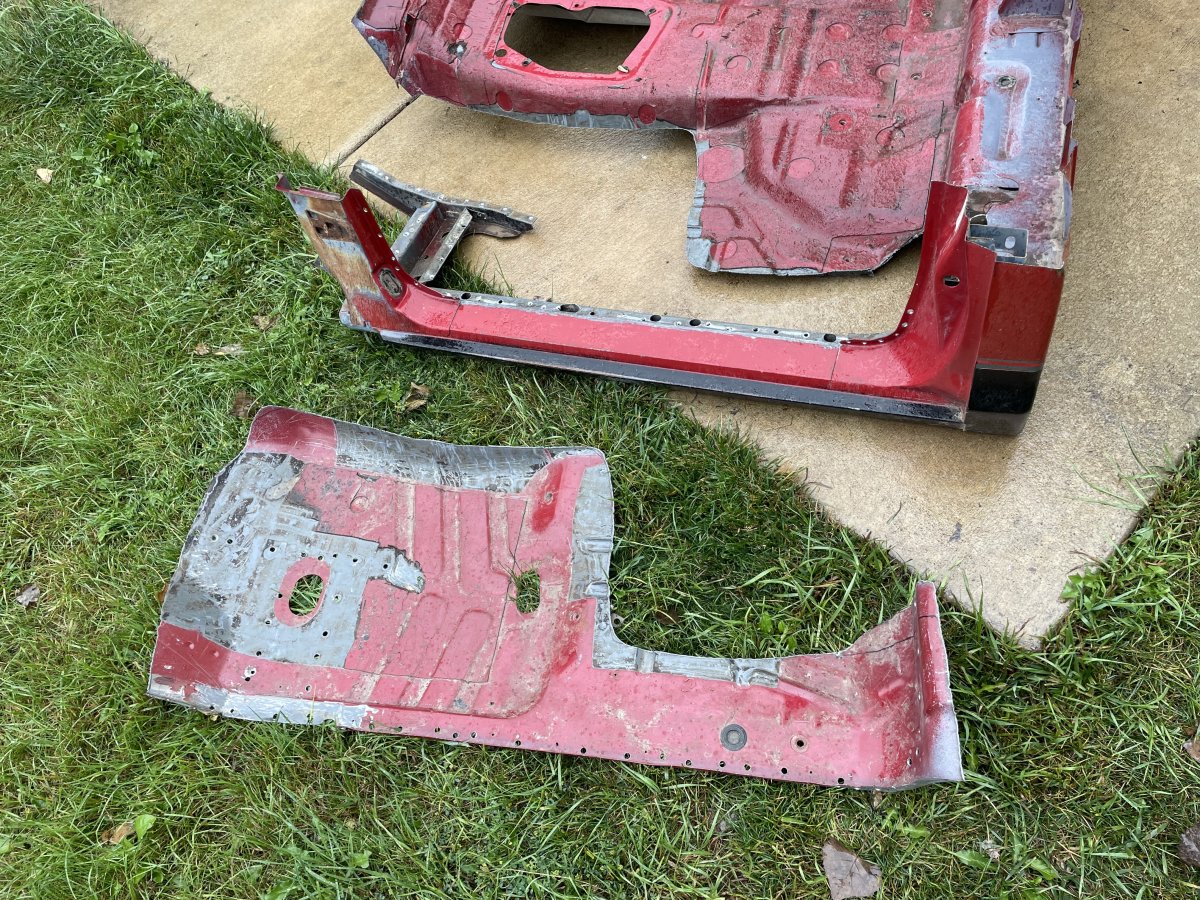

Small update, we got the rotten floor mostly cut out for a pattern last night and started removing a section from my donor floor. I didn’t know it is all spot welded together- that will make this somewhat easier.
Also mounted up some better tires on nice wheels. Looks way better.

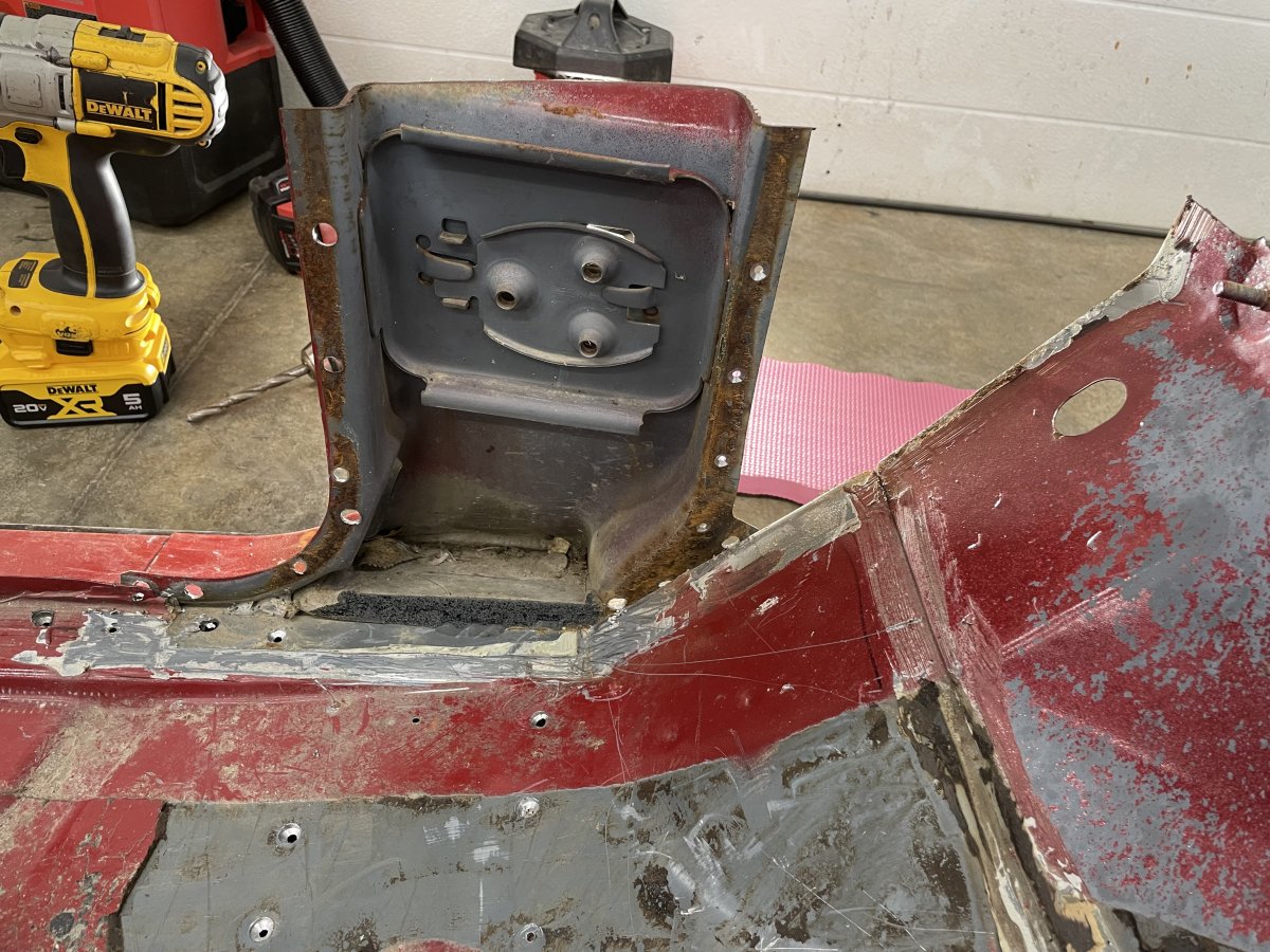

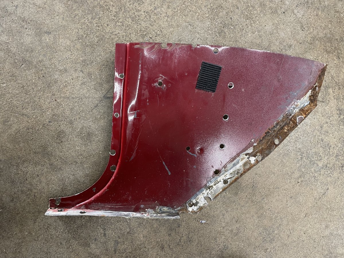

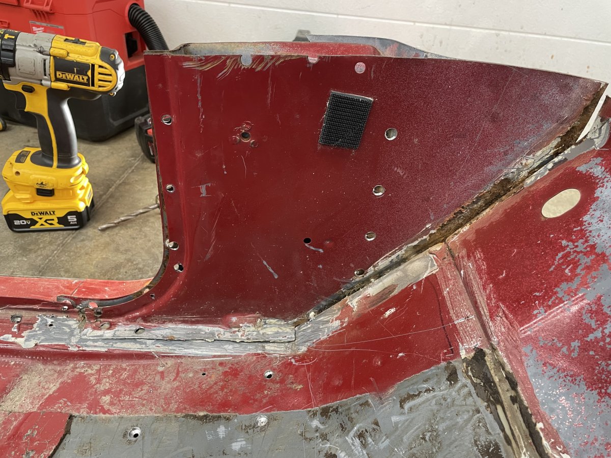

Floor patch piece removed… lots of spot welds to drill out. I also removed the A pillar torque box piece that always rusts out on these - I’m going to draw it in CAD so I can cut them on my plasma table, I doubt anyone is selling a patch panel for that area.
Patch needs to be trimmed but its a great start.
Lots of spot welds to remove if you do it this way.

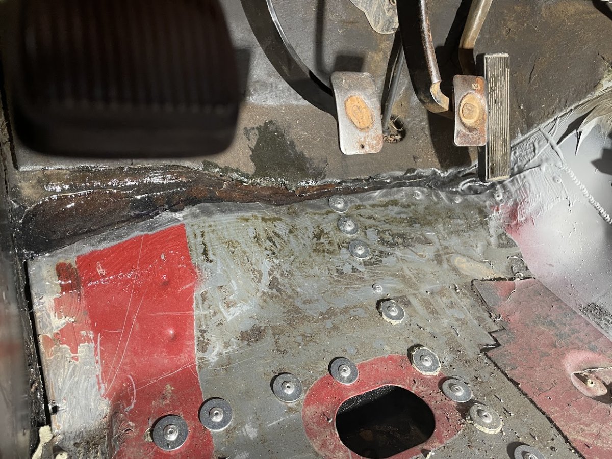

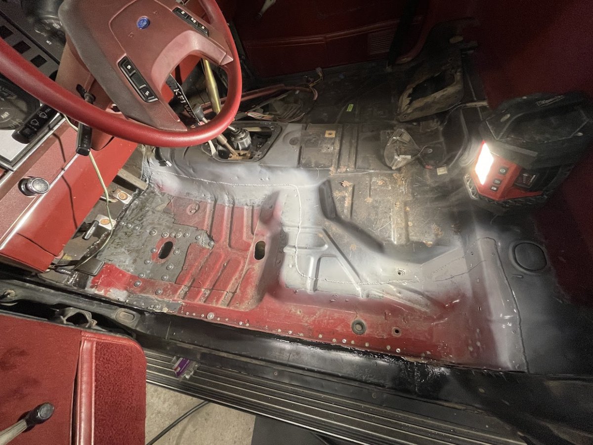

Still need to seal up the bottom side of this but my floor pan is more or less fixed. I riveted the patch piece onto the rocker and cab mount/floor support and then welded around the edge except in the front under the pedals... the rust is actually up past the pinch weld there and what's left is really thin and impossible to weld to. So I put a couple rivets on the strongest looking sections and then brushed a bunch of "Through the Roof" sealant into the edge to hopefully keep it somewhat water tight. I brushed some of that around on top of the rivets and on other seams too... it is pretty good stuff. Painted over the welded sections last night. I need to make one more little patch piece for the A pillar, find a grommet that fits the hole in the floor and then shoot the A pillar and B pillar full of expanding foam... that should be good enough for this truck.

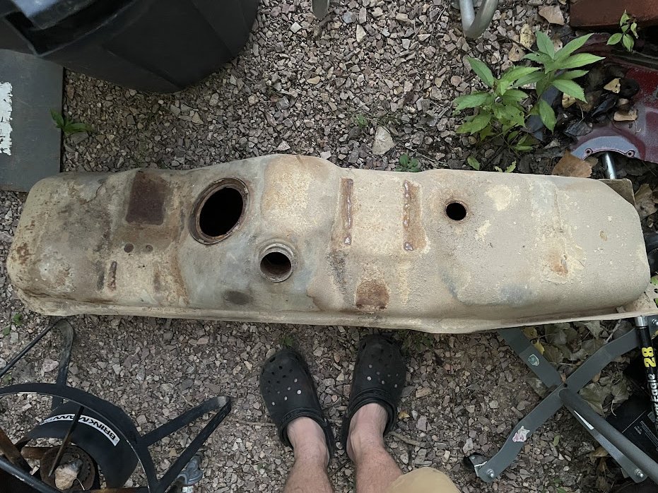

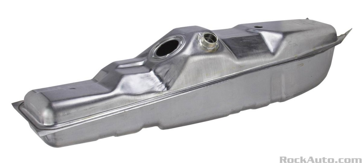

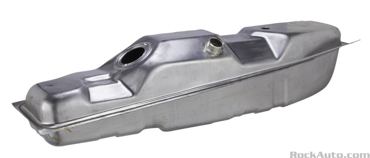

Never have I been so happy to see a hole in a gas tank... I've been dreading 15 gallons of 20 year old fuel in this sucker. Went to drop it last night and it felt awfully light............... like it was empty... sure enough. Right under the front strap. Tank is obviously garbage, sending unit is fine thank god, those have been NLA for years.
So I go dig out my good spare long box tank and it doesn't frickin fit. Way too long and filler neck in the wrong spot. WTF... an hour of looking at pictures on RockAuto and I'm just totally stumped.
What I have, don't mind the shop crocs:
My spare tank that's supposed to fit:
A short box tank that looks oddly similar:
So to summarize, I measured the box on this truck and it is a short box truck. Not a long box like I have been thinking for the past three years. It's been parked next to another short box truck for three years and I swear to god it looks longer. What's wrong with me?!?!??!!? ;brownbag;
