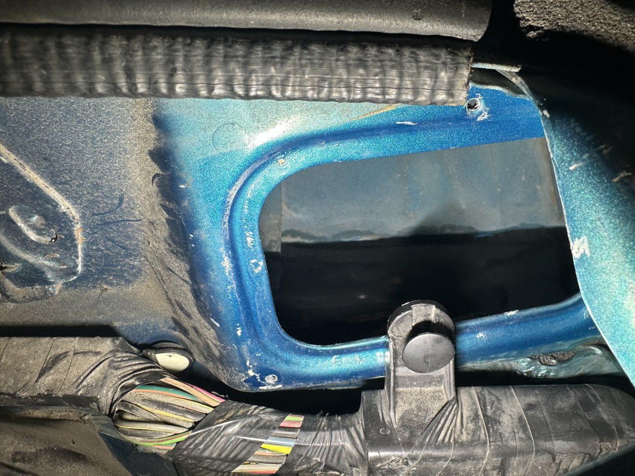

1. Remove both access covers to the drain.
2. Prep the area to your liking. For example, I unloaded a can of brake cleaner in the drain area and let it dry. This may not be the most effective cleaning method, but it’s better than nothing.

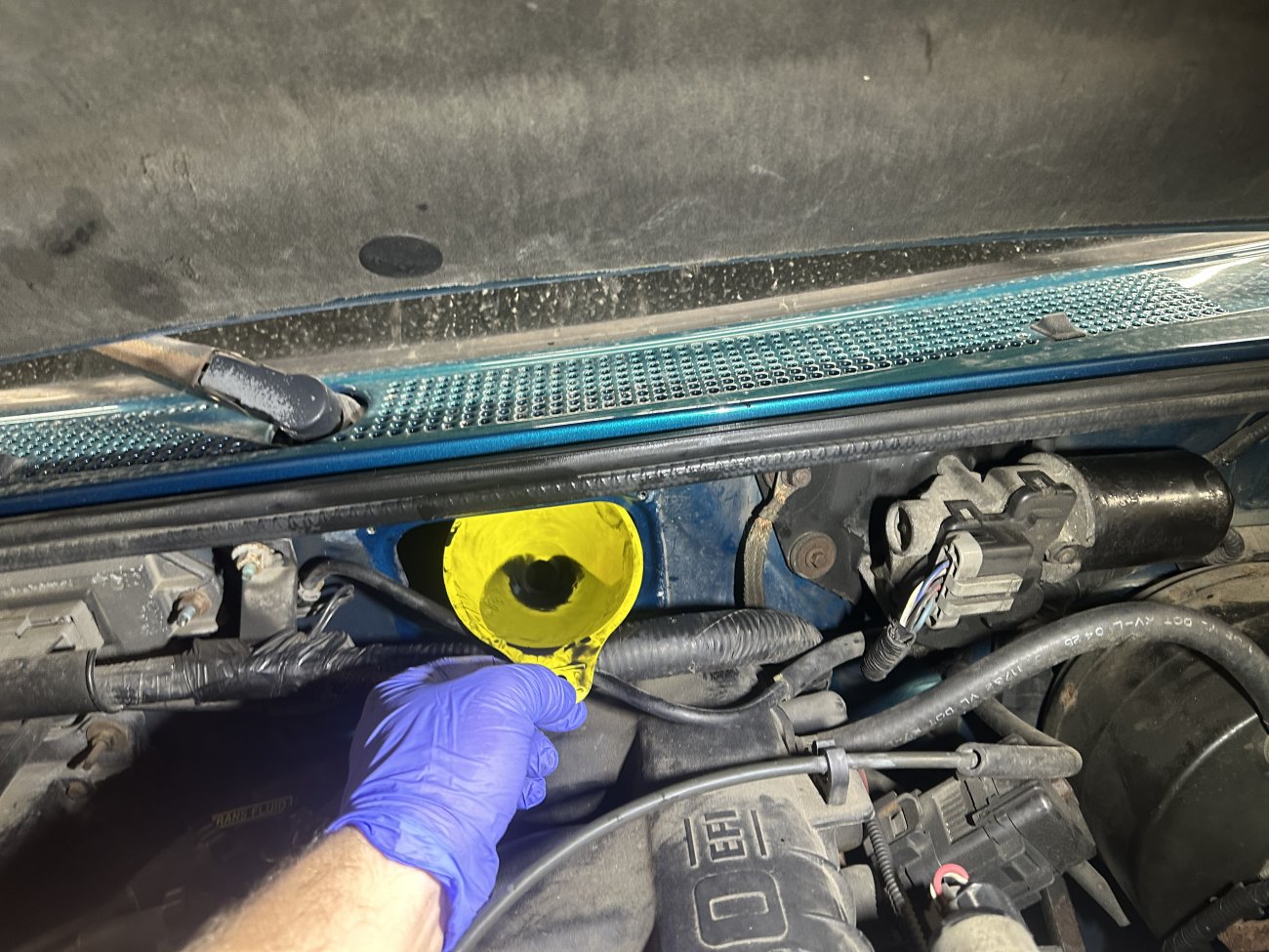

4. Pour a good amount of Flex Seal into the middle access panel. I poured about 8 oz. The bigger the slug of Flex Seal, the more coverage and faster it will travel down the drain.
Quick fix for windshield drain leaks: Flex Seal to the rescue!

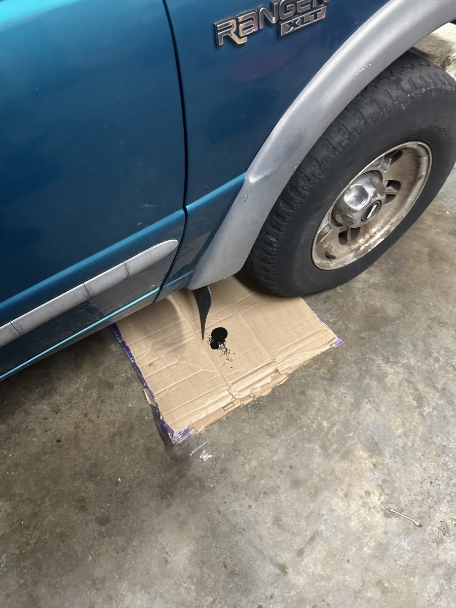

7. After a short while, you’ll notice Flex Seal dripping on the ground behind the passenger tire. (Place some cardboard underneath to avoid a mess.)
