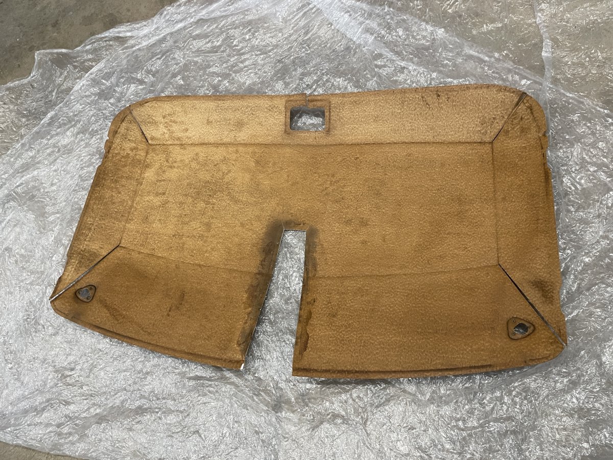

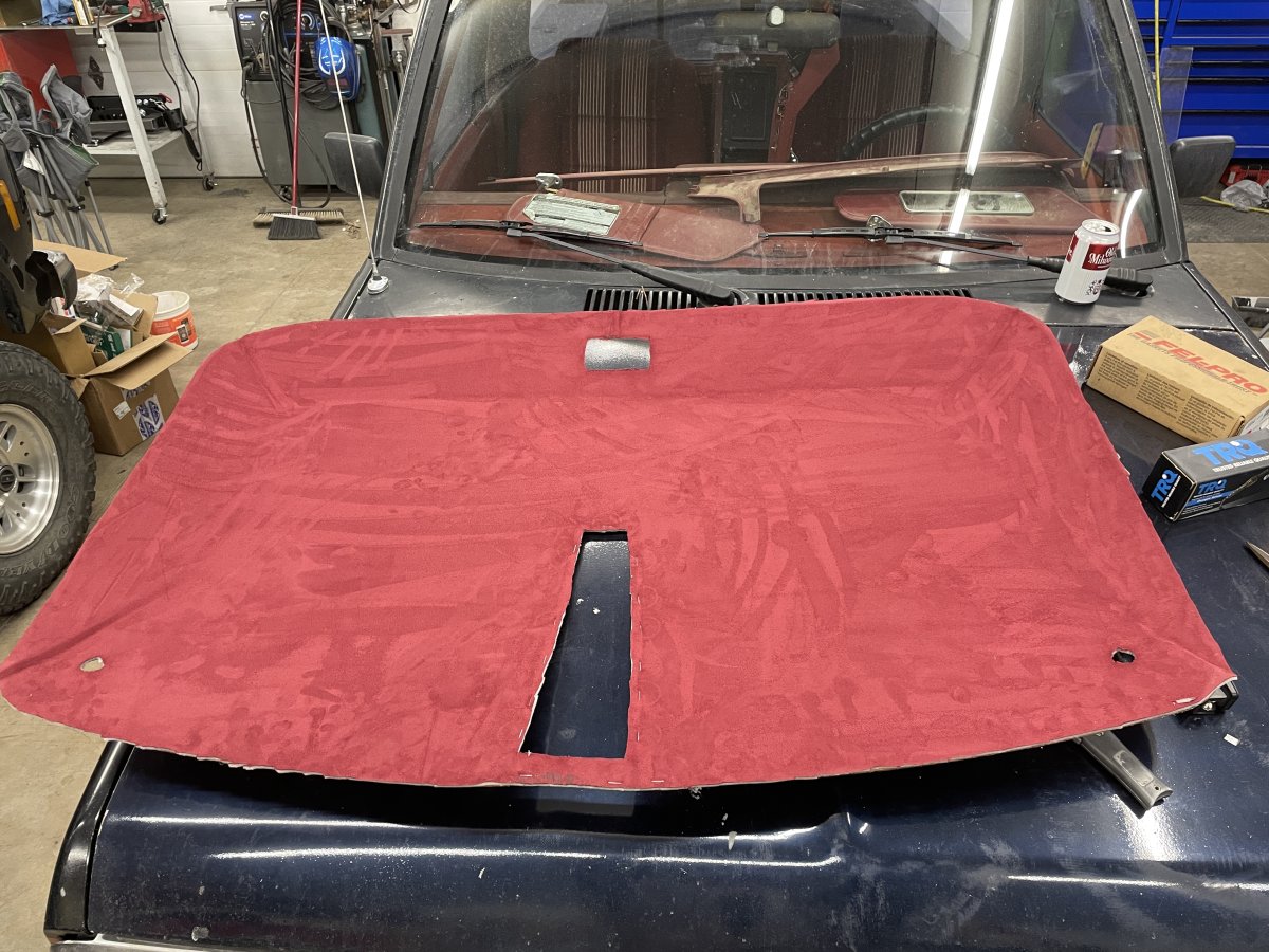

I just redid the headliner last night - the fabric fell apart a long time ago, and I was left with this nasty coardboard & foam mess:
Fix up/build thread for my '85 Ranger XLS
Wire brush got all the foam off:
New suede & foam glued on:

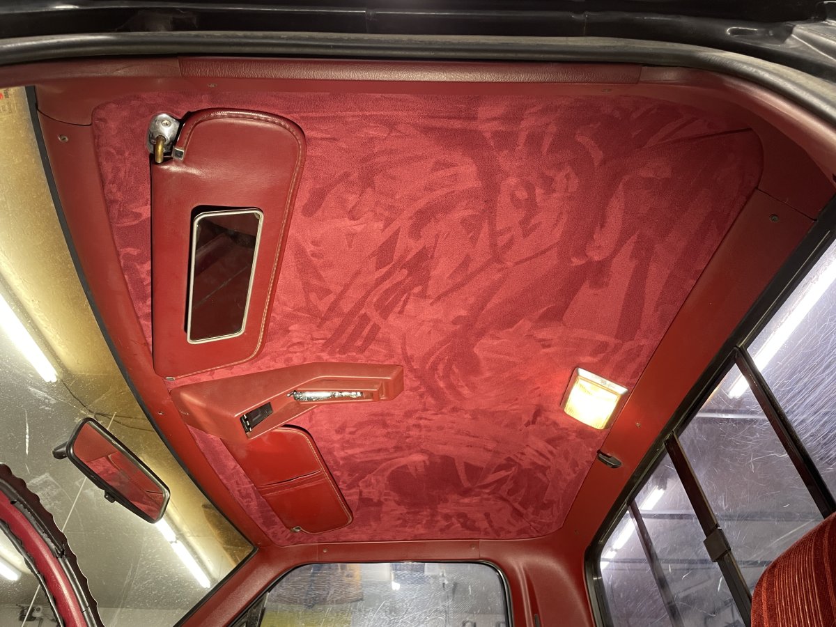

Installed - I am super happy with how it turned out.
Oooh that looks nice!
Thanks! The material was super cheap, $21 plus about half a can of spray glue. Now that I’ve seen the fabric on a beater project, I might do my Explorer with the same stuff.

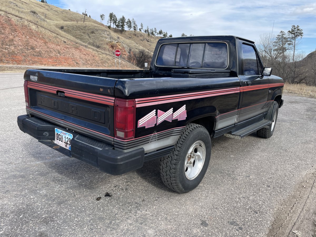

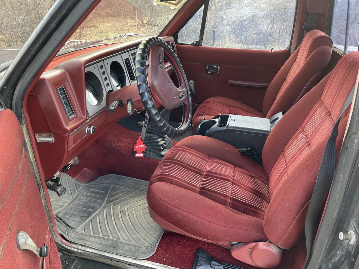

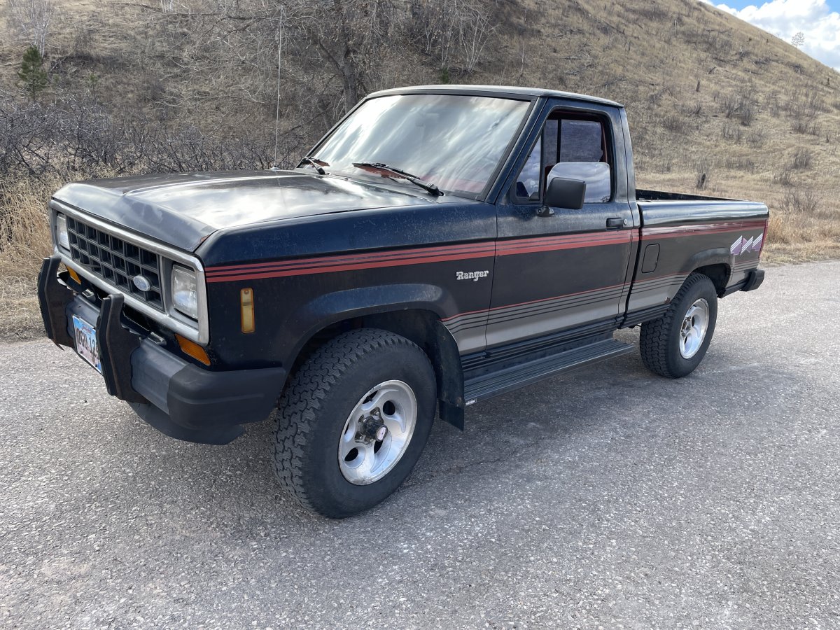

In other news I listed this truck for sale today. My kid was not as motivated to finish it as I had hoped so I ended up doing 95% of the work overall. He has not yet learned to take care of anything and I guess I just don't want to watch him destroy all my hard work. With my recent '94 Ranger purchase I need to make some space in the driveway so this one unfortunately must go. Here are some pictures, fresh out of the car wash.
