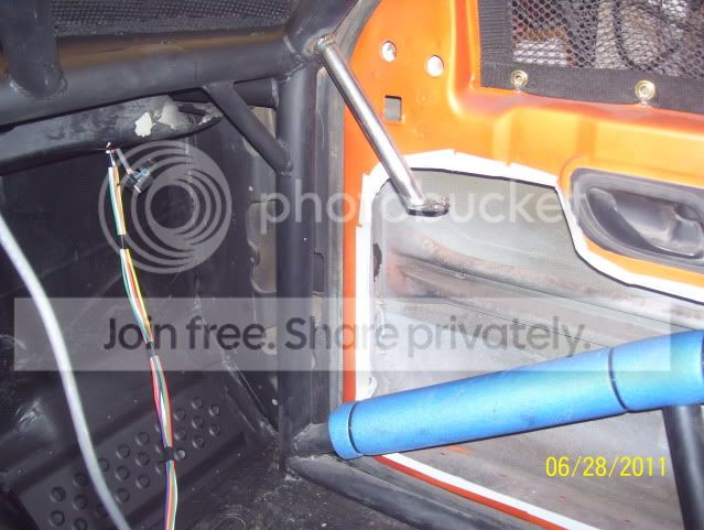

we made some custom secondary door latches, updates in a few
Here is our secondary door lock...its nearly complete only thing that is not done is our red ball knob, we had to order them offline since we wanted a red one. Whats nice if you do not unlock it all the way up, when you close the door it lock its self into position. Very simple and much easier to use for me then having to reach across and behind to undo a bugpack latch.

unlock

lock

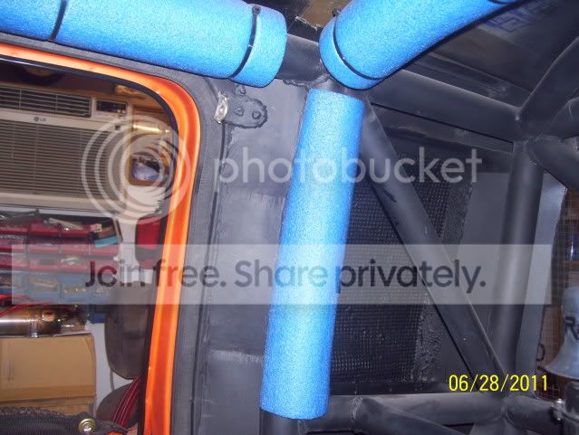

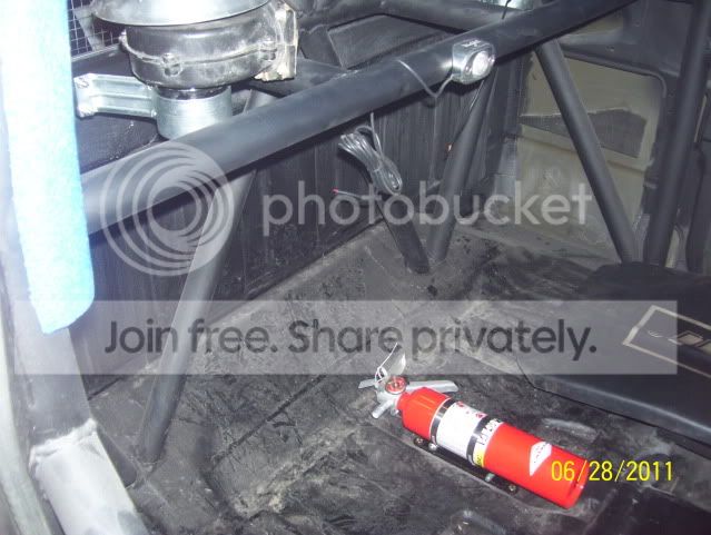

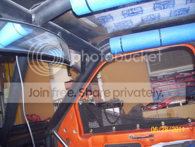

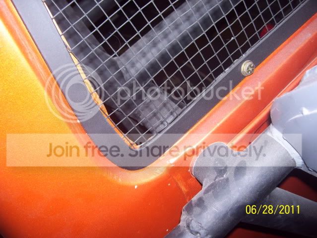

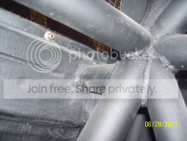

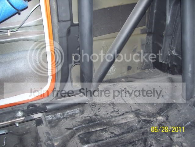

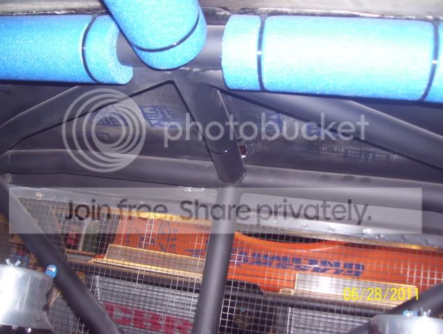

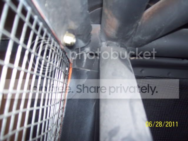

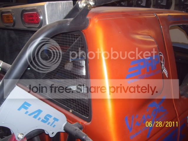

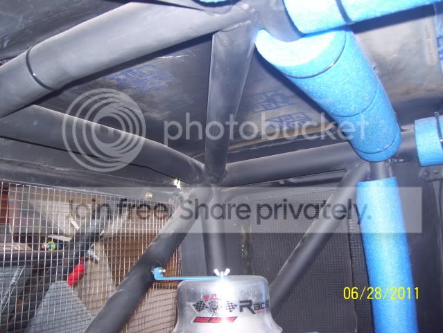

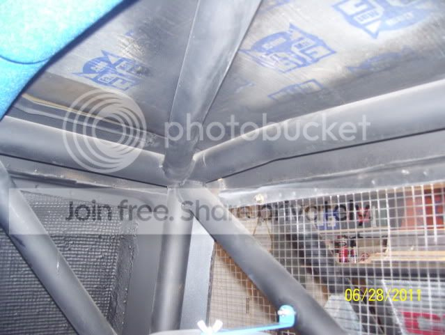

Can you post some more pictures of your cage on the inside, and where it comes out the back into the bedcage, I need Ideas, its about time to order some tube for my truck
sure... I can get you some pictures... there use to be these really cool grommets that bolted on each side of the sheetmetal and the tube went through...im trying to remember who made them and if their still around... if you really want to do a cage i suggest buying a score handbook, very informative.. there also other fabrication books out there... ill post tomo night for you
I already have a handbook, and I am building it with a guy who has already built a score tagged cage, which means he's doing the welding but I will do some bending and notching and stuff like that
sounds cool.. yeah ill get you pictures..i personally like the sub frame designs better on ranger.. my first cab cage was built that way.. then it was removed and had a 2" put in there with no sub frame
here you go man, we did not do the main cage.. there are some thing will be doing differently when we build our full tube truck... the bottom tube that goes into the bed should of been higher in the joint and went straight into the other tube.... basically we welded plates to cage and cab to try and fix what was done and make it stronger... for your B pillar if I were to do it in a cab again, I would cut into the inner cab skin and tuck it close to outer skin and go straight down to a sub frame... we did not have much room to set our seats up because they were not tucked very well.
If you have any questions let me know, after we tried to fixed the rear and cab.. when it came to front we were like its just easier and faster to start from scratch.

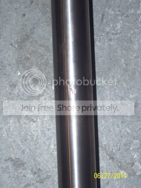

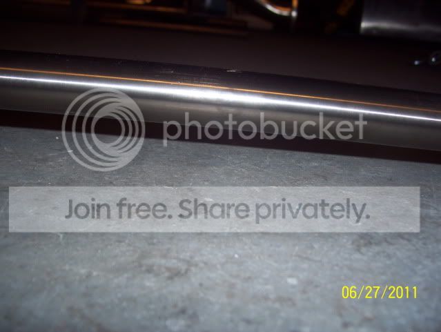

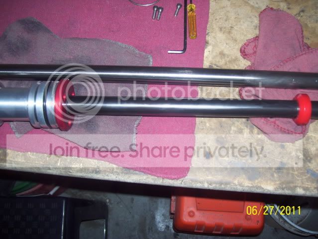

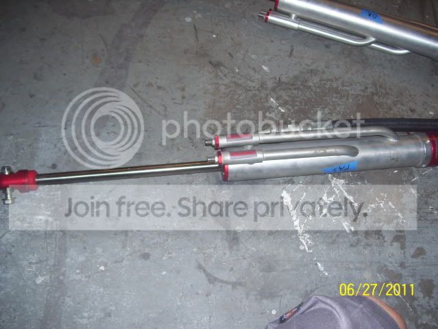

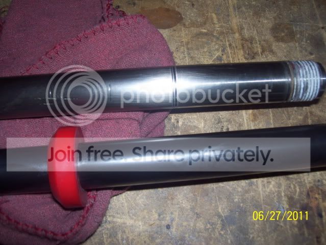

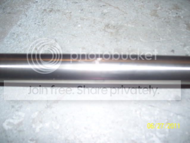

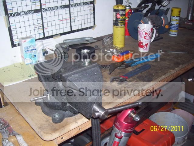

As we wait for the new bellhousing to get here we are tying up little things that we can finish. One thing we had been putting off was fixing all our NEW shocks, two needed new aluminum ring seals in the resi (this was a manufacturing issue). When we refilled the oil of one of those we found another shaft damage that would have to be replaced. I had found a rear coilover shaft damage last year when we order the 2" ends to replace the previous 1" the first shop put on without soft jaws. We replaced that shaft, its actually the new shaft the sway a ways come in. So I need to order another shaft to fix the one bypass and we need to put the 2" long ends we got for the rear bypasses on. It really upsets me the amount of money I paid for these new shocks and the condition they are in with never being ran. I was considering letting things go with the previous work but now its not just fabwork... it is brand new parts that I paid for and entrusted him with. You really have to be careful in this industry, live and learn.
the new damage shaft

fixed coilover shaft

the seals we had to replace

well this confirms everything I have heard about SAWS
if you are hinting at bad things... these things beside a bad batch of rings cut at machine which SAW took care of and priority ship the new rings to me, all the other problems were the negligence of a so called shop... the tops and bottoms of all my shocks are gouged because of the poor craftsmanship in the old shock mounts... our new mounts front and rear we did come no were near the bodies of the shocks. Just really upsets me having 10K in shocks looking used, makes me wonder if he didn't switch out my shocks. I know they will not stay new, but i never even got to see them new and having to buy all these parts to fix issues he caused.
However SAW has been awesome and they will right there with us helping us tune the shocks.
