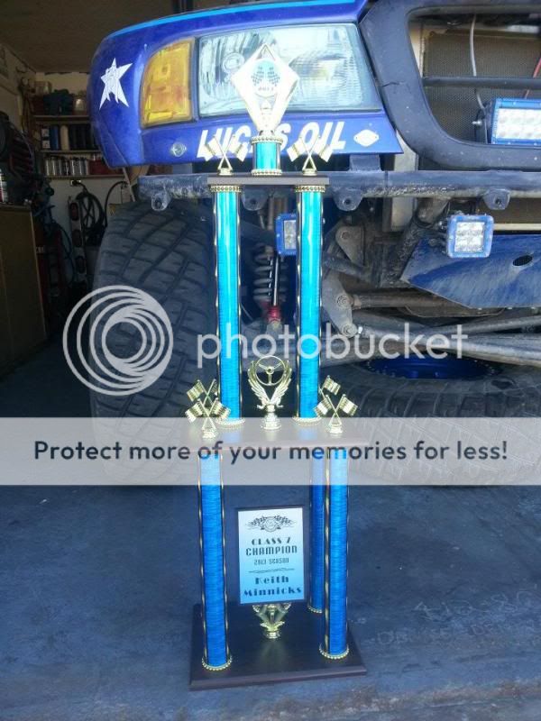

:headbang: Awesome stuff dude! Congrats on winning the race! and with it being the first of the season it defintely puts a bullseye on your back! from the other competors. hope you can keep it up! :beer:
Indeed, congratulations!!!! A lot of hard work pays off!

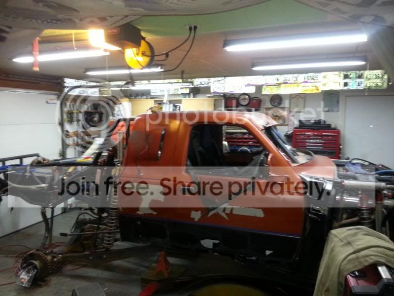

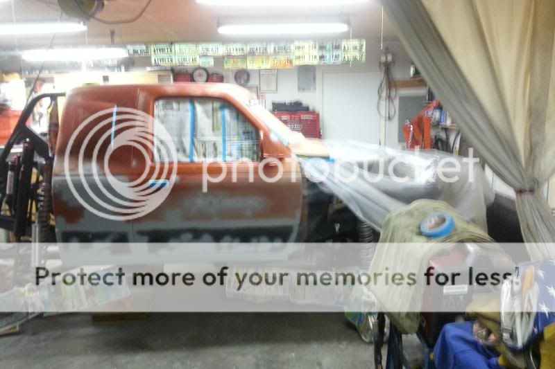

December last year we began tearing the truck completely down to make some changes.
FAST Fabrication 94 b4000 turn into SNORE class 7 race truck build thread

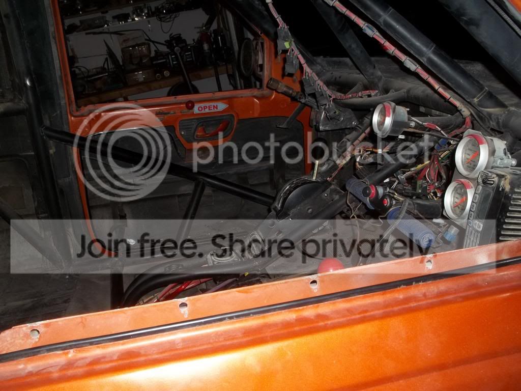

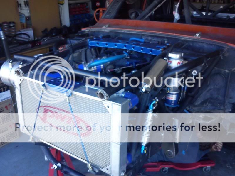

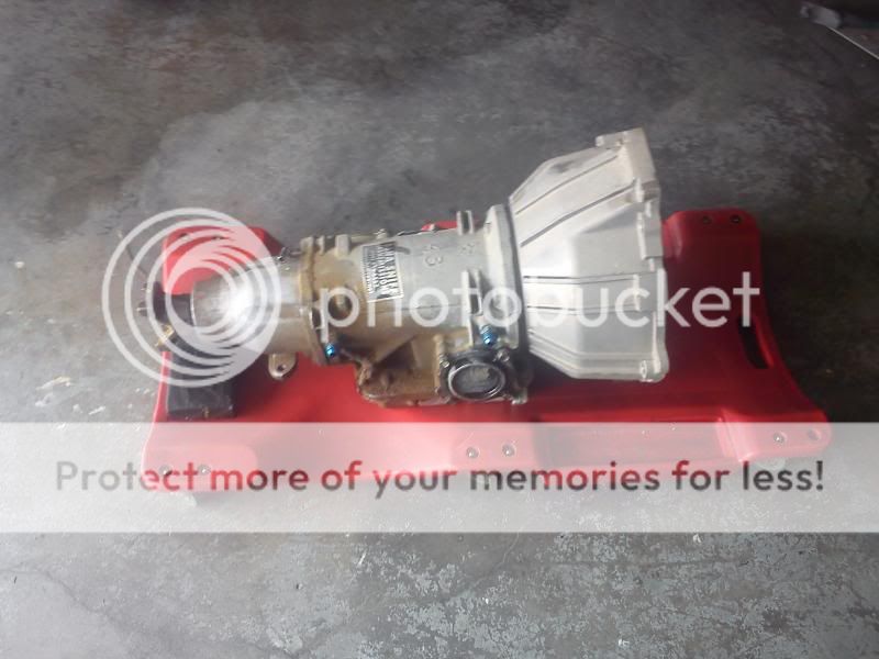

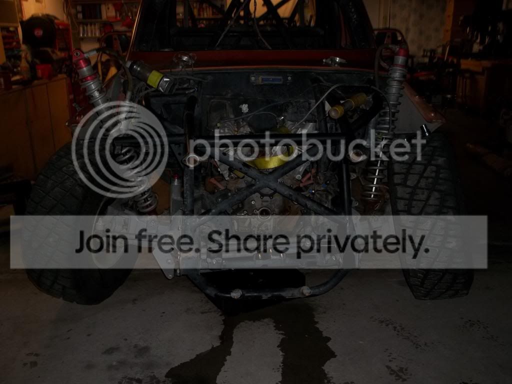

We pulled our motor, come to find out it only had two good cylinders, and one was toast. Picked up a new motor out of a mustang with only 18k on it.

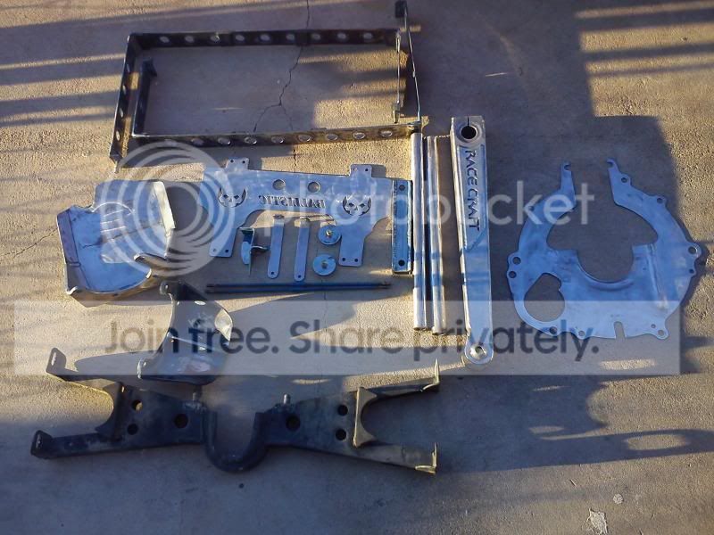

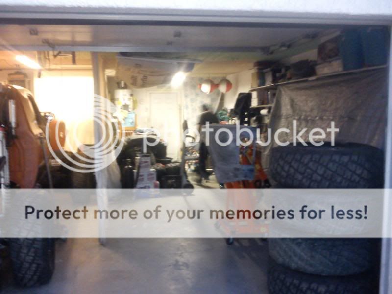

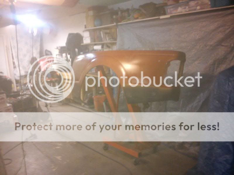

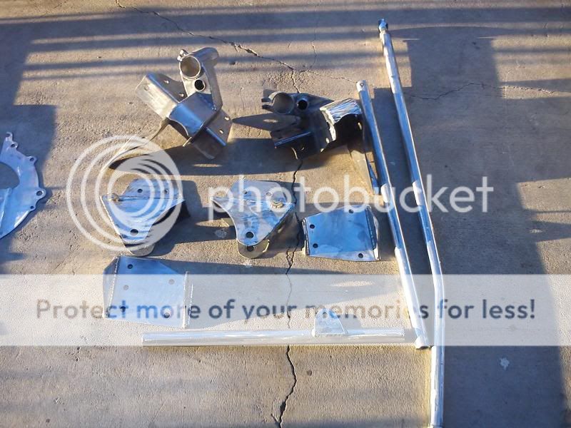

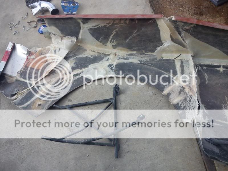

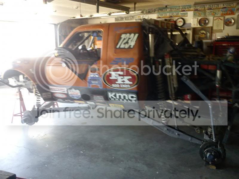

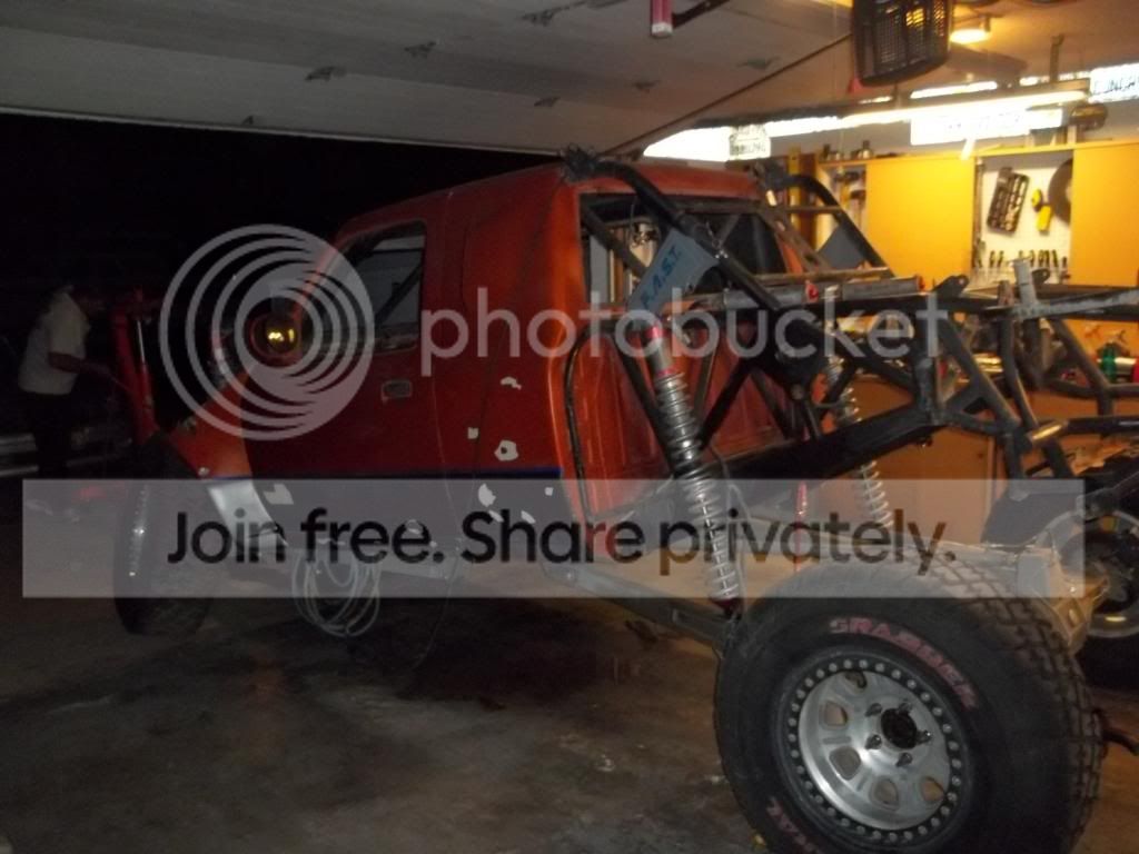

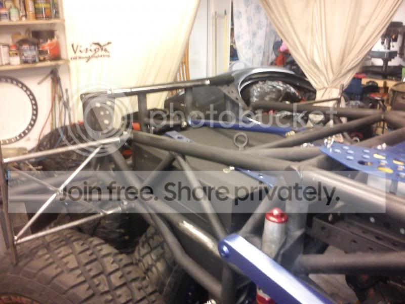

Began cutting stuff off to make changes and fix issues on the truck. Cut the rear dual spare mounts off.

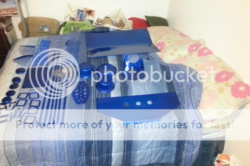

Pulled every part off and cleaned, painted before going back on. Will be doing this again in next few months but this time powder coat that matches paint job of truck.
FAST Fabrication 94 b4000 turn into SNORE class 7 race truck build thread FAST Fabrication 94 b4000 turn into SNORE class 7 race truck build thread

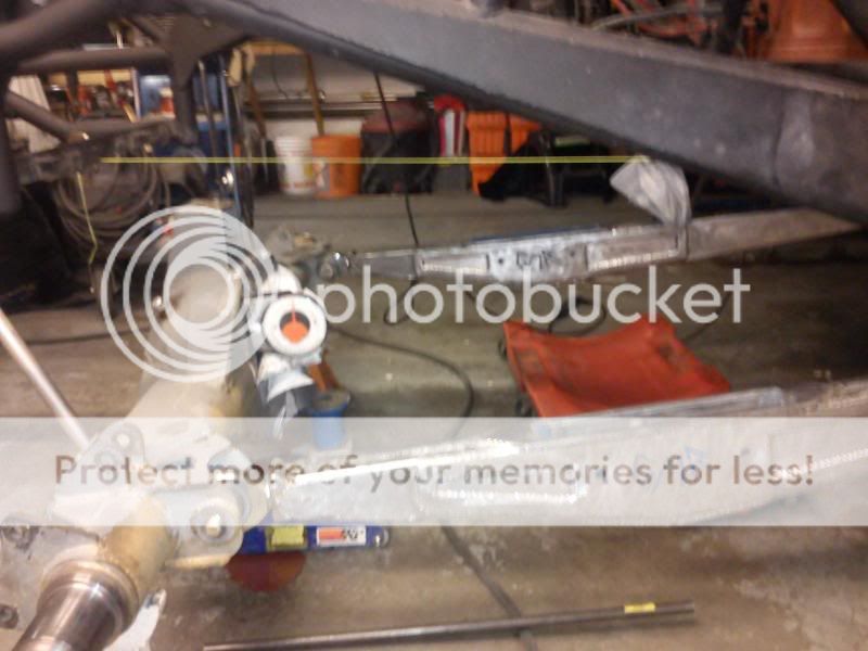

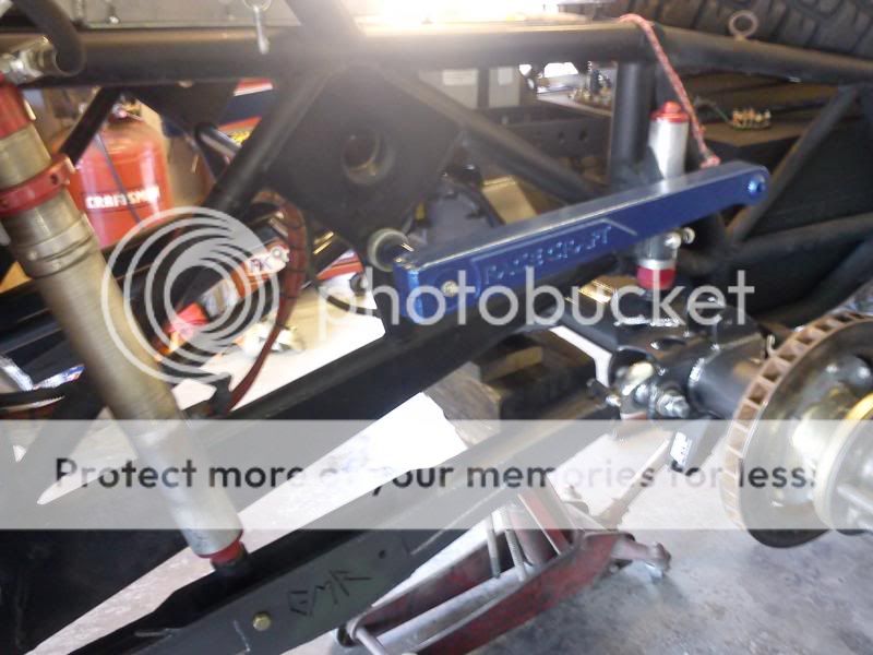

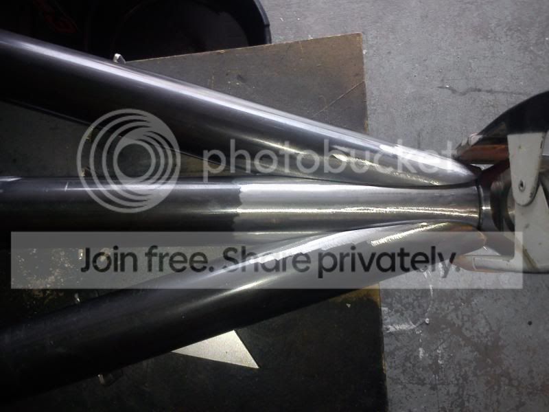

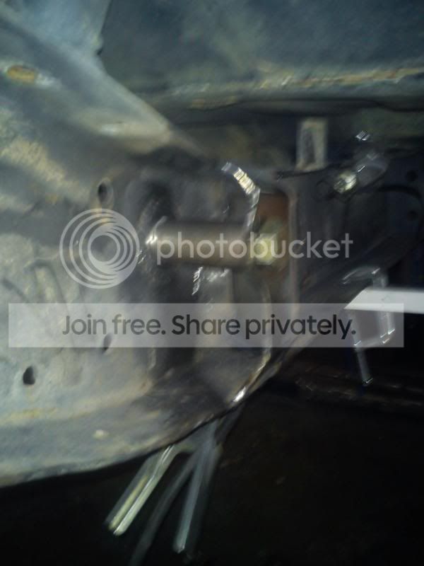

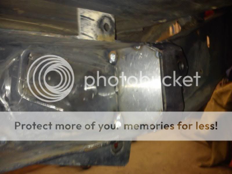

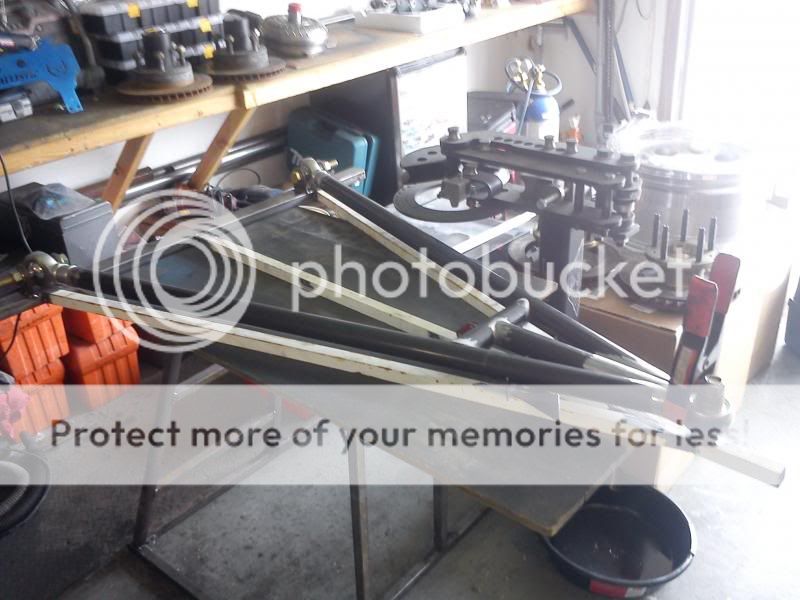

Cut off the upper wishbone mounts off, and one of the lower GMR mounts. Got a centerline and put the rear end at the wheel base we wanted. Welded the GMR mount back on so it was in the same place on both sides. This was to fix all the rear suspension issues we had last year (curved coils, bent wishbone, snap spacers) and finally the broken upper mount ear on the first race of the second day. That was the end of our 6 race 2013 season.

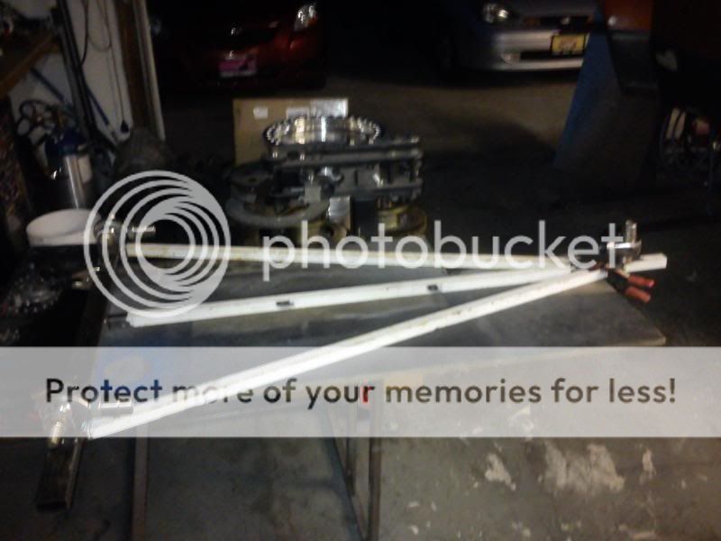

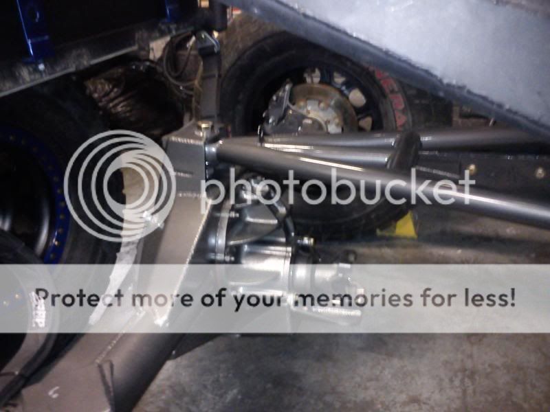

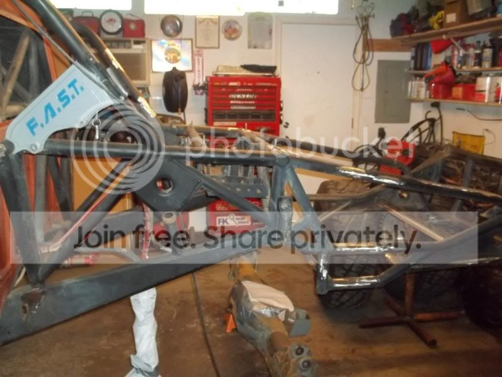

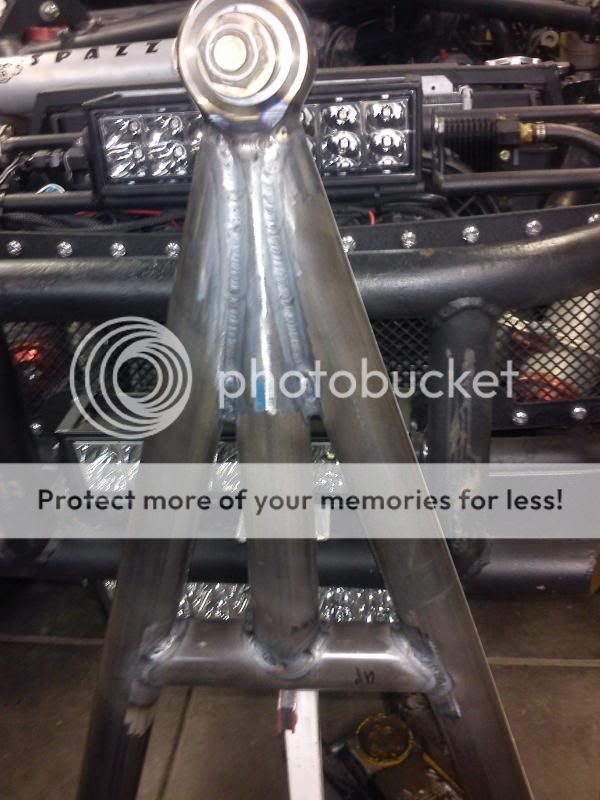

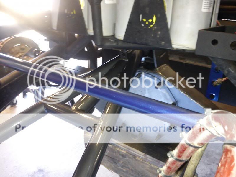

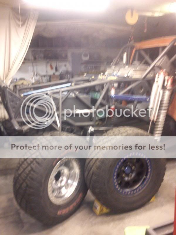

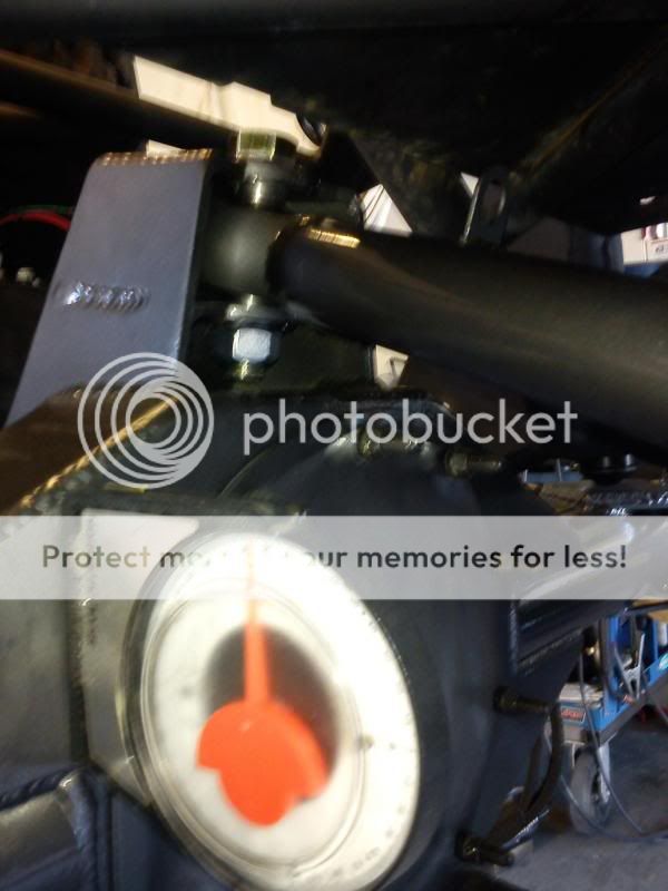

Began making our new upper wishbone and mounts and setting up the geometry on the rear suspension. Used 4130 plate and tube for everything. Built a jig for the wishbone, used the new armada unibal bung, and tig welded the wishbone.

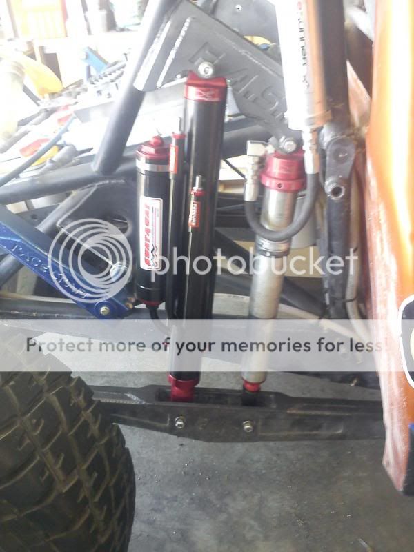

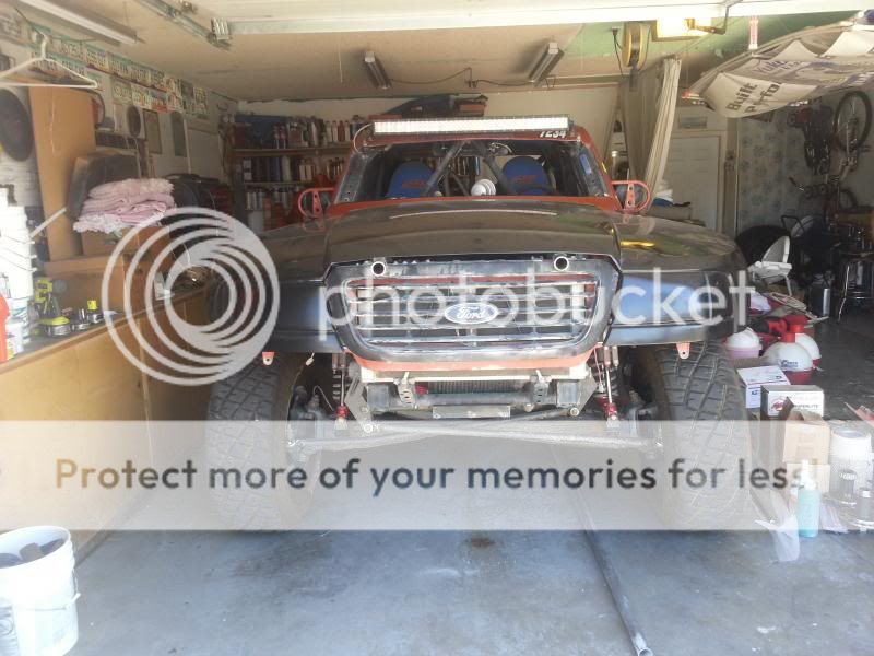

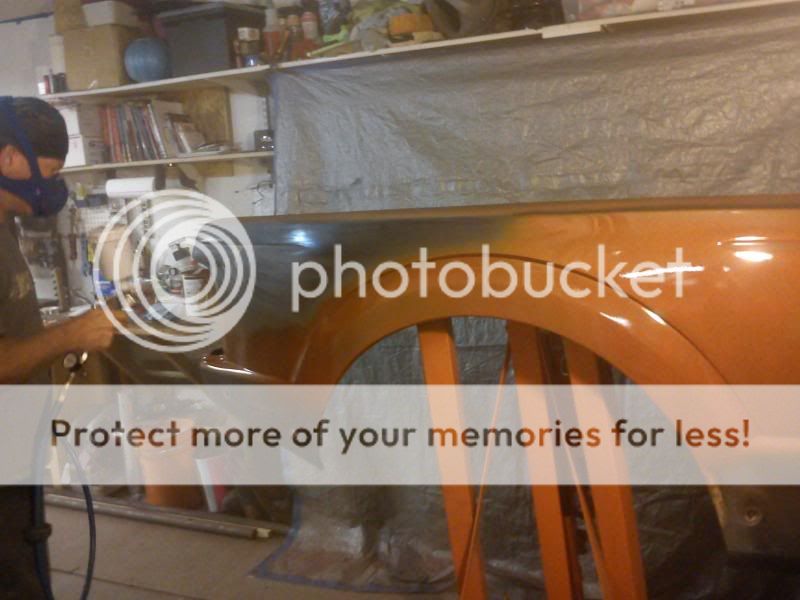

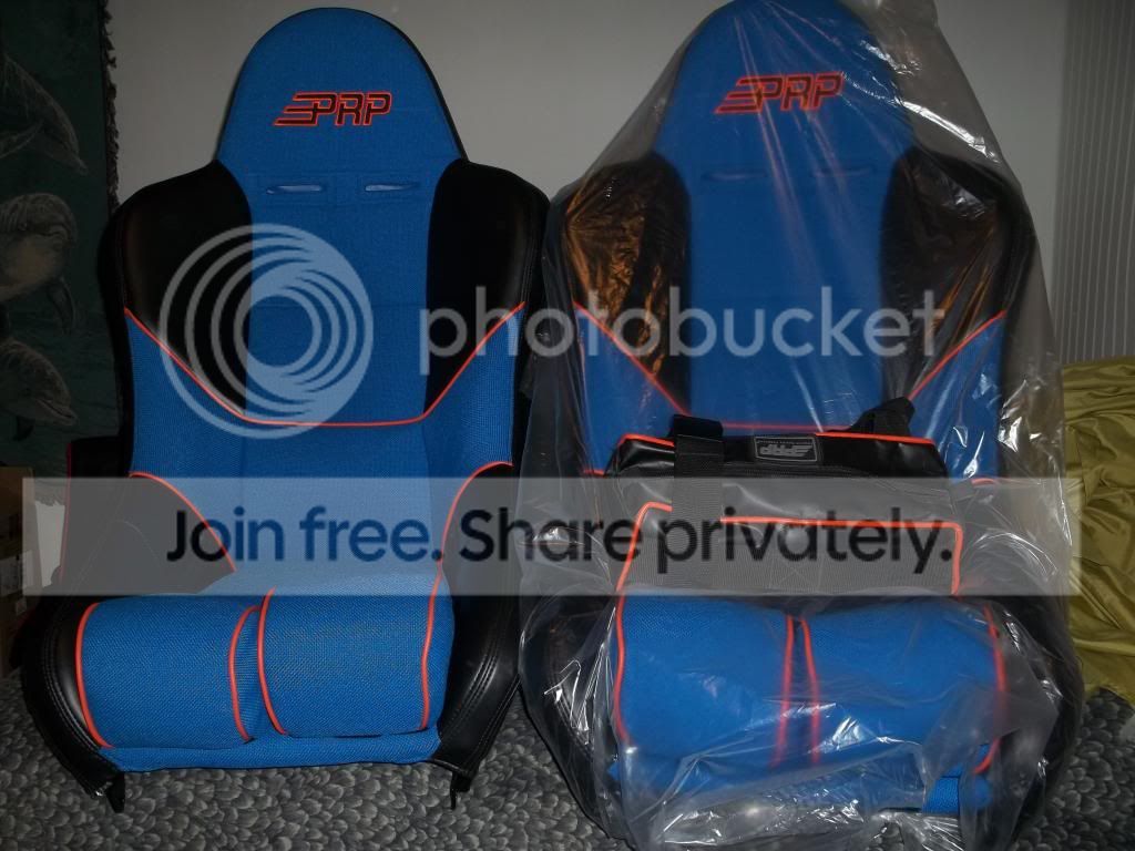

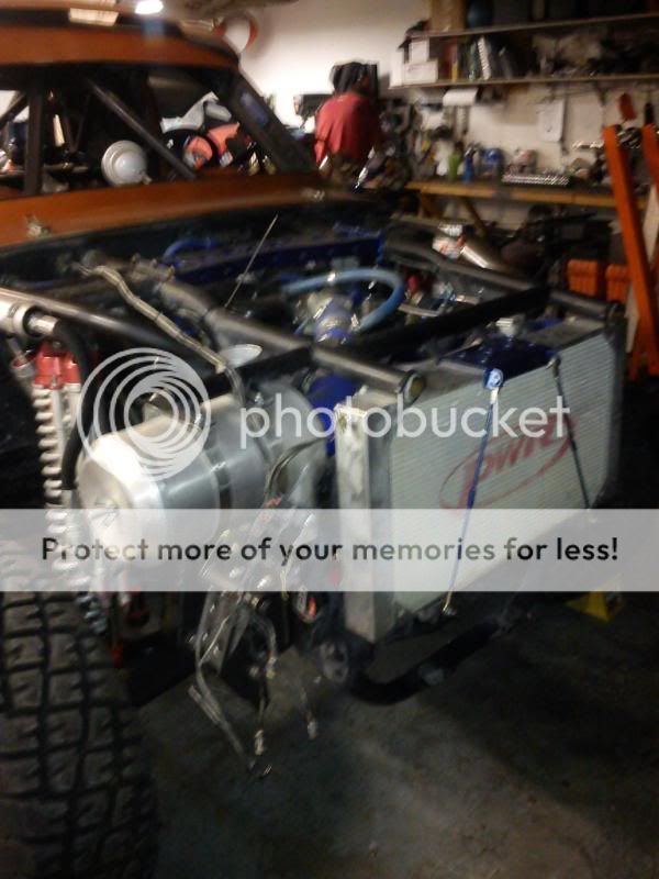

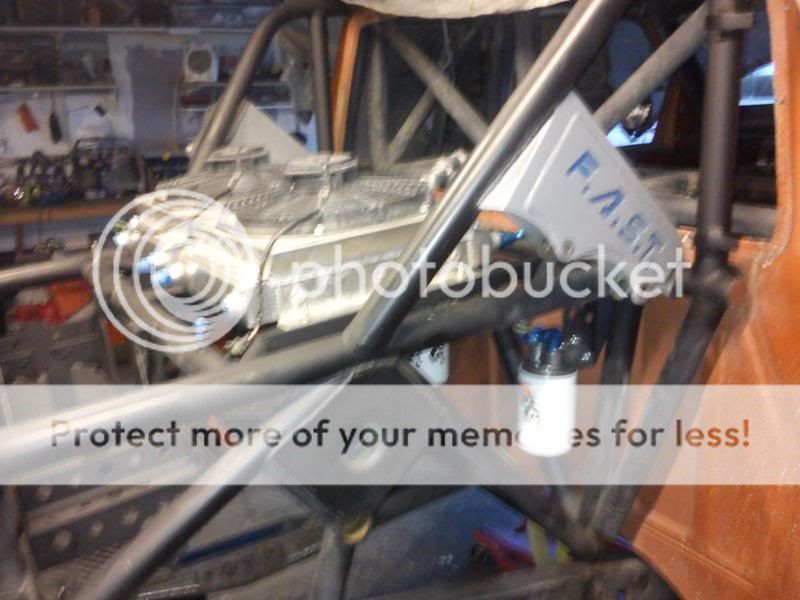

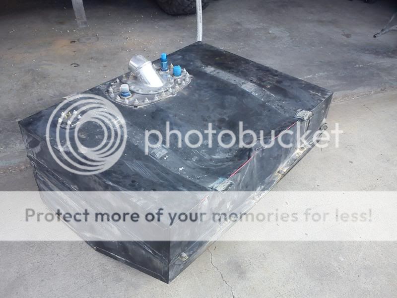

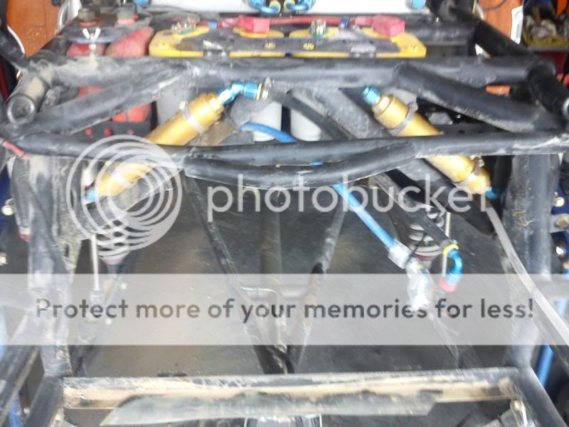

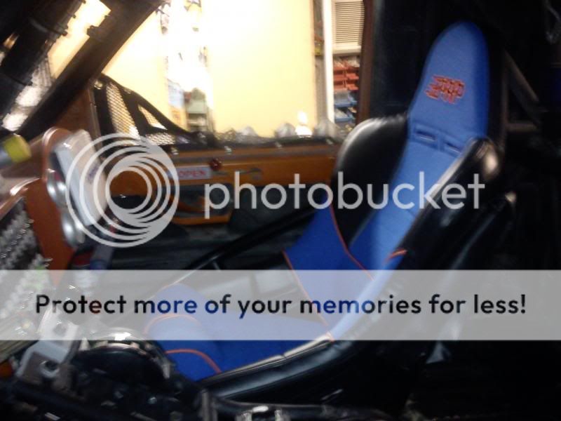

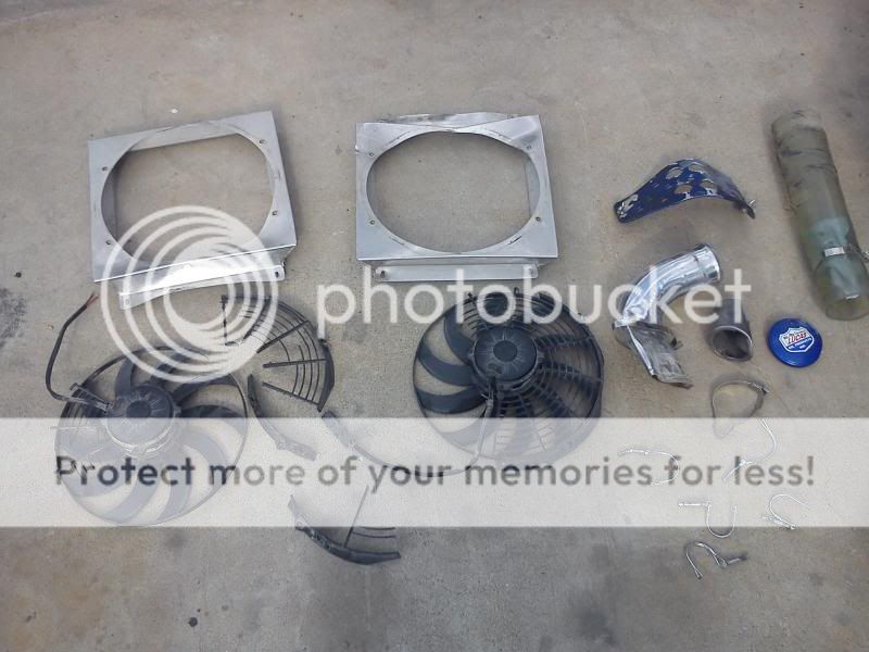

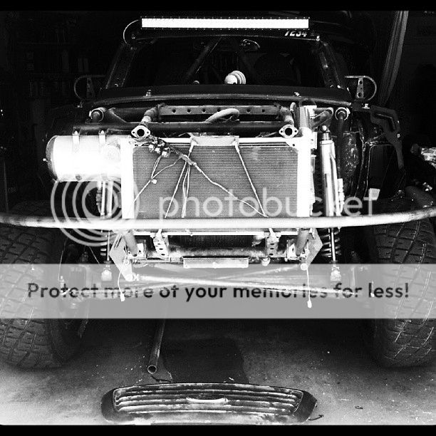

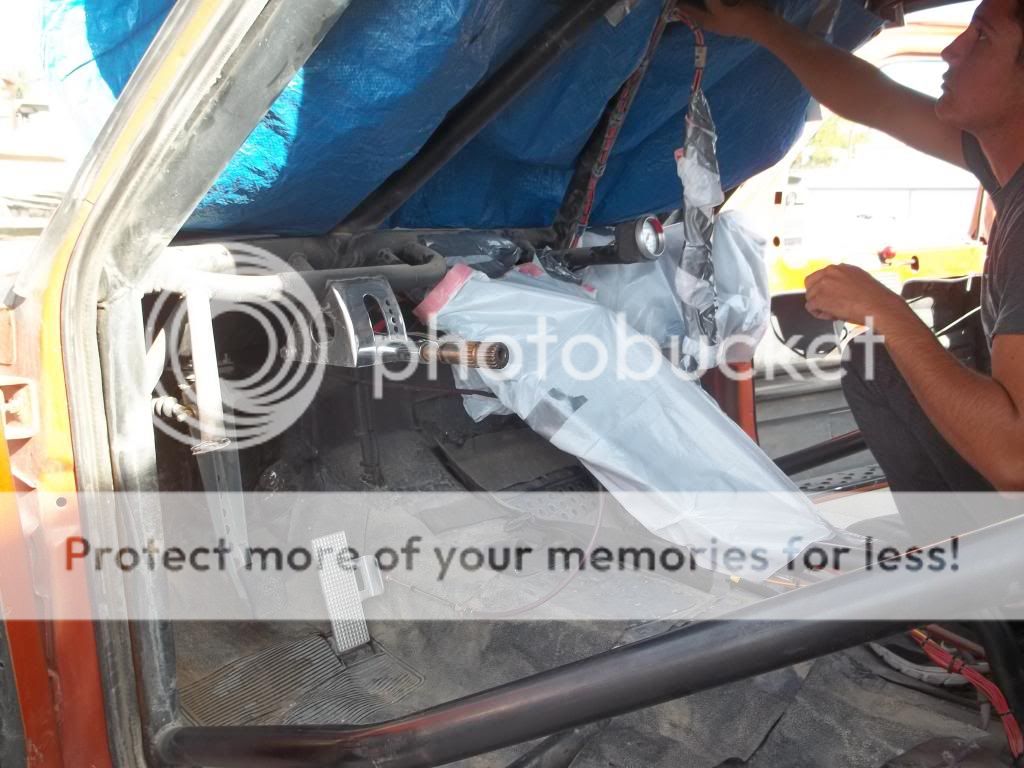

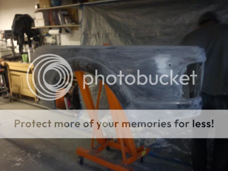

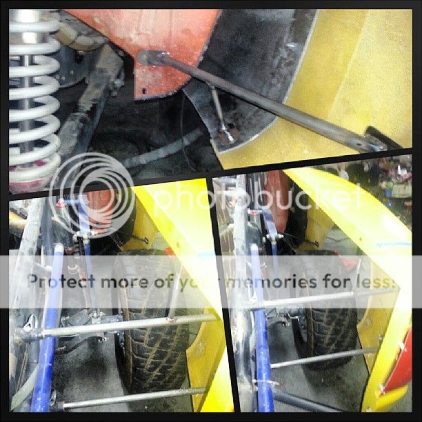

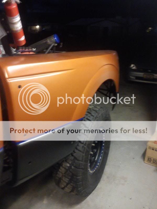

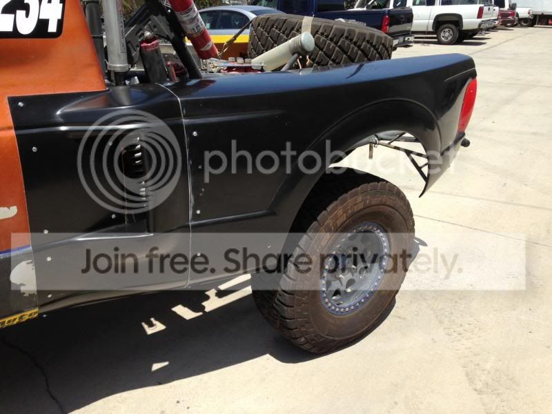

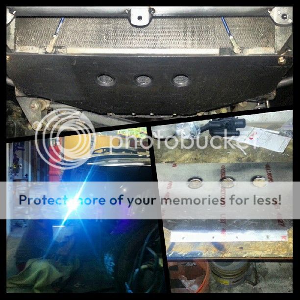

Other changes we made, before putting the truck back together. Like lowering the rear coolers to see out of back window.
Single spare mount, lighter removable bedside mounts (prevent stabbing and jabs in head and back while working on truck)

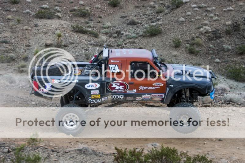

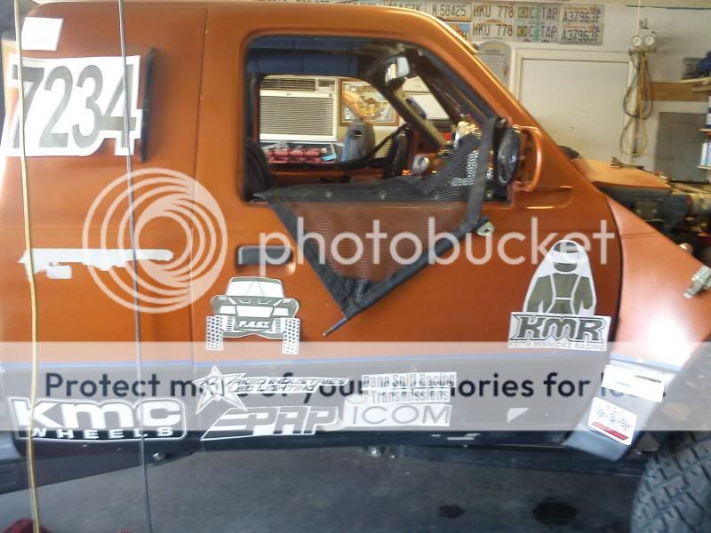

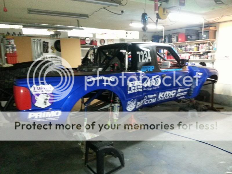

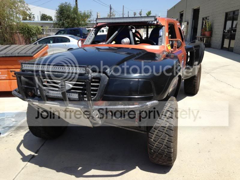

Reinstalling to make the first race of our SNORE class 7 season the Battle At Primm
FAST Fabrication 94 b4000 turn into SNORE class 7 race truck build thread FAST Fabrication 94 b4000 turn into SNORE class 7 race truck build thread FAST Fabrication 94 b4000 turn into SNORE class 7 race truck build thread

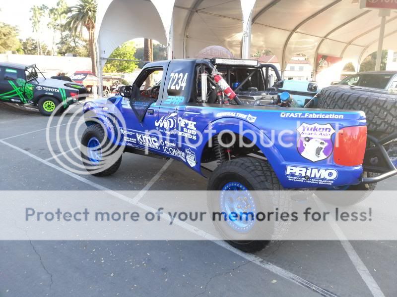

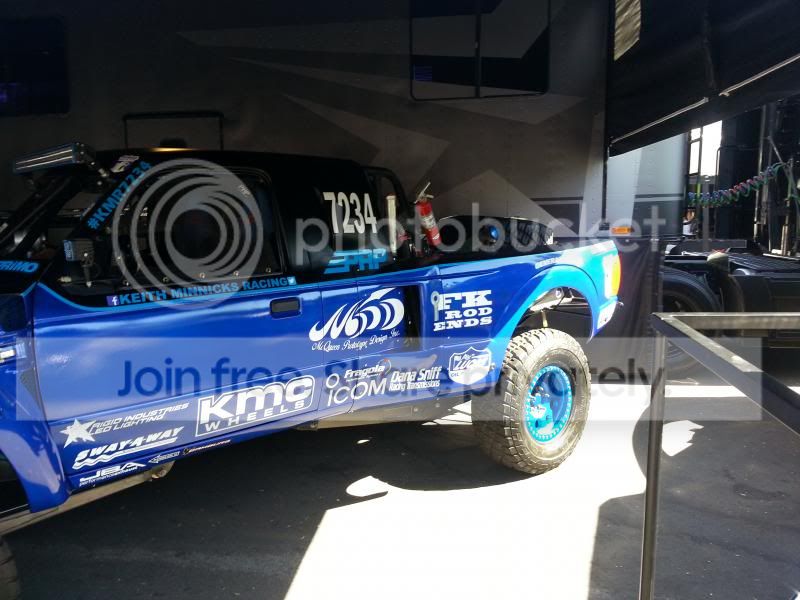

Some of our new sponsors for 2013, were KMC, Lucas Oil, Primo Powder Coating, and McQueen Prototype Glass, truck looks great.

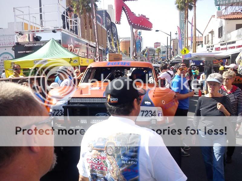

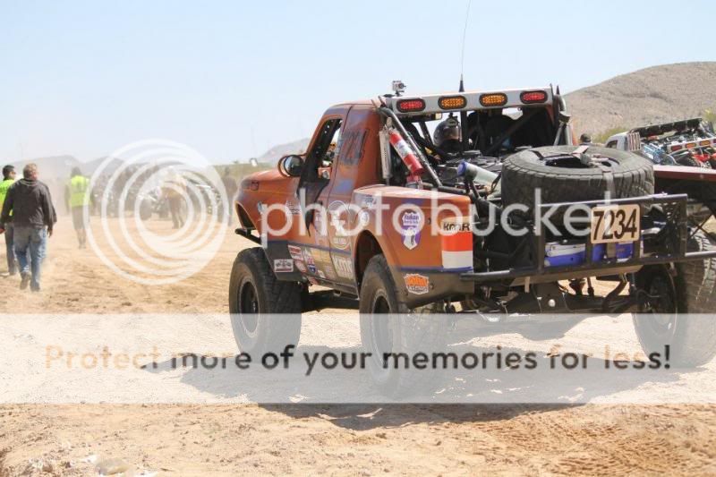

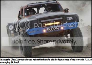

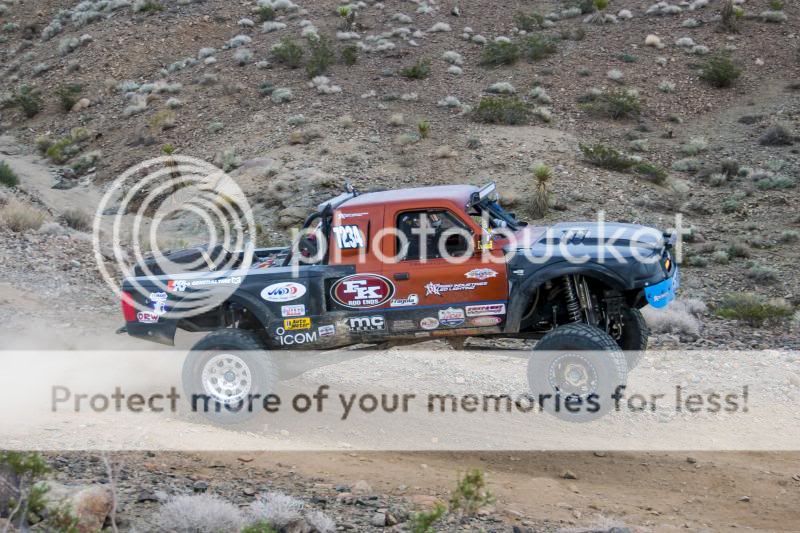

We worked 14+ hour days the week of BAP, we didnt make it to the Primm until 30 minutes after tech had closed. Nearly did not pass tech due to a failed brake pressure switch. Photos and video next.
2013 SNORE Battle At Primm class 7 first place

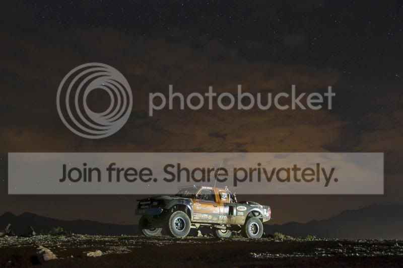

Returning from Battle At Primm, with our first place win in class 7!

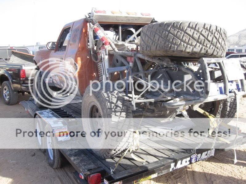

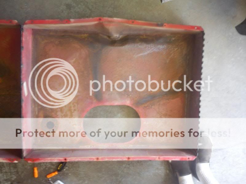

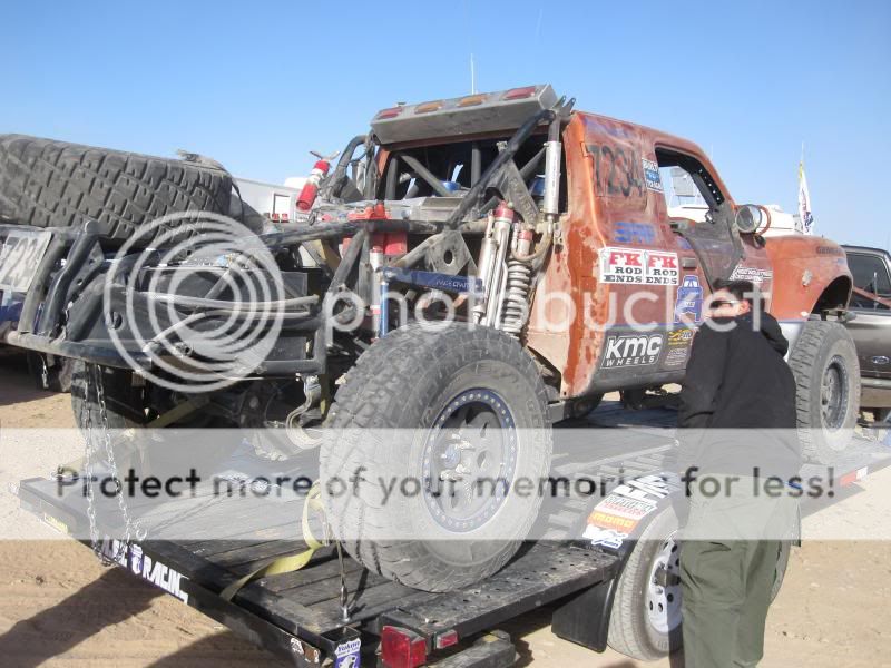

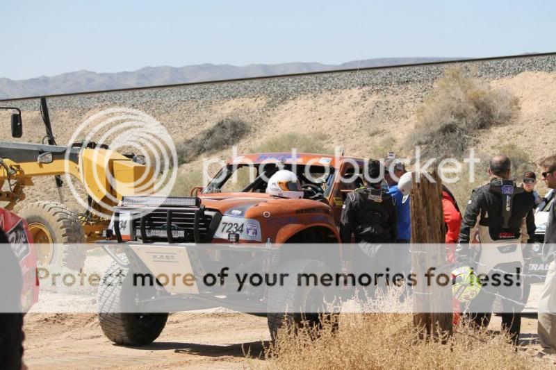

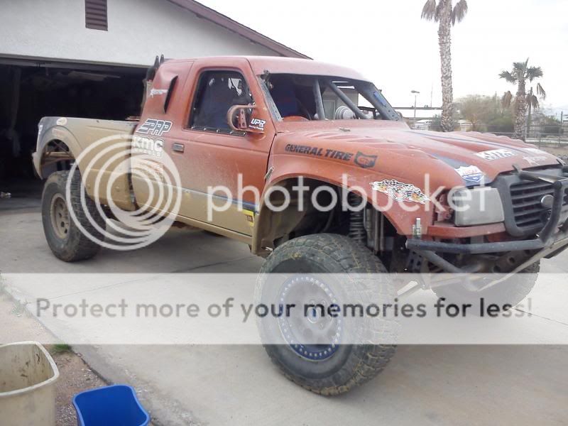

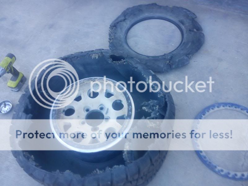

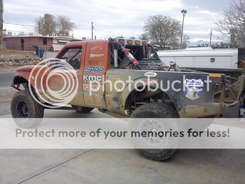

Damage-

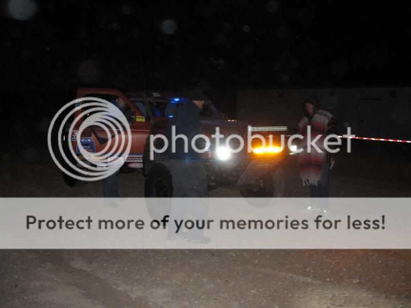

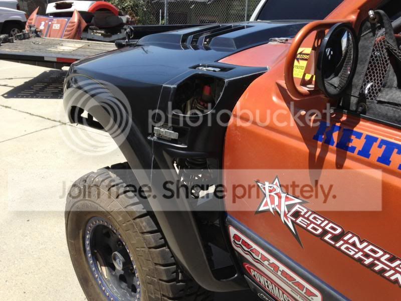

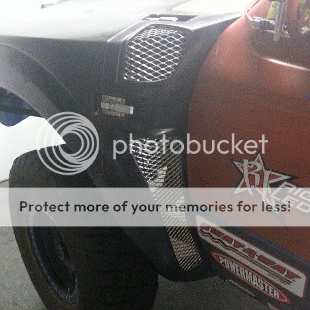

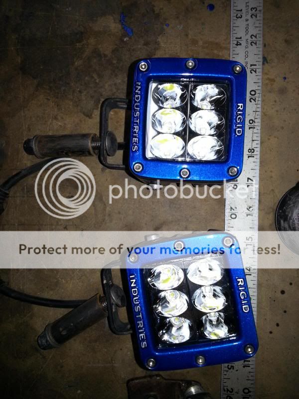

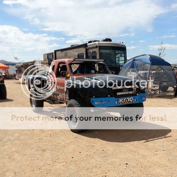

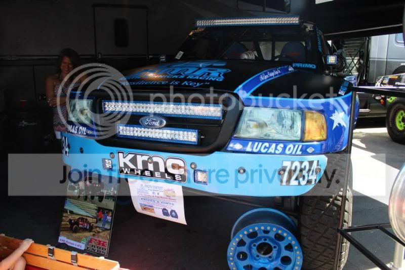

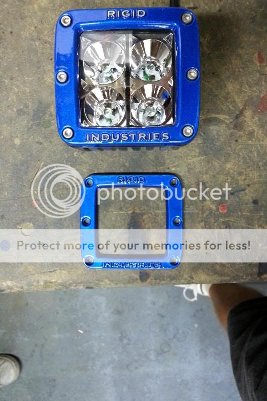

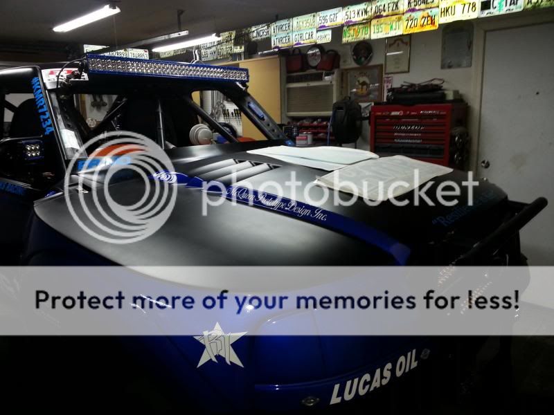

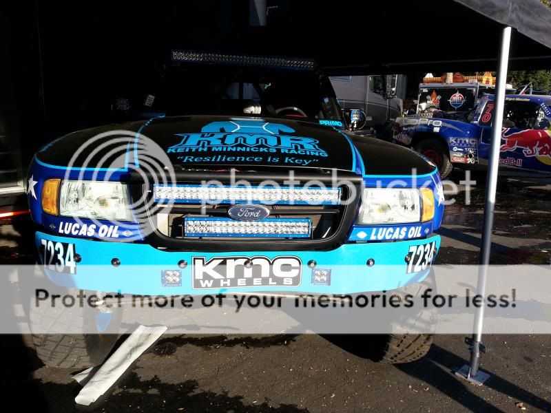

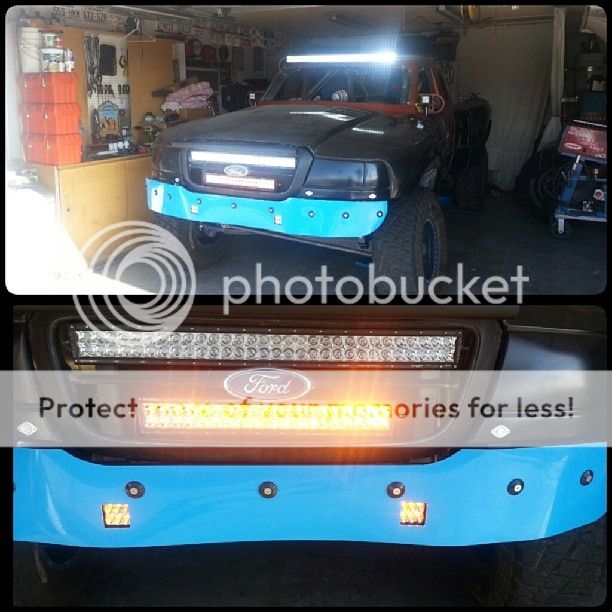

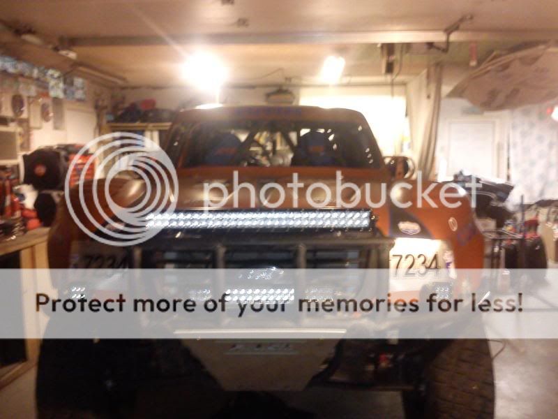

Our new lights from our newest sponsor Rigid Industries, and our headlight/taillight removal plates

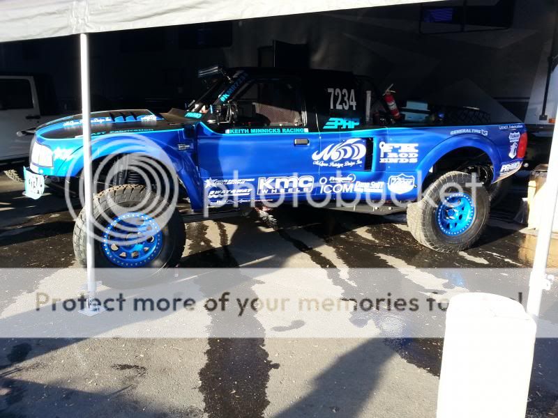

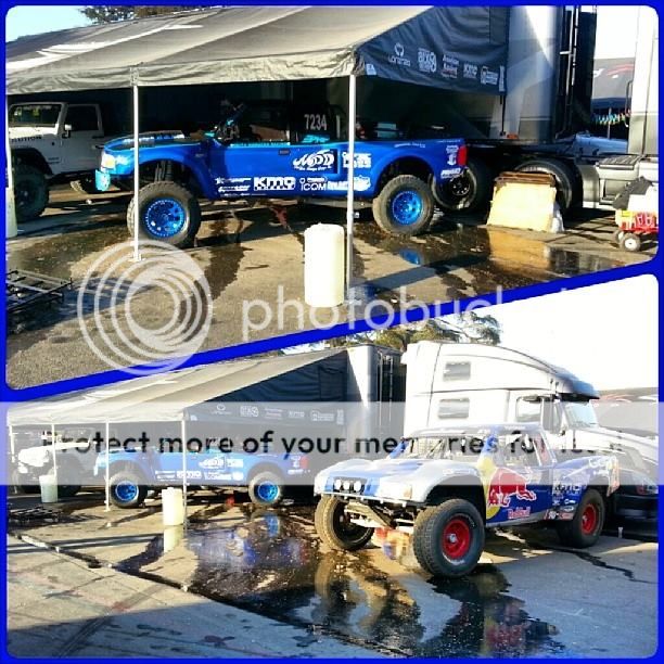

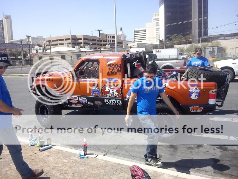

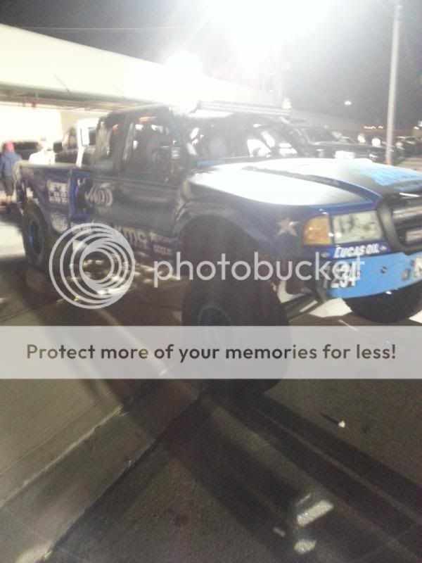

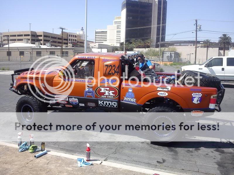

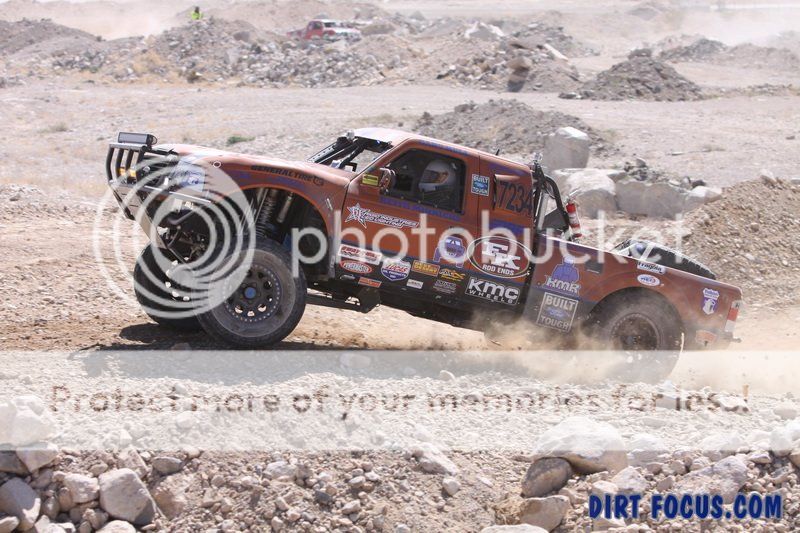

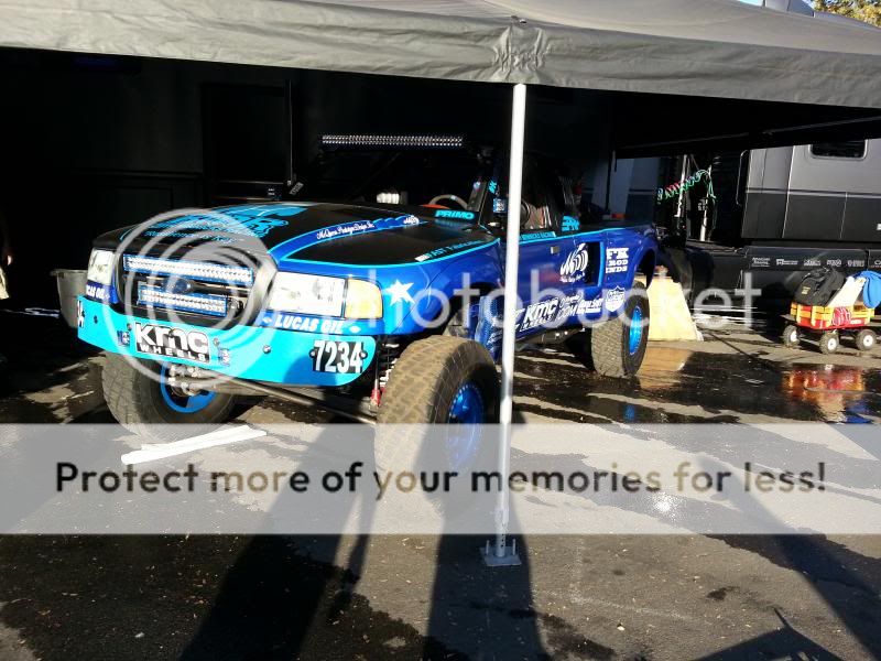

At tech of SNORE Motion Tire 300

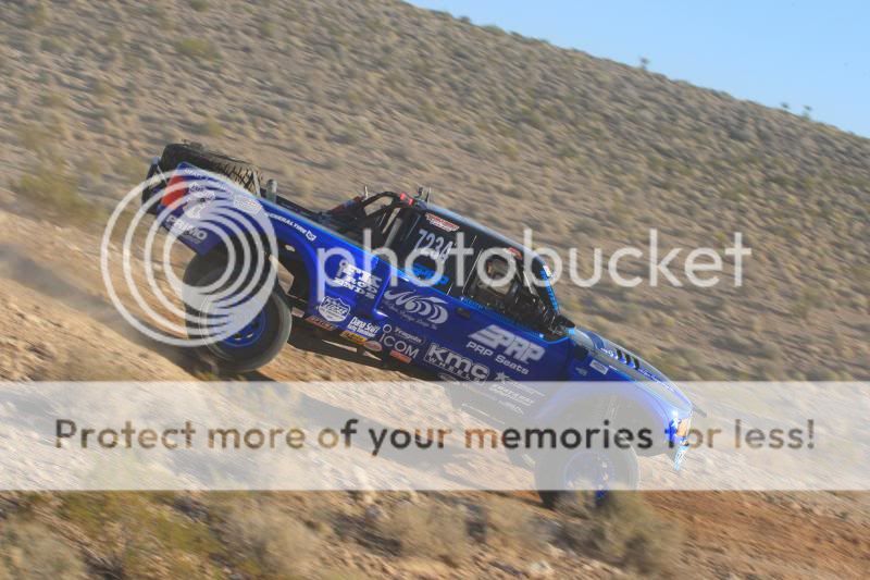

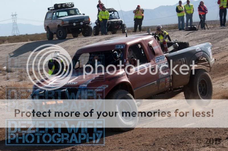

2013 SNORE Motion Tire 300 were we finished in second place and held our points lead in the 2013 SNORE class 7 championship.

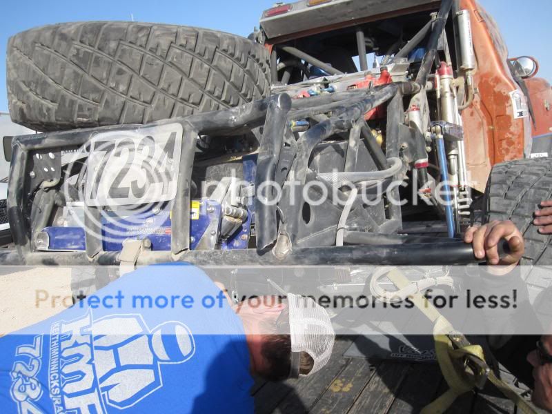

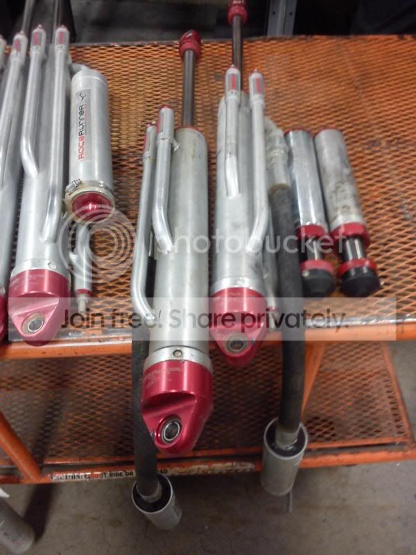

After Motion Tire 300 in Ridgecrest, KMR sent their shocks off to be rebuilt. At the same time ordering a new set of 3.0x18 5 tube Sway-A-Way bypasses to replace the 2.5s in the rear. The 3.0 shocks were quite a bit bigger and needed a new shock mount to get full potential. For now we moved the mounting hole up quite a bit and flipped the shocks for clearance. We have plans for an entire new rear cage at end of season.

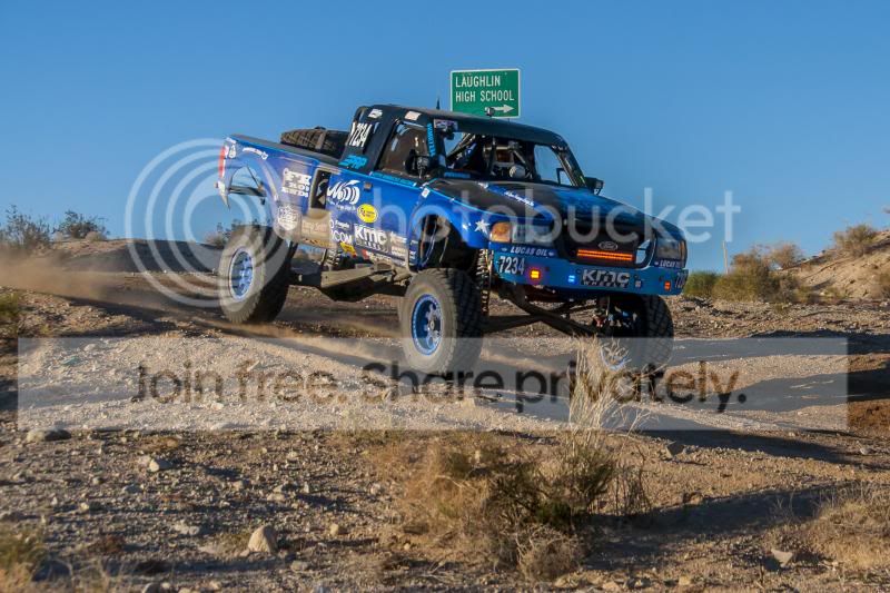

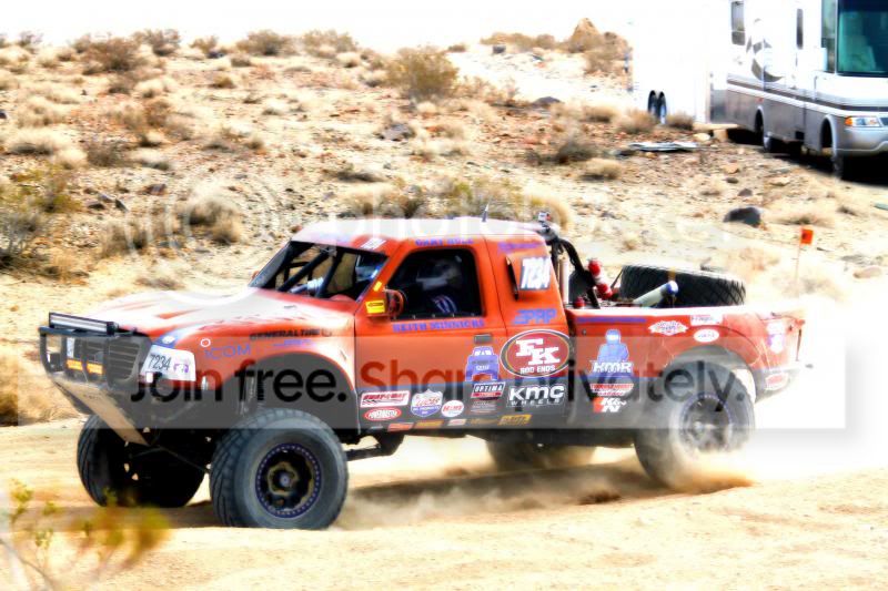

Next on the list was the SNORE KC HiLite 250 in Jean, NV. A night race, started and ended in the dark. Even though we were plagued with flats on course and getting stuck behind broken vehicles in the canyon we came out with the win. Our new rigid lights worked great. We had a 40" roof bar and our 30" spot on bumper and 20" combo amber on the bumper. We also had some D2s.

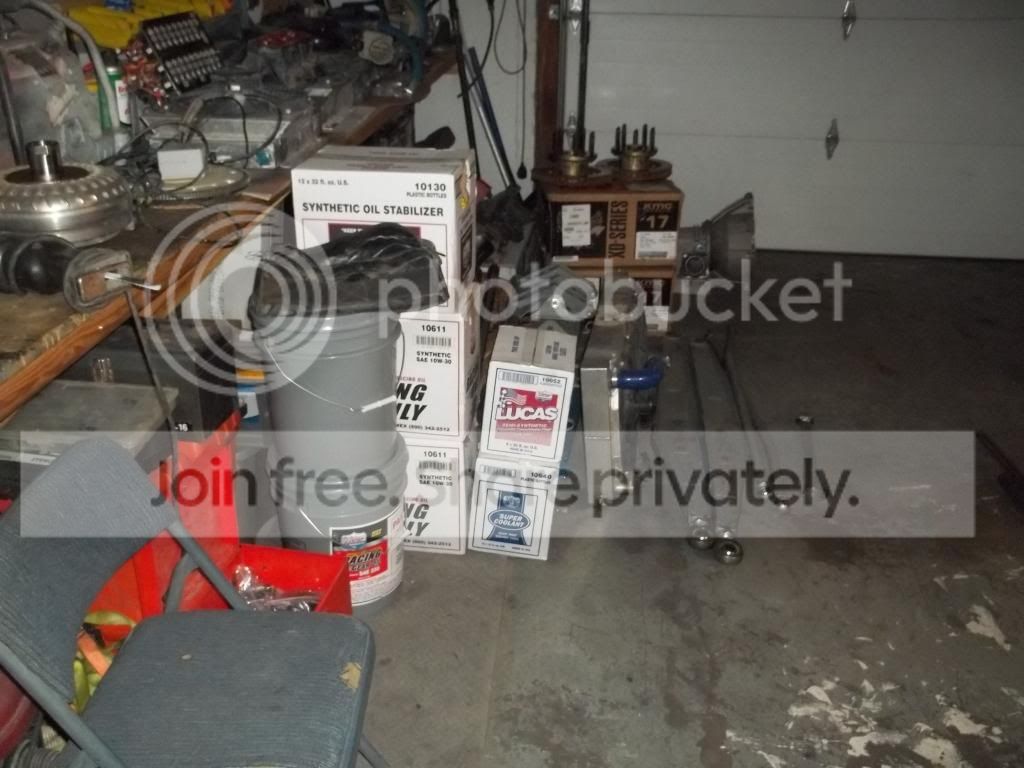

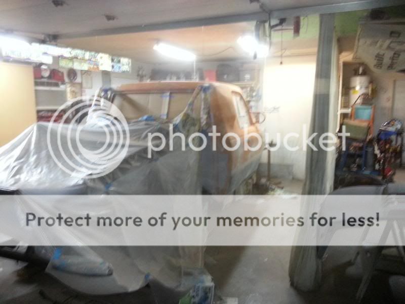

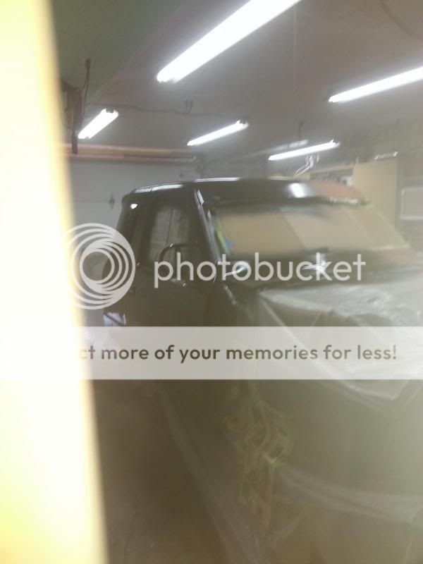

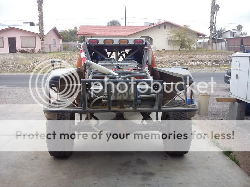

The day we got it back home, we unloaded everything and cleaned the truck. Loaded just the truck back up on the trailer and towed it out to McQueen Prototype Designs in Los Angeles area. For the next month and a half he developed one of the best race clip and bedsides to come out for the ford rangers. Not only does it look sweet but it is functional. The front clip (not conversions just inspirations from raptor and f150 accents) fits the 85" wide trucks, qtr fenders allow air to escape, clean lines and no gaps. Mounting locations are factory based, no extra metal holds on the qtr fenders. The bedside set up uses McQueens raptor inspired bedsides with the front cut off. A new piece attaches to your cab allowing for wheel base adjustment so your tire is always centered and it cools your rear shocks. As usual clean lines and no gaps. With his mounting set up we saved lots of weight and only used a small tube from the cab to front bottom wheel well corner. The rear bedsides did not budge one bit after the Midnight Special race, even with mud getting caked on. McQueen has built a sweet race kit for the rangers. As always he offers colored gel coat.

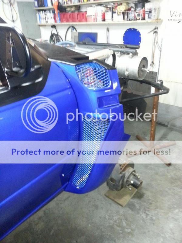

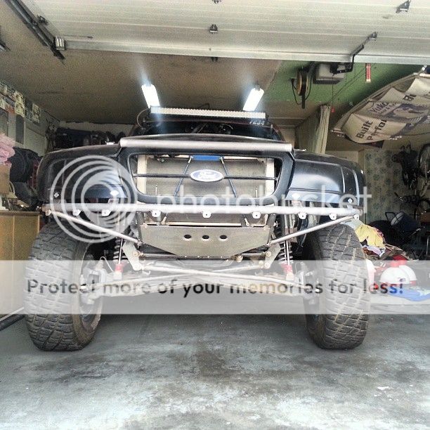

Next thing was to get glass mounted, new front bumper and light mounts, and race prep before the 2013 SNORE & MORE Midnight Special. By the time we got the truck back we had about 3 weeks. The white D2s that were on the bumper were moved to in front of our mirrors (shined above hood but on outside of trail). We got a pair of amber D2s and mounted them on the bottom of the bumper. A pair of blue D1s were meant to go here but did not have time to make the mounts that are meant for the ambers. So we put the ambers in spot the blue lights go for the race. I could not find the original photos on my phone so I had to copy the instagram photos. In fact if you want to stay up to date with photos and videos it is better to follow me on social media (facebook, instagram, twitter, you tube) I dont post on here often.

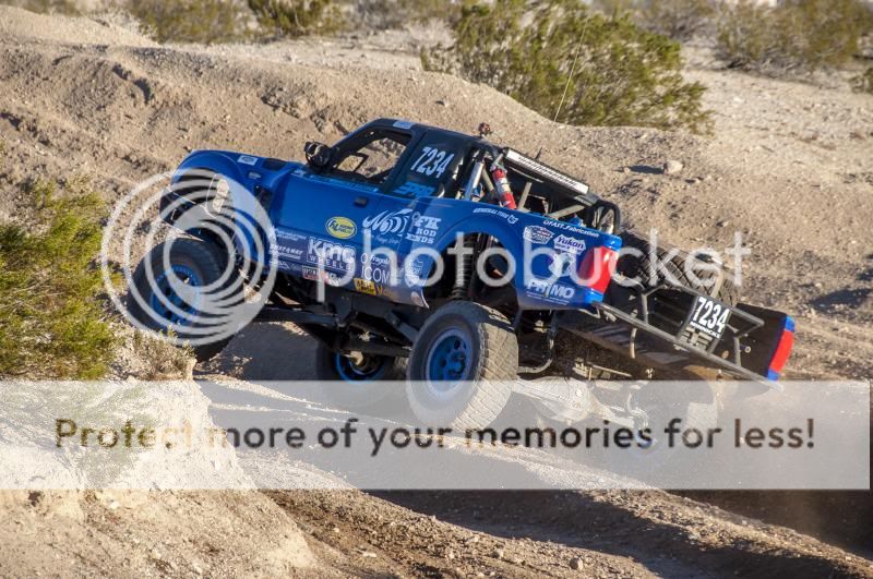

The 2013 SNORE & MORE Midnight Special was a great race and weekend for us. Last year we lost fuel pressure just 4 miles from the start finish and lost over 4 places in the 1400 class. This year my cousin who drove a lap last year and my co pilot Sean who did this race with us last year both came down. This time my dad came to this race, along with my brother and his family and other KMR crew. We had a great feast and a great time. We hired Dezertwife Photography and Phil Kaos Photography. The service for the $100 pkg from Dezertwife was amazing. Spending hours at night to do long exposure shots, a sequence shot after race day, and the race day photos. To top it all off we came home with the win beating out the other class 7's, Karakas and I had a good battle. Also had a great battle with another v6 ranger that is in 1400 class Deaknbuilt, you can see it in our video. This win locked the 2013 SNORE class 7 championship in for us and also bumped us from 10/11 overall up to 5th overall in SNORE pro classes.

couple photos from KNH photos

After that race it was tear down the truck and all the wheels the next day so I could get to CA and get parts powder coated at Primo Powder Coating and get back in a week. That left 3 weeks to sand and prep truck for an entire new paint job and graphics. In the end we finished at 11:30pm Thursday night just 4.5 hours before we had to leave to get truck to Pomona, CA for the 2013 Off-Road Expo. The only thing we did not complete was mountng a set of D2 ambers in the head light area, because the amber ones in the bumper were getting replaced with blue flashing lights.
Once we got the powder coat back we had to remount at least 5 tires for the show and put all the rigid face plates back on. These are held on by tiny screws and the nut is in a track and it slides making it very difficult. Twice we got down to the last one for it to be not lined up or moved. Very tedious.

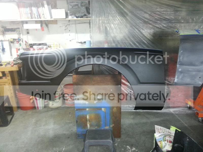

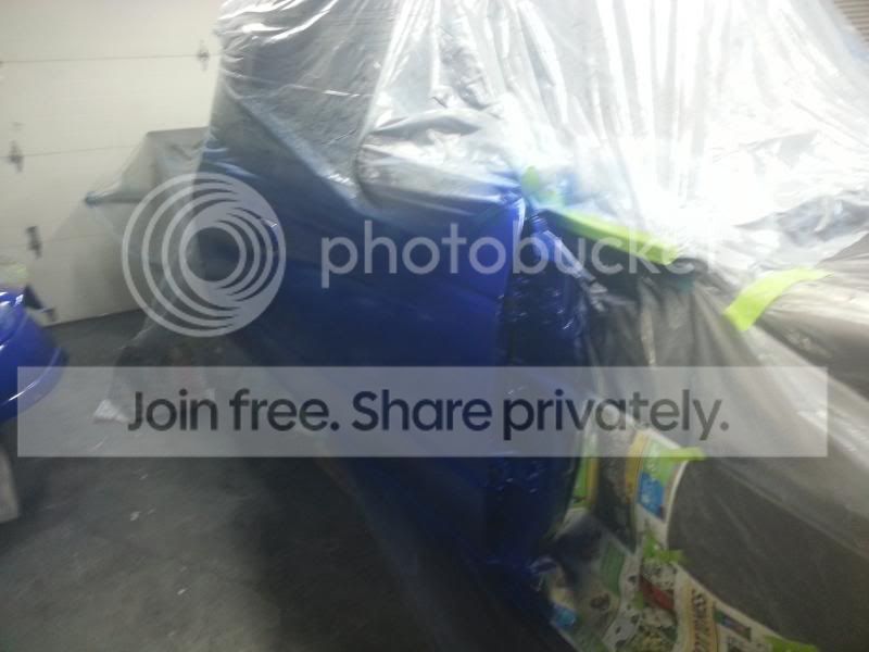

Getting the truck ready for paint is always my favorite job NOT!!!!!!!, this time was no different. Having one race on this new glass required sanding and fixing little chips and primer, etc. From now on new glass goes straight to paint. Needles to say the cab went the quickest.

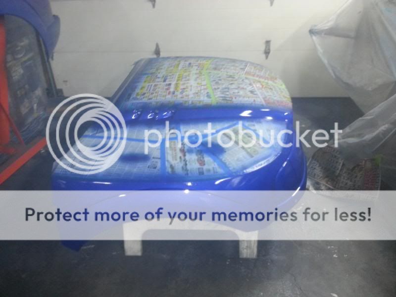

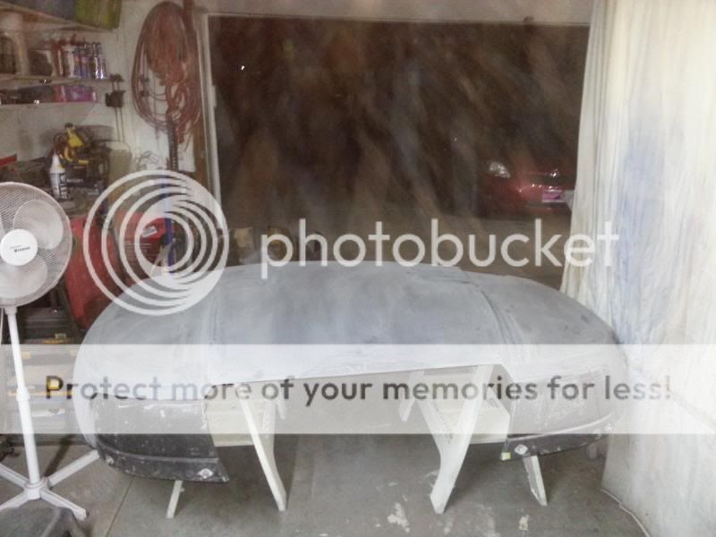

shot the hot rod black with a ghost special effects additive and then masked and shot the gloss blue with a candy special effects additive. From shade to sun truck looks totally different. I stood inside the entire time without a mask, was not fun.

the finished product on its way to the show

Finished all 5 laps behind the RJR truck on Saturday and on Sunday got two flats on Driver side in first 5-6 miles, made it to mile 9/10 and changed out. Within 5 more miles a check point person notice rear tire low at road crossing and by drop off I knew I had another flat. This one was worst, I pulled over at whoop section at first. Then decided to make it to second road cross to be picked up. Well driving those few miles destroyed rim and tore brake line. Ran out of spare tires.

class champions
