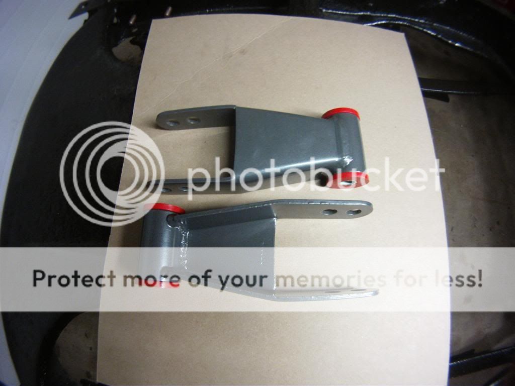

just ordered my front spindles and spacers and rear shackles from canuck. im going to call around and see if i can find a good place to order my locker, gears, and rebuild/shim kit. any suggestions from people who have ordered them in Ontario?

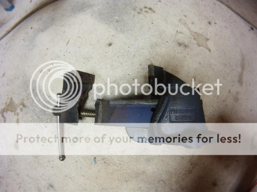

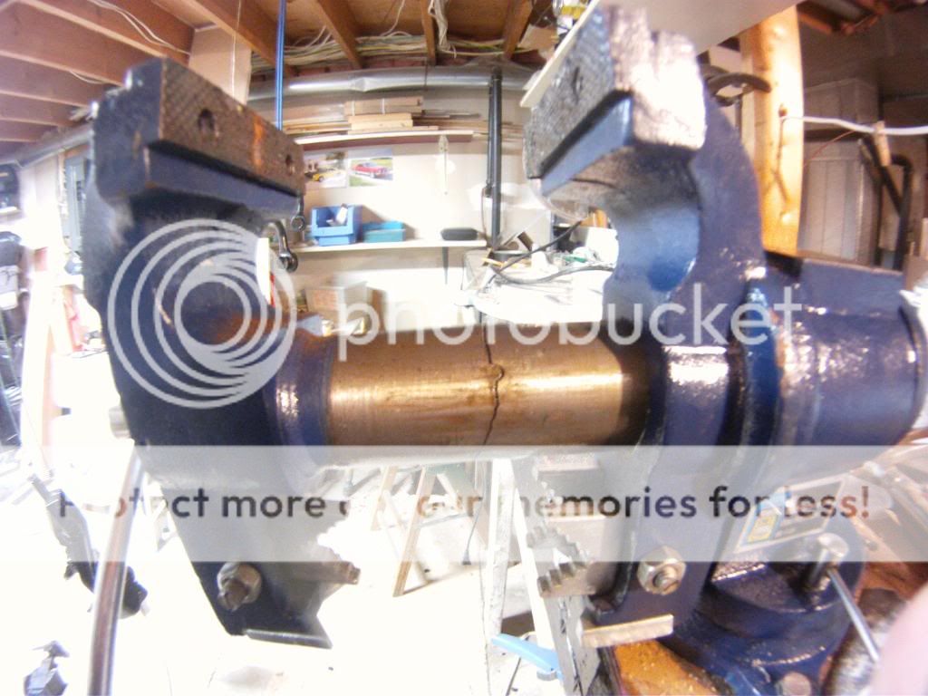

havnt had alot of luck with vise's lately. tghis is a 3" vise
this is a 4.5" vise.

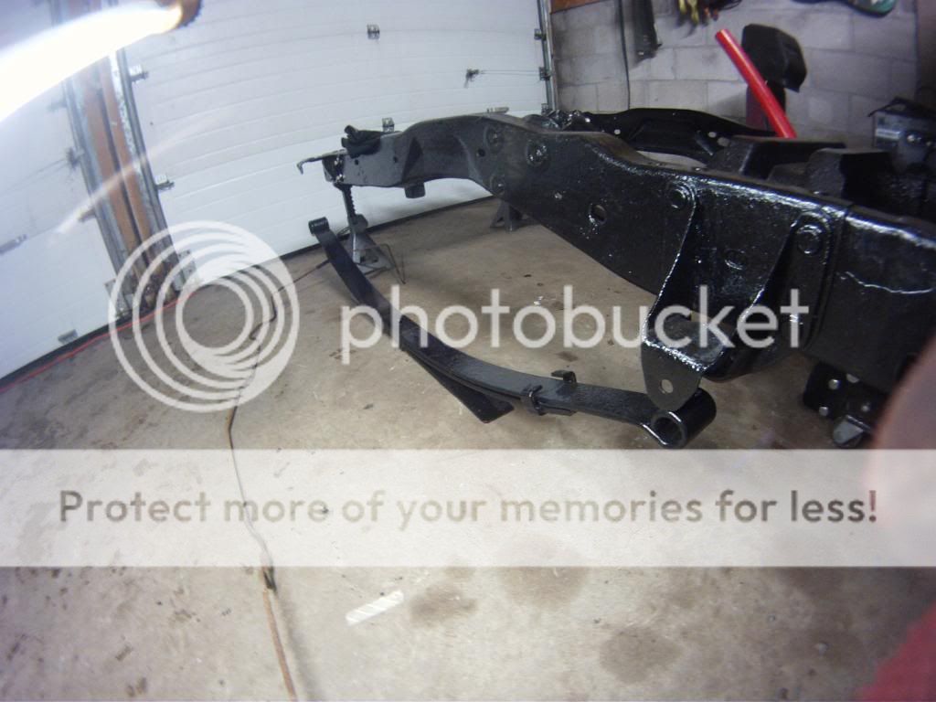

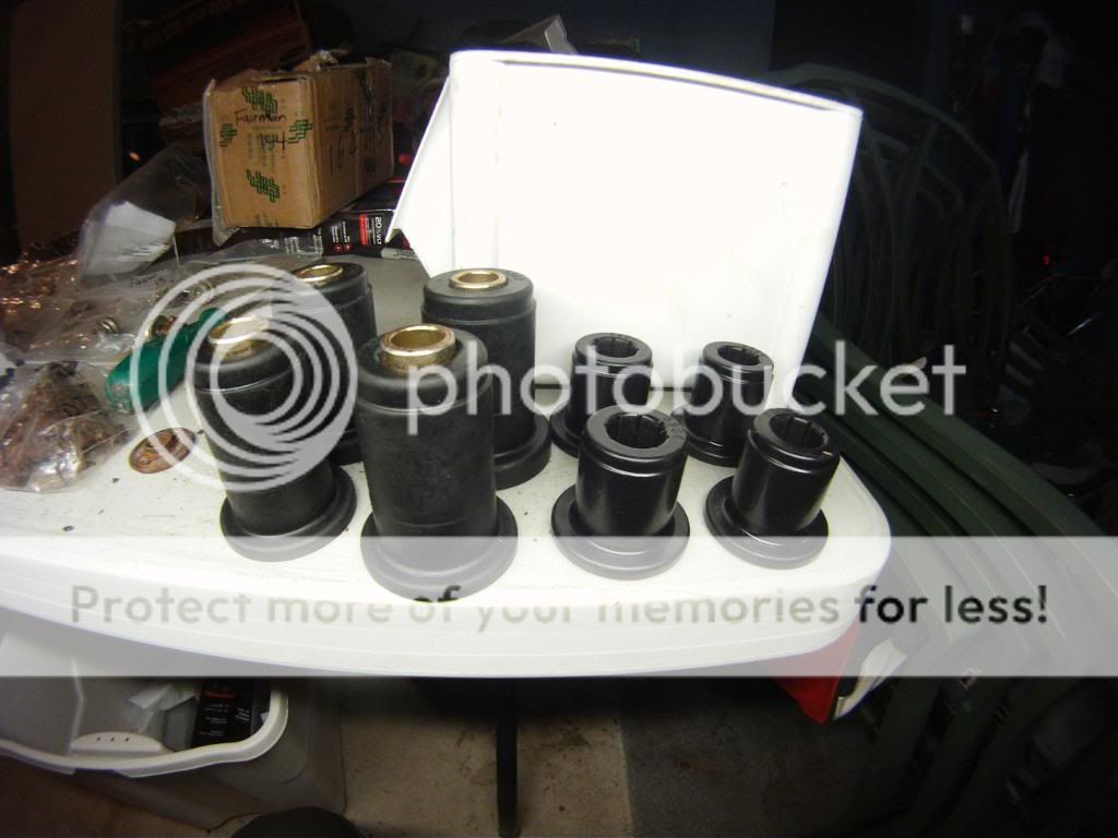

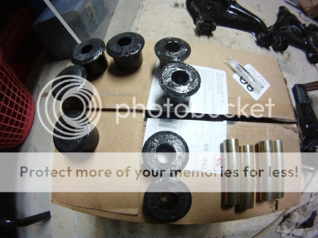

also was thinking about my spring eye bushings for the leafs, don't think any company makes a poly bushing, so instead of going with a stock rubber bushing, I'm thinking about some Poly "T" Bushings. has anyone done this? or know the size? just havn't had a chance to measure. The fronts are smaller than the rears, so id be looking at 8 "T" bushings total 4 in each size and 4 sleeves. Polybushings makes custom "T" bushings, so if i can figure out the exact size that's probably what I'll do.
figured out that the leafs are the same pretty much all years, just the hangers change, so the poly kits for the older ranger leafs will work for the newer rangers. ordered a set, some bump stops as well.. replace the factory crap looking ones. also fond out the red poly isn't Graphite Impregnated, but the black is. im going to have to look into the positives of adding it to the poly. more updates soon

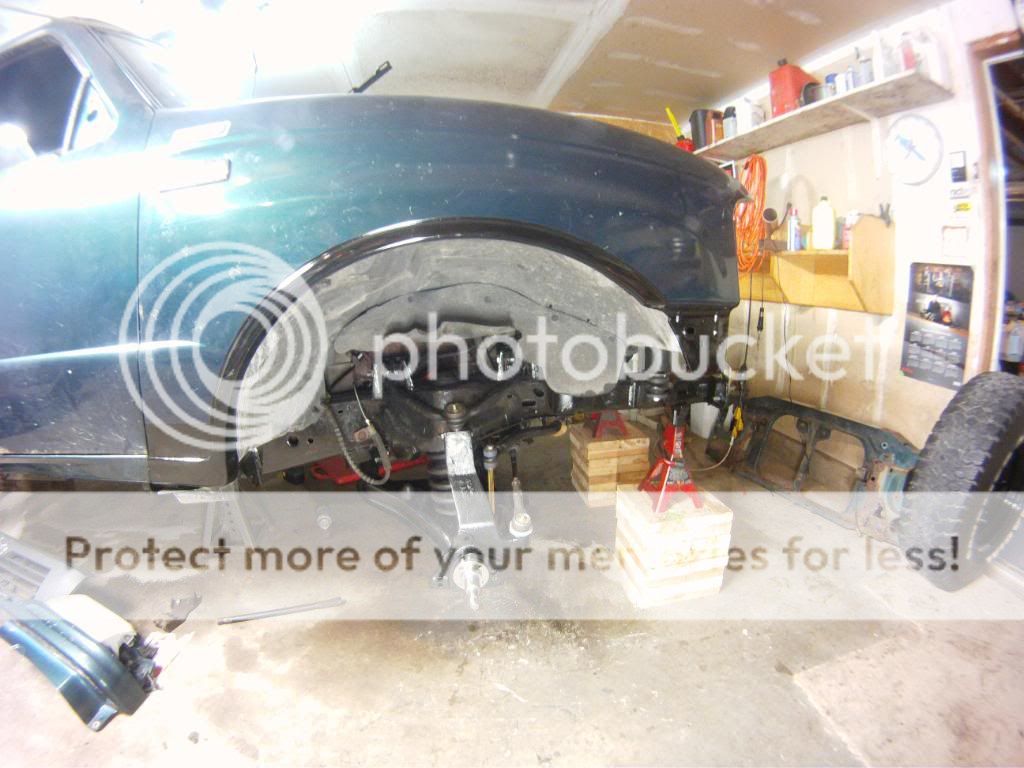

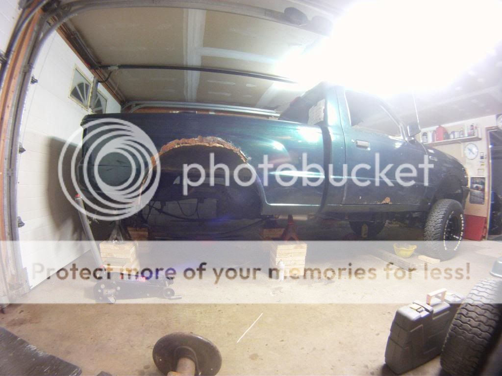

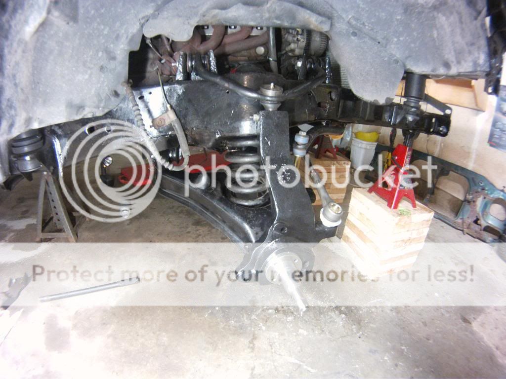

truck is 80% done, only thing left is an alignment on the front, and then the rear end still needs to be put together. so after installing the lift and suspension on the front, here are some things i found

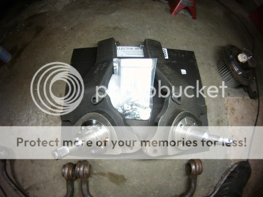

4x4 ranchos will not work. 0" lift and 2.5" ... no way possible, unless you were to cut a length out of the shaft and weld it back together, on a 4x4 the axle would need clearance past the shock but since the 2wd has no axle there is no need for that clearance, but that would mean chopping the brand new shock apart, for what? might as well buy something good. i have the 3" spindles and 2" coil spacers, only shock i could get to fit was the stock shock. any longer and the top of the spindle makes it impossible to turn the steering without grinding the top of the spindle into a circle and using a shorter bolt/nut for the ball joint. but then we are talking about seriously affecting the strength of the spindle. plus the mounting plate on the bottom of the shock that would mount to the bottom of the lower ctrl arm is smaller on the 4x4's. the plate is still long enough to have the holes stretched to retain the bolts,
another thing i found was you have to grind a fair bit on the lower ctrl arm and spindles for clearance when using the 2"coil spacers as well.

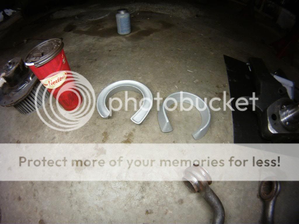

and lastly i have read about people using the spacers under the coil, and having isues of the coil popping out....... the spacers from doetch fit perfectly on top of the coil. i used an old tire tube and cut out some pads to reduce the metal on metal contact noise. 2 pieces of ele tape to hold the spacer onto the coil while it was put in place, and with it on top of the coil it still allows the bottom of the spring to go into its holder on the lower ctrl arm.
i wanted to see if the spacers would install under the coil, and allow everything to be bolted up.... and they do, it is a PITA to keep the coil and spacer in one place when putting it under the coil. the spacer wants to stay in the lower ctrl arm, but the coil doesnt. i did it by using a ratchet strap holding the coil in place from the opposite side of the truck. it was safe, and worked great, but the coil didn't completely seat on the spacer, and once again, a good bump and it would run the possibility of the coil/spacer trying to pop out. so ONLY install them on the top of the coil. they seat nicely. wrap some eletric tape around the spacer, which would never affect anything and it holds everything in place nicely for an easy install.
front brakes were a slight issue, i guess they make 2 types of calipers for the 98 2.5 2wd. the one has a larger span between the mounting points on the caliper bracket. this is the one that the part store gave me. tried it didn't fit, took it back, and it turns out that there is a part number with an A on the end pulled that out and its exactly what i needed, maybe it because i have REAR ABS, the A stands for ABS? i dunno just a guess, any way, fronts together and sitting on the tires, rear is still a bit away. will have more progress soon with more pics
