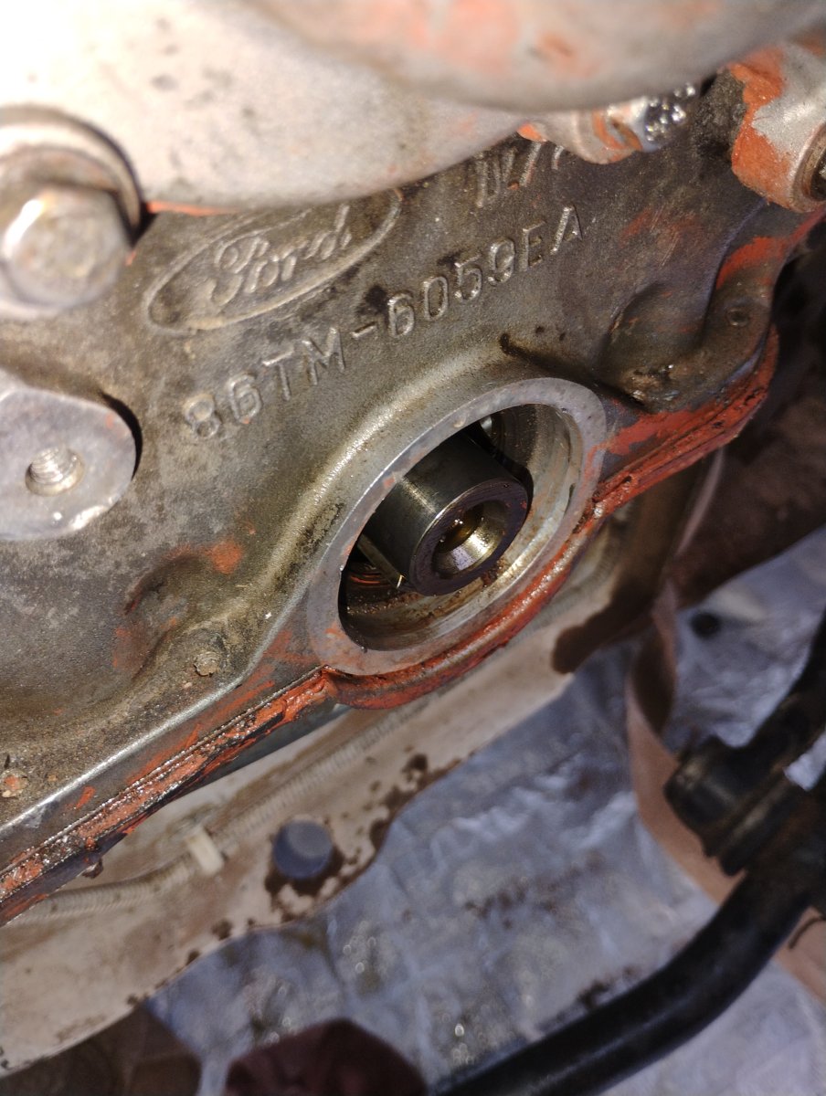

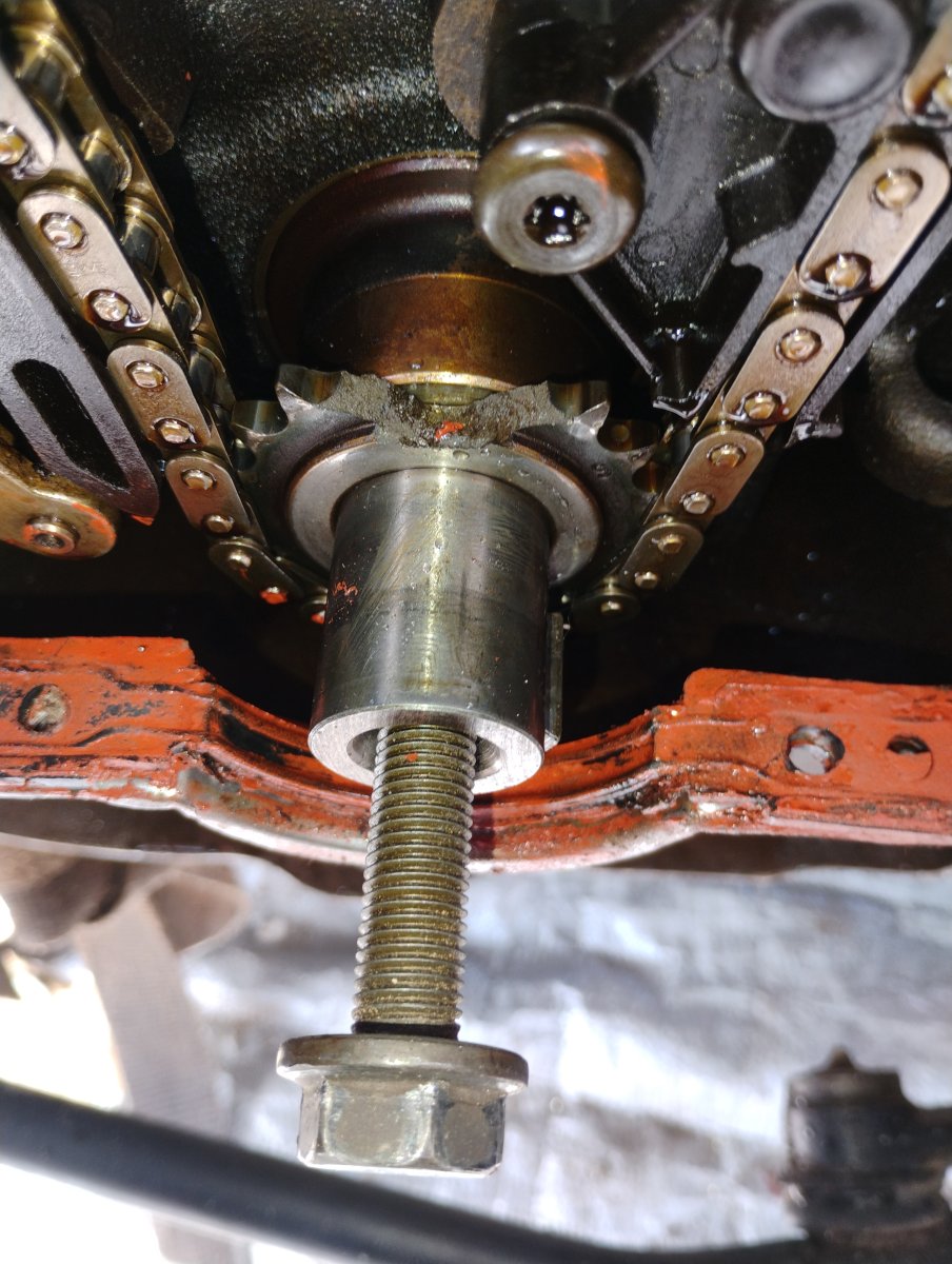

So I can confirm the crank pulley went and spun
Removed and cleaned up
Progress in pictures
Pulled cap and The fucking rotor isnt turning when turn the crank by hand .
Wtf

Can you turn the rotor by hand?
Broke distributor drive gear...
Distributor not down all the way.
Broken camshaft...
Broken camshaft...
I think the drive gear is held on to the shaft with a roll pin, that can shear.
