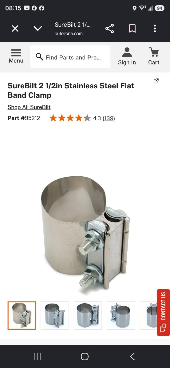

Get a replacement flange and clamp it on with this style clamp. See photo below.
But, honestly, if the flange and bolts are in that poor condition, I disagree with your assessment that the cat is fine.

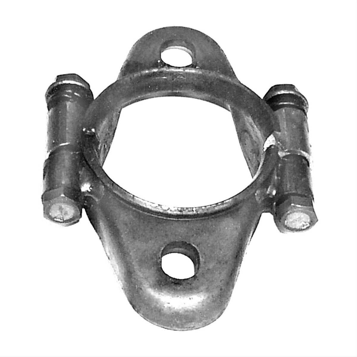

I used one like this...
