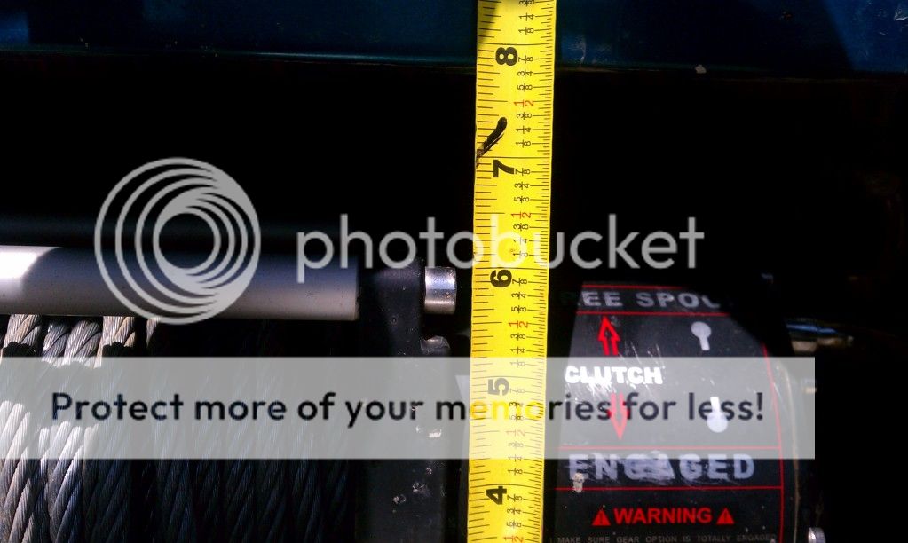

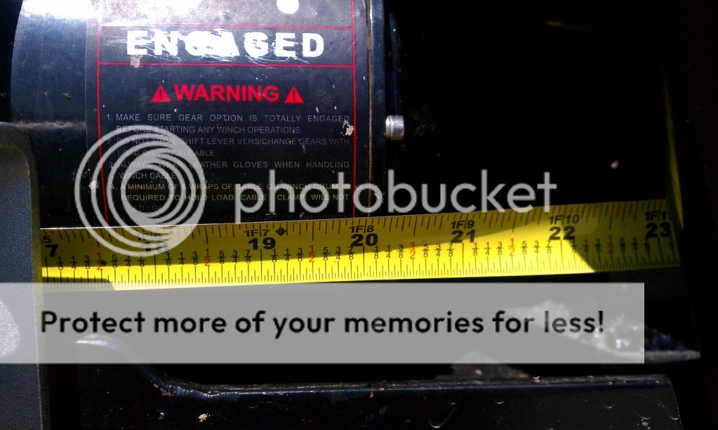

If you get a chance could you tell me the height, width and depth of the winch? Going to mount it before I get the winch and really mount my bumper?
Thanks
Sure. Give me a second.

Here you go.

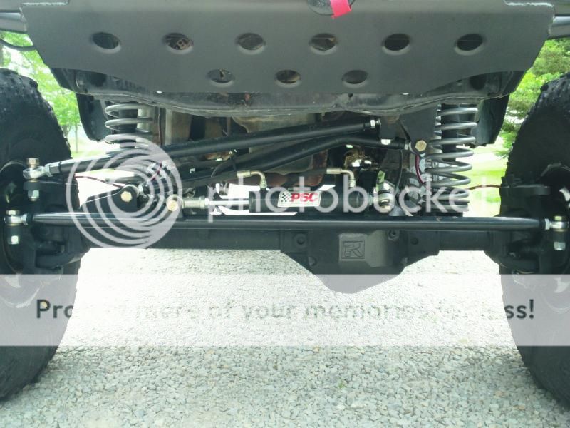

It is time for some steering upgrades.
I blew out the seal on the steering box on my last wheeling trip. Large tires on a stock steering system just isn't cutting it anymore.

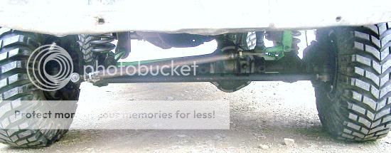

This is very close to what I want to do.
Escorts 2nd SAS
This is on an XJ that has a full width 44 or is it a 60.....anyways, I might use 1 ton TRE instead of heim.
Edit: Going to swap to WJ knuckles to have the high steer arm and larger brakes.
Sent from my HTC EVO 4G using Tapatalk 2
Stick with TREs. Hiems was the worst mod on my Ranger. I'm going to TREs this time. They don't chatter and moan and wear out in a month..err....week like hiems.
+1 on the TRE's.
3/4 ton chevy/gmc TREs are pretty stout.

Now that I remember, I still have access to hydrolic rams that when to a ford 8N, well actually they are mine.
That looks to be a kingpin Dana 60.
I loved my 1 ton TRE's on my old SASd F150. I scored Spicer TREs at a local shop for under $60 for all of them. Used 1.5 OD .25 wall DOM tubing with weld in bungs. Shit was bulletproof.
