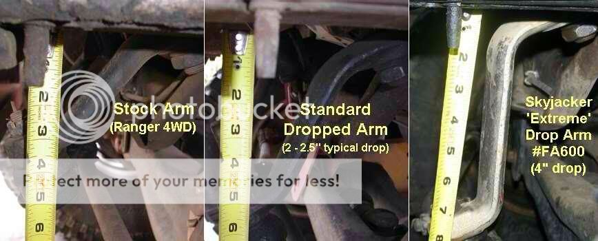

How does it compare with these, if you measure from the frame:
Escorts 2nd SAS
Looks like the middle one to me. The flat ones as far as I know only come on the 2wds.
Is your current arm a Ranger one or a
Jeep one?
I have a stock arm I'd give to you for the price of shipping if you want it. It looks like the far left arm in the above picture.

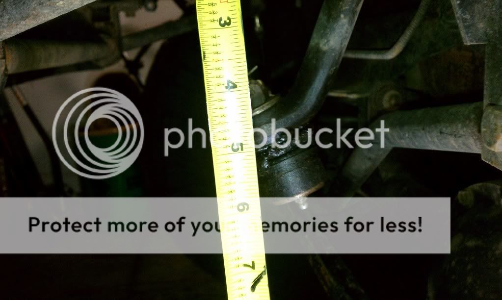

Here is the best pic I could take.
Escorts 2nd SAS
So it looks like I have the drop pitman.
