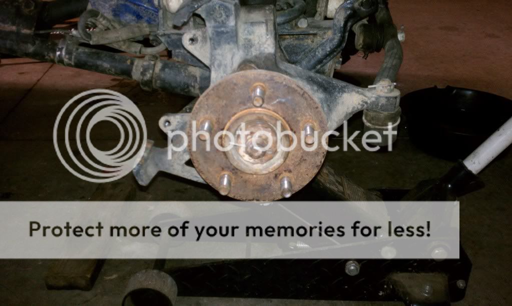

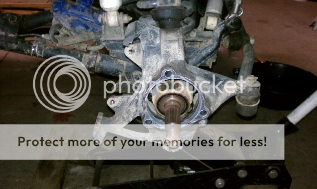

My new wheel bearing came in yesterday. This was a much needed fix. The old one was shot. I could spin it freely with no resistance.

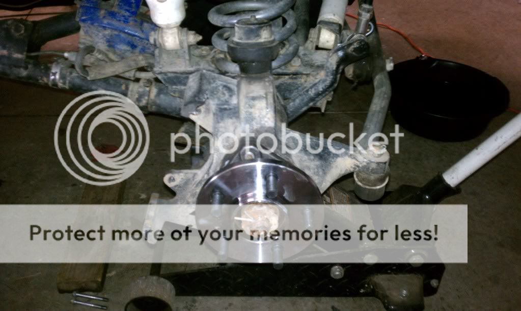

This should fix my problems with the front wanting to wander and shake.

I love how quick and easy it is to change the bearings on these axles.

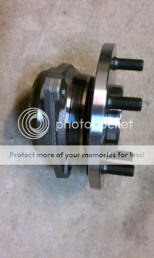

Got it from a company in Detroit called Dearborn Axle. Got a good deal on it. A timken brand for $45 plus shipping. I kept both of the old bearings for spares. One has a bolt in it in case I break an axle shaft.

Wait, thats the bearing?
all this time i assumed it was a hub with a separate bearing inside.
So i just go buy the bearing for my axle and they will give me the whole assembly with wheel studs and all?
It's a unit bearing, has the hub and bearing all in one unit...

Thing with these bearings are, they arent serviceable. But when it comes to changing them, takes no time at all.

Very true. Only takes a few minutes to change it.
The new bearing is like driving a new truck. There is no more vibrations in the steering wheel and drives so smooth now. Should of bought it months ago.
