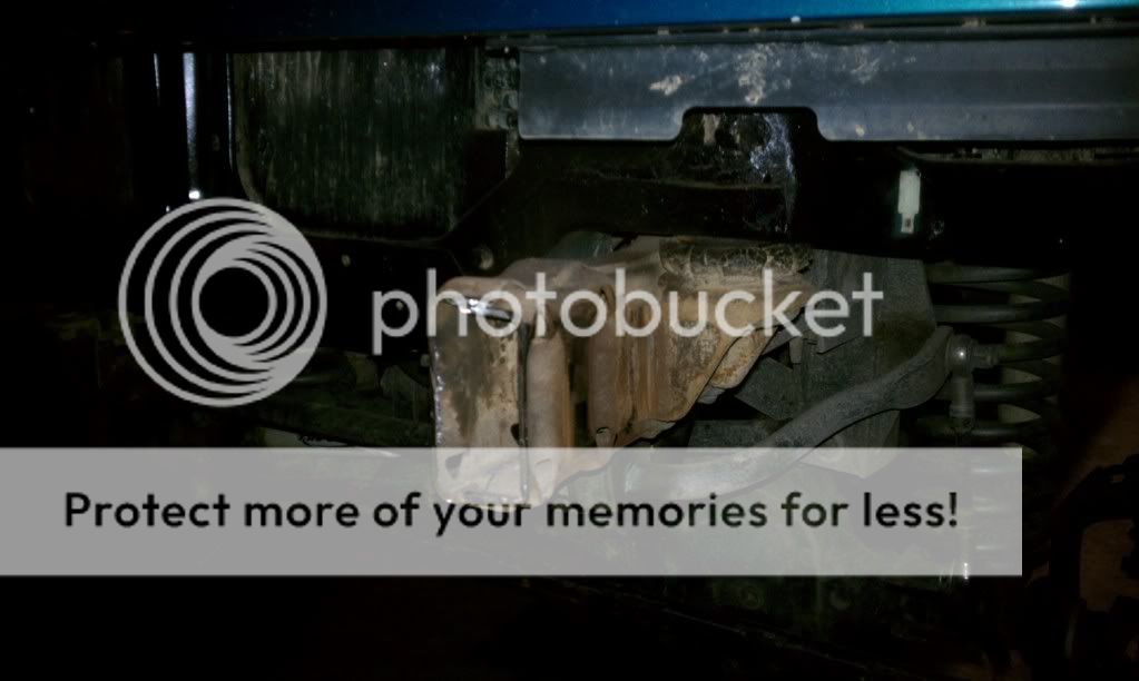

Got the frame cleaned up.

Tomorrow I am going to go get some plate steel. The place I get it from even cuts it to what ever size I need at no extra cost. And for tubing, I will ne using 1.5" DOM. Not sure on the wall thickness but might be 3/16" ? Anyway I got 22' of it for free so I can't complain.
Sent from my HTC using Tapatalk
Hopefully the rubber body mount will be replaced too, if thats wasnt what you were pointing out. My todo list is getting longer but my v8 swap is at the top of the list.
Yep, that and the rust. I am thinking of just using some hockey pucks for now.
