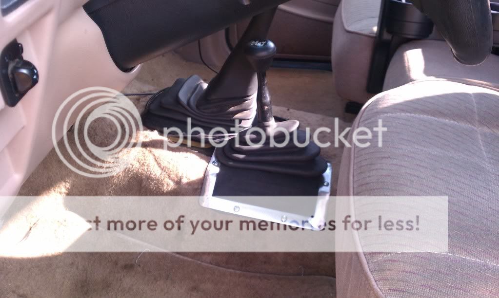

Small update..... Finally got the transfer case shift boot put on. Got it off ebay, it's for a mid 70's cj7. What a PITA... I made the mounting ring for it.
I originally had the stock shift boot that had the two cup holders on the side and when I cut the carpet out for the TC shifter, the cup holders covered the hole in the carpet..... now I need to find a piece to patch it
