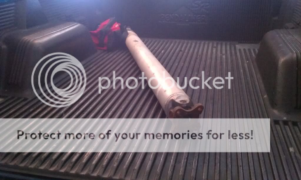

Picked this up today. Wanted a radiator but got this instead.
Escorts 2nd SAS
Yep. Got it at the take a part place here. It only cost me $19. I had to change the front flange to the smaller one. It came off a 2002 ranger. Took it for a drive and finally no more driveline vibrations.
I actually went there to get a radiator and left there with a driveshaft.
