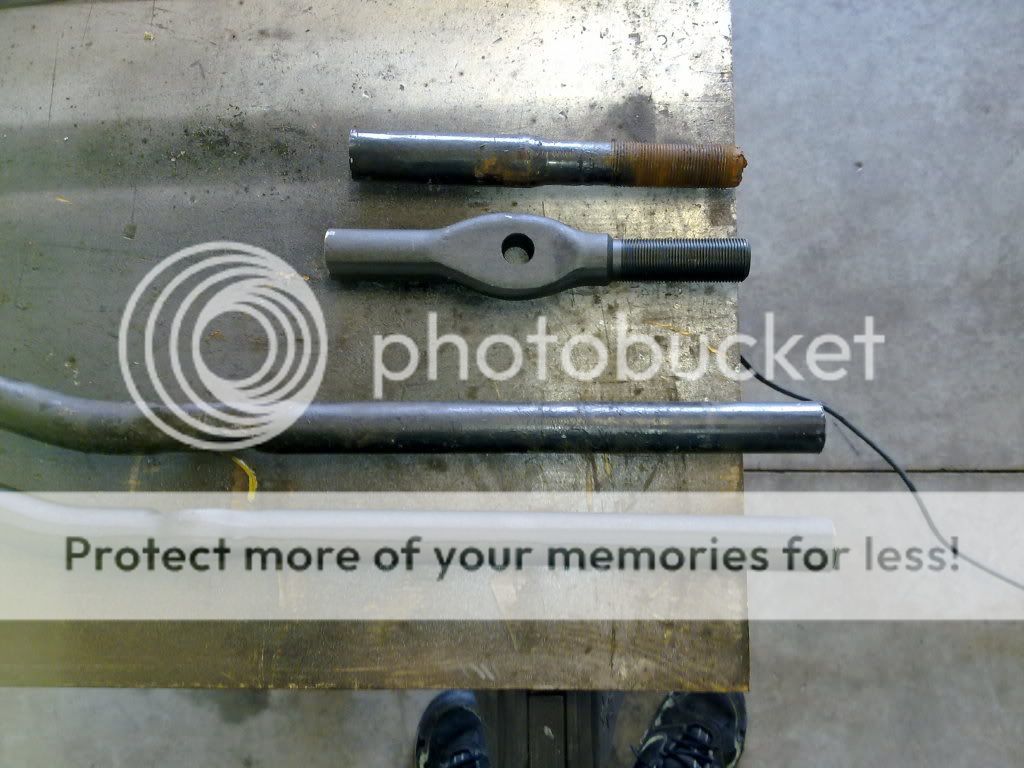

Replaced the worn out tie rod today. Had to drive across town to the only parts store that had the part, Autozone. I took some pics of the process this time.

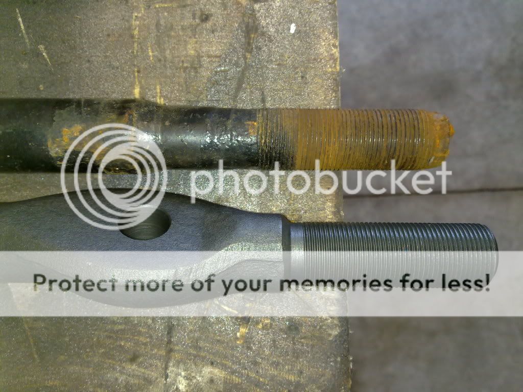

Have the new and old ones together, the stock xj TRE is too long

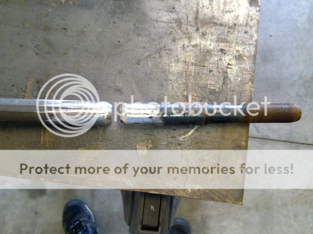

Cut the two ends off...
Cleaned up the cut and beveled the edges to get a better weld...

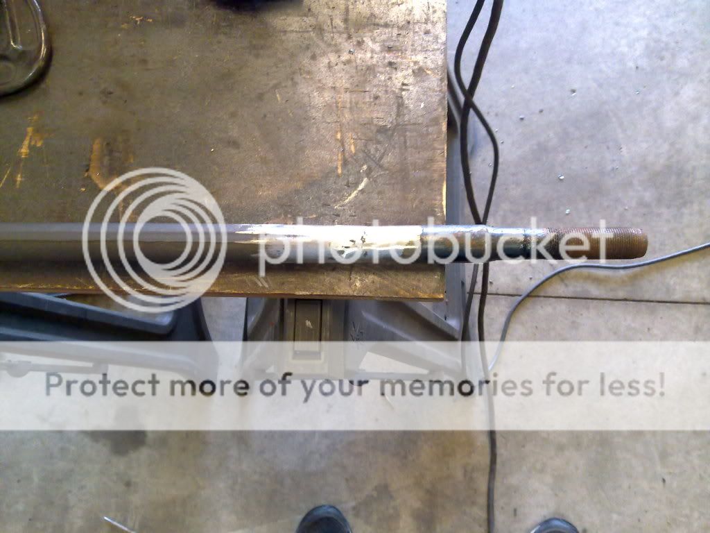

Here is the finished TRE....
Put some paint on it and took for a drive and no more clunking....:icon_thumby:
You need to sleeve that joint and use some plug welds.It will fail over time.
Please sleeve it!!!!!!!!
May end up doing that to mine so the steering wheel sits right and I gain some of my left turn back.
I will put a sleeve on it next week. Had to get it back together quickly to go to work today. It should be ok for now, this is the same way it was on the other truck ran it this way for 2 years so it should be ok for now.
