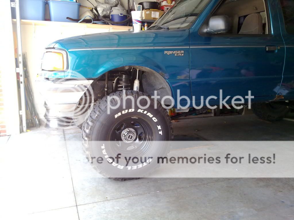

Oh, and here is a picture of the center caps on...
