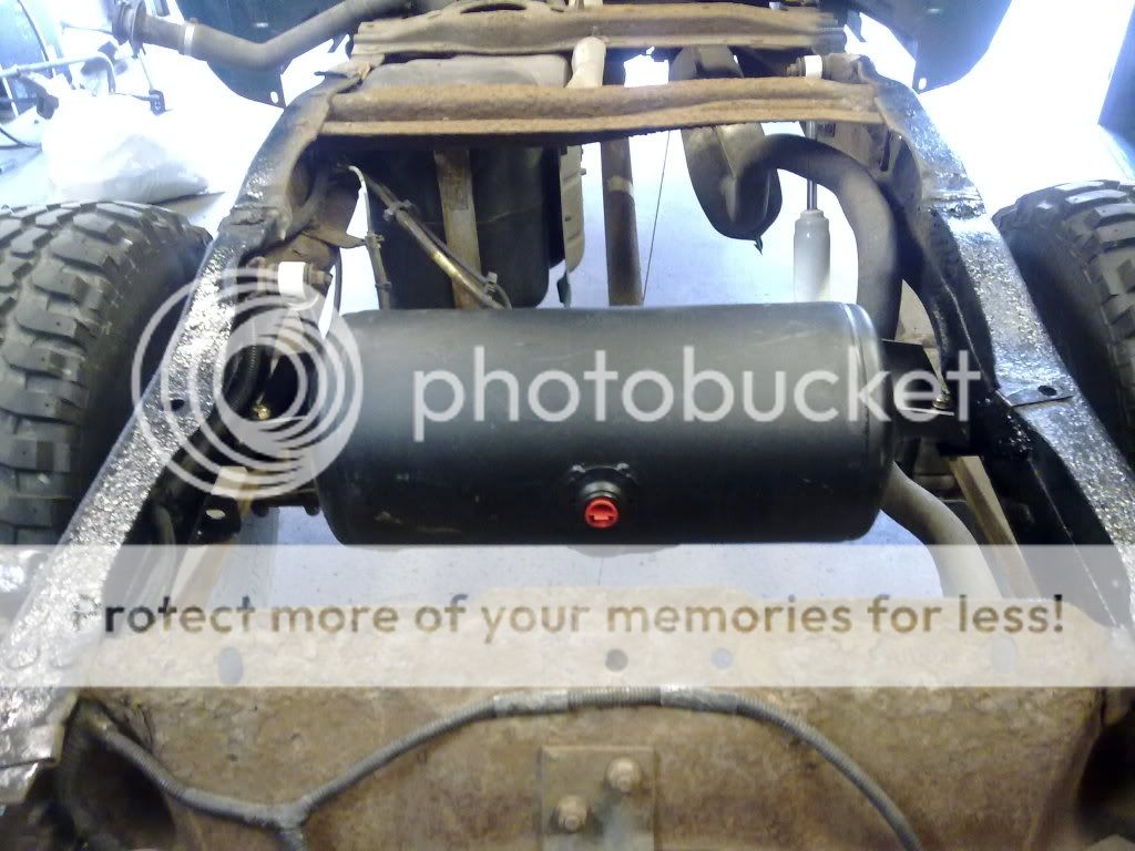

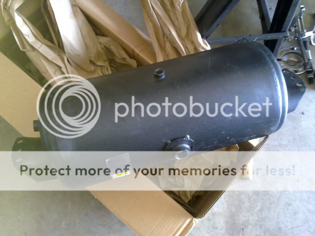

The 5 gallon air tank

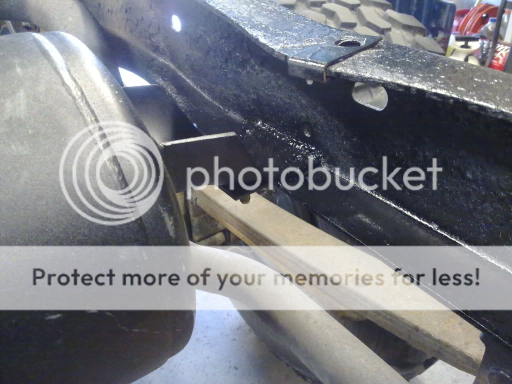

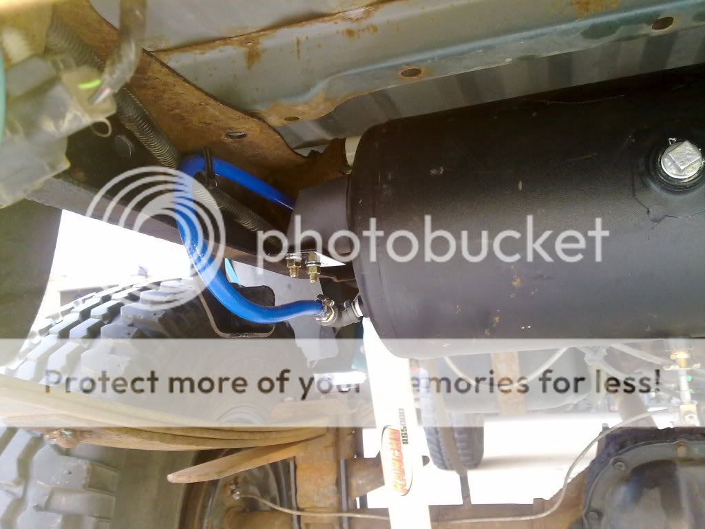

Brackets welded to the frame and the tank bolted to that.

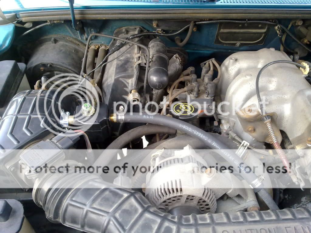

I put in an oiler I got on eBay for $4 and have the inlet to the compressor ran into the air filter box

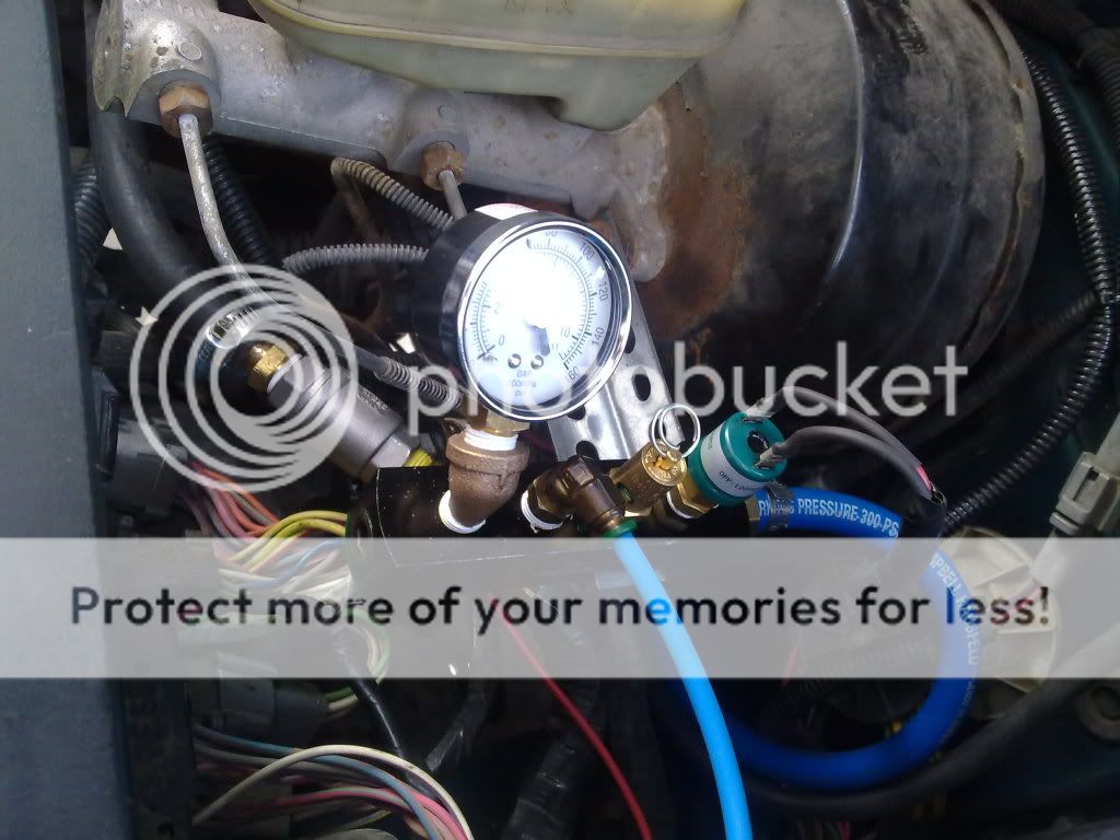

Here is the outlet that goes to a check valve then to a manifold block that has a gauge, front air line, safty valve, pressure switch 90psi on 120psi off, and then a 3/8 hose that runs to the tank in the back

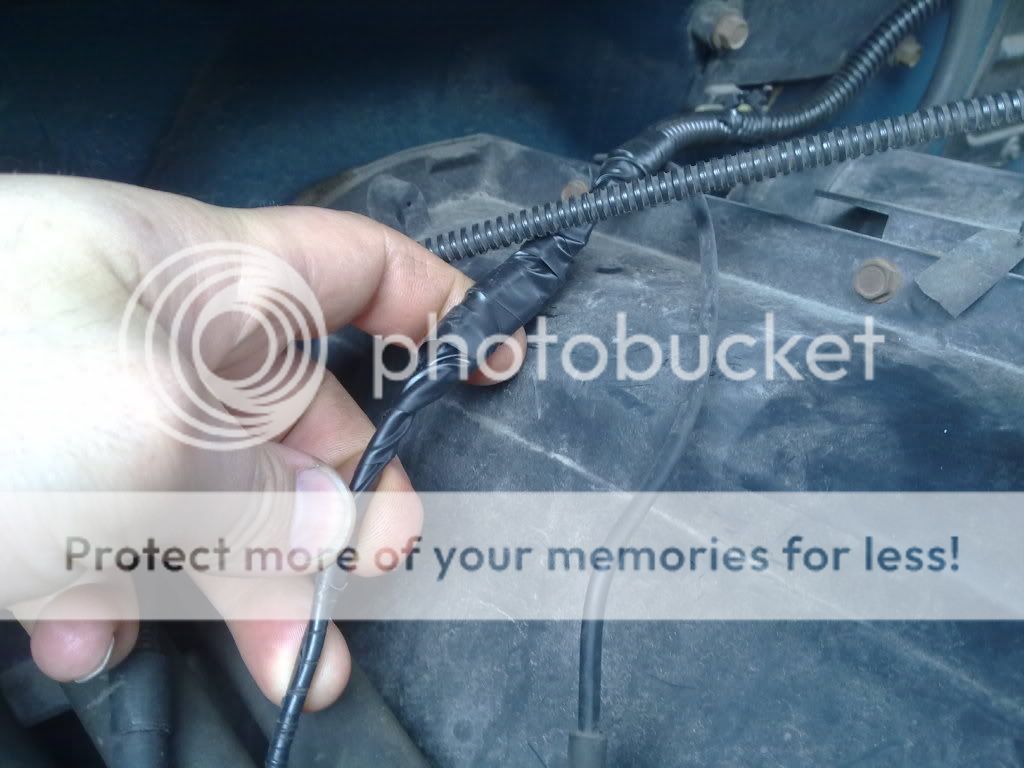

The pressure switch wires go to the a/c pressure switch wires that I cut off.
So this way I can turn on the compressor with the a/c switch on the dash and also this way I can utilize the factory relay for the a/c compressor clutch

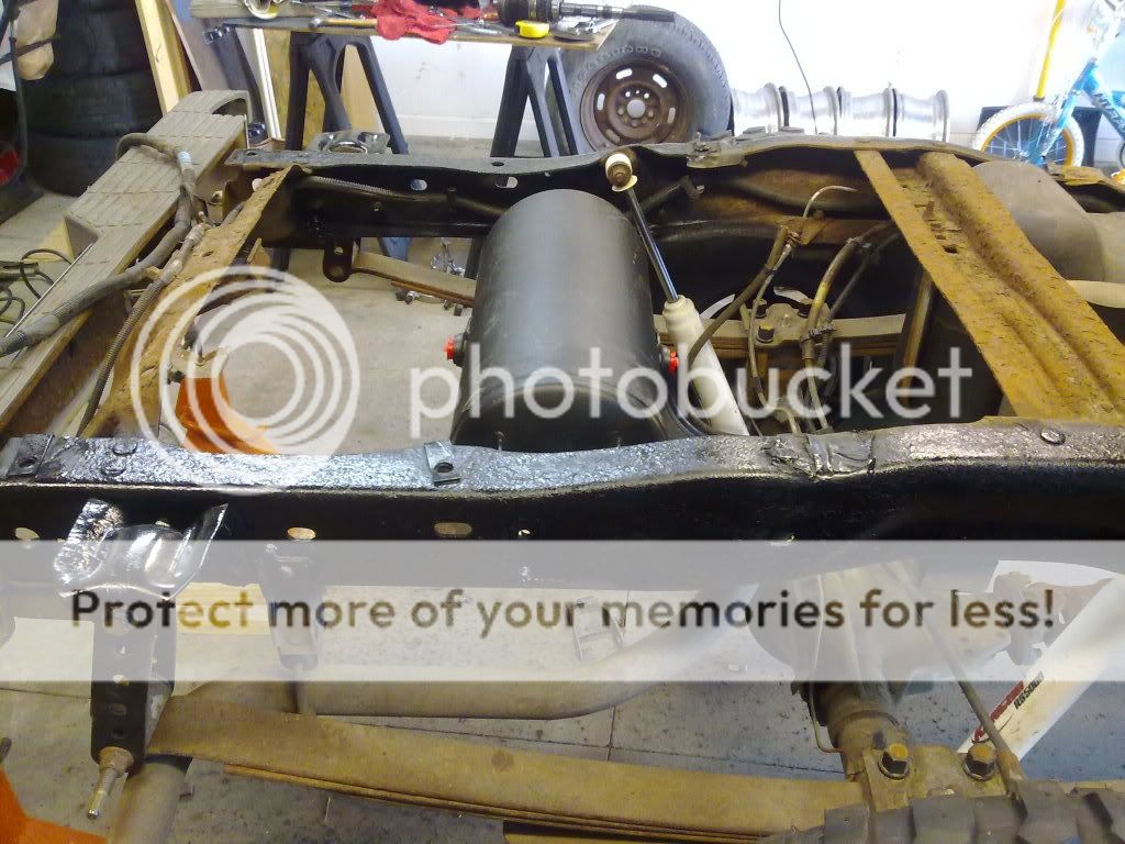

Here is a finished pic of the tank

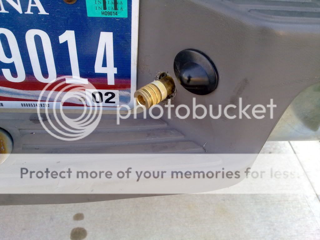

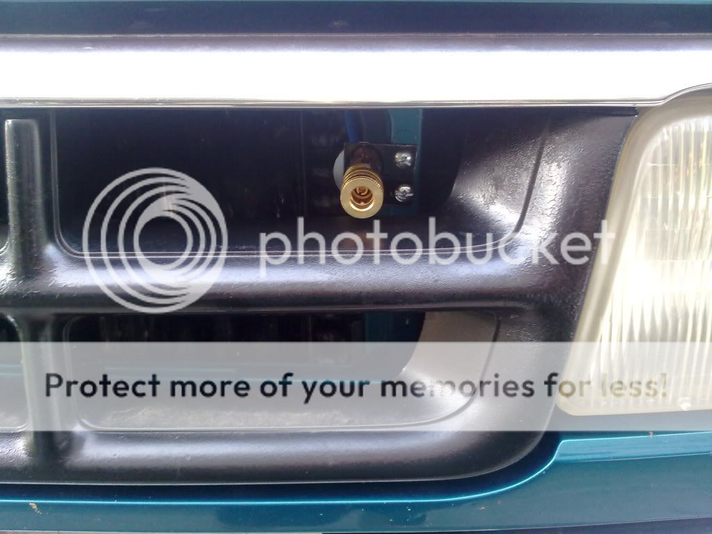

I have a fitting here...
...and here
It will fill the tank at idle from 0-120psi in about 40-50 seconds. Not to bad and all I invested was about $50 or so :headbang:

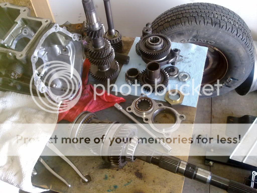

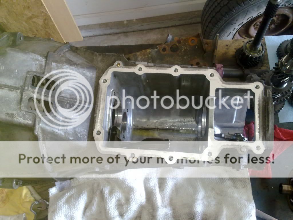

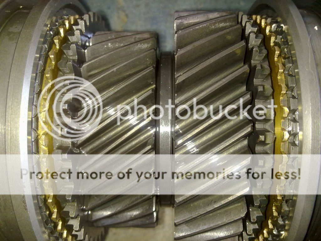

2.3 transmission torn apart to strip the mainshaft out of. I have a 2wd mainshaft I will put in this trans and sell it to recoup some money for future stuff.
For this transmission having 400k+ miles on it the gears look really good.
