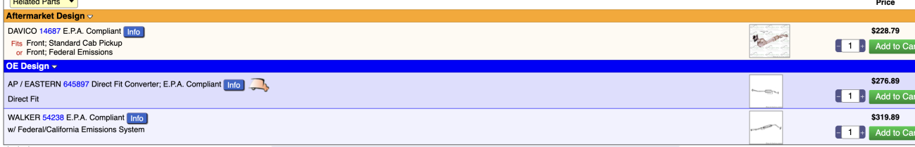

I pulled the OBD2 on the sensors, it's 100% shot. Sensor 2 was jumping up and down. Must be just worn out though, I have no blockages or the effects thereof that I can tell, so I think I've just been spoiling the atmosphere. I'm learning, I guess.
I was gonna also ask about the "aftermarket" davico, it's on RA for way less, but I can't tell if there'd be any fitment issues, if I get direct fit I'd try to install myself.

I would go direct fit, even if you are going to redo the entire exhaust. In 10 years the direct fit is still a direct fit to replace, a generic will require more exhaust work.

So this is interesting. I do have the fortune of a local shop that is honest. So I can get a universal put in for 75-100 bucks. No brainer. So is one of these cats a good move?
While I'm not sweating performance, would a performance cat in the 300 range outlast a direct fit epa walker/eastern etc?
