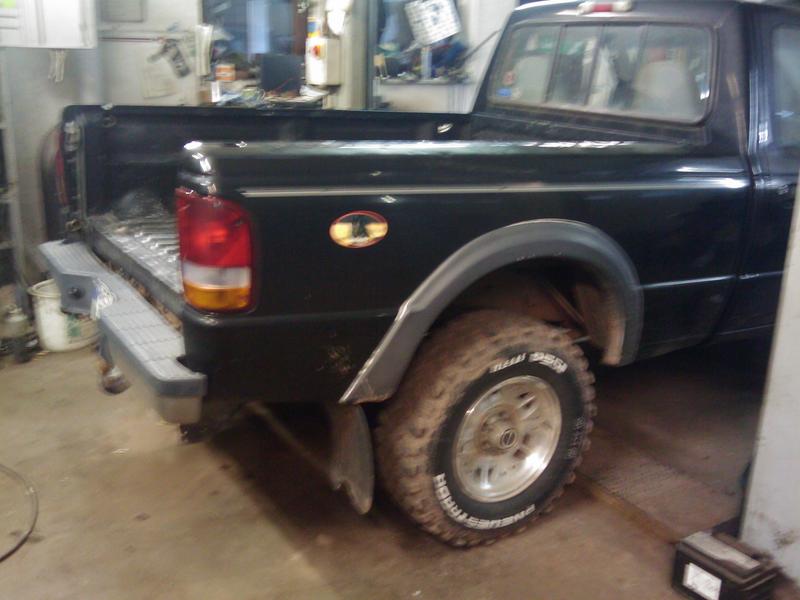

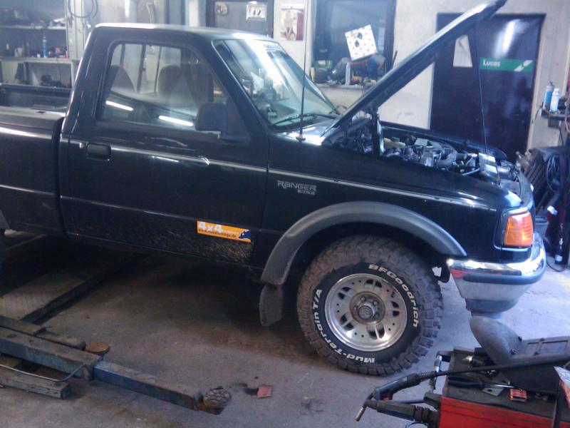

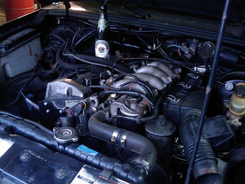

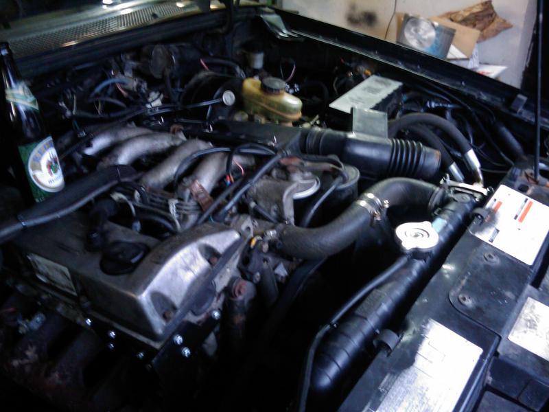

Hi at all im from Germany Bavaria and riede a 93 Ranger. It was a V6 2,9 Gas init before right now im swapt a 5 Zyl 2,9 Mercedes Diesel Engine init.It runs great an need just the half on Fuel bevor 18 Liter Gasoline now juat 8,5 Liter Diesel per 100 Km or 62 Miles. Wer calcolate to 100 Km in germany.The Engine have now 99 Hp an its ok for cruising and offroad. im using my Ranger for Hunting and work in wood and drive my dougther to scool, in the wintwrtime.[/SIZE]
