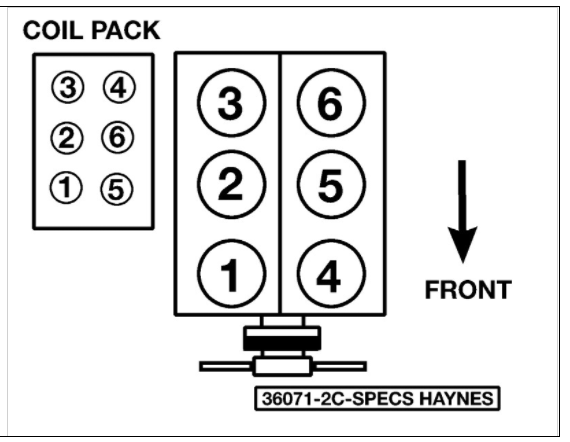

At this point I think its narrowed down to the timing. The ignition wires are set up according to what Haynes said. ?? The computer sets all timing. can you run the wires to cylinder diagram>? as
#1 cyl to what on dis?
follow these back for a double check, 1 side seems simple to do and the other does easy cross the wires on the firing order. 4,5,6 can be crossed up.
#1 cyl to what on dis? the ignition leads are set up like this...
70038

11. So here I am, having checked fuel, electrical, and compression. At this point I think its narrowed down to the timing. The ignition wires are set up according to what Haynes said. <<< even bad timing with a wire or 2 out will still run, but be real rough....
