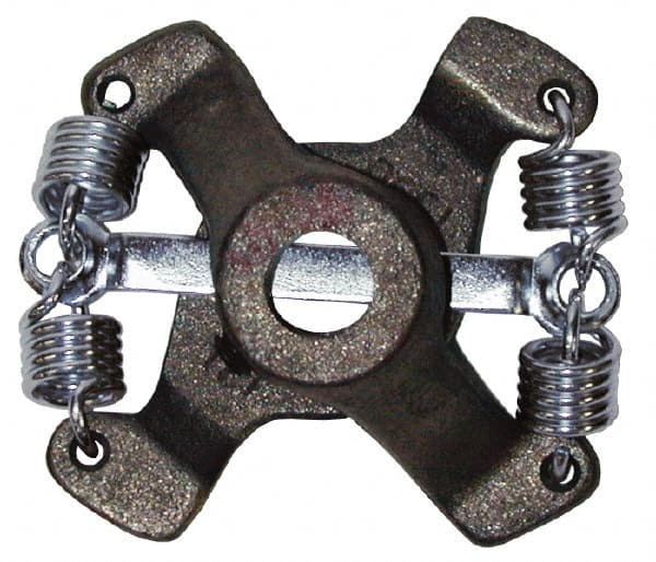

You need to fix the pump. You're not going to heat the house without it. It sounds like you're describing the "coupling" being broken. The coupli g connects the motor to the pump Impeller. Turn power off and disconnect the motor completely from the pump. Then you should be able to rotate the Impeller by hand and determine if
A. It's fine. Just need new coupling
B. It's seized. (Doubtful)
C. It has bad bearings. Will feel rough and maybe wobbly as you rotate it.
There is a 4th choice and that is the Impeller is eroded and not pumping efficiently. That would cause cavitation which can sound like gravel in the system.

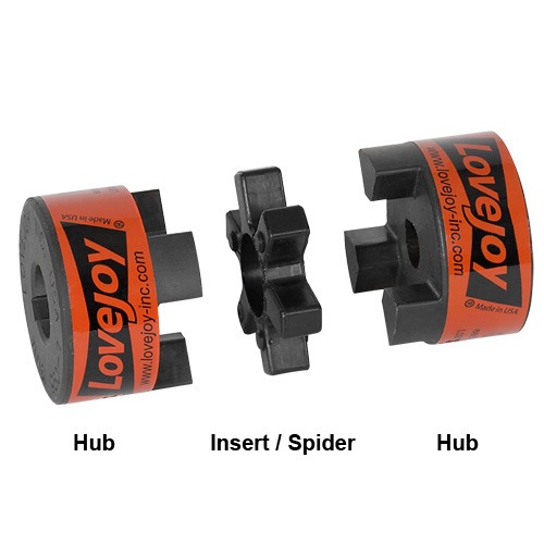

love joy...... has a whole new meaning with these things.
are you talking about the band Lovejoy? Sorry I'm confused.
Playing 'if' game - if coupler and impeller are both bad at some point it's probably better/easier/cheaper to just put the whole unit in, I don't know what I'm dealing with yet... but wondering, if I end up with a good pump, then have to replace boiler later can I still use the pump? Or are all the new ones having the circulator pump integral to the unit.
Rather keep this boiler going if I can of course. If manifold inside doesn't leak rest of stuff is replaceable. I think.
Lovejoy is a brand name that is used universally for a particular style of coupling. Very simple and reliable 3 piece design. Though I have seen a lot of small boiler pumps use a spring type coupling made popular by Bell & Gossett.
Bell & Gossett style

Ah. Yes diff type of coupler. The one in there was plastic, they break (metal ones too) it's nothing to do w/ maintenance they just break. The springs are so if the impeller does seize, they break so the motor doesn't burn out.
Guy never came last night which was ok. A guy came early this AM, experienced, he went right at it, replaced coupler w/ Bell/Gossett part. Older experienced guy. Impeller was fine he said 'like new'. Waited to heat it back up end ensure it works right. 2 yrs warranty parts/labor on it, doubt it would break in that time, but nice to know.

The couplings, Lovejoy or others are not generally "made to break". If the Impeller were to seizez, the motor current would rise and trip an overload device, fuse or breaker. The purpose of these couplings is to provide an easy way to couple the motor shaft to the pump shaft and allow for slight misalignment between the 2. That way you don't need a super precision alignment, which costs more money. The springs or rubber spider part also help reduce vibrations from being transmitted between the pump and motor. Just due to their design and nature, it is normal for the coupling to eventually wear out. That's just part of life. Nothing lasts forever, except plastic containers floating in the ocean.

Anyway glad you cleared that up about the springs I see what you mean, that's not the safety device for impeller seized it's for different reasons. However about them breaking, yeah, eventually I suppose that's to be expected. The old one on there was a spring-type but only the crossbar and springs were metal the four arms were plastic (cast in the B-G replacement per your lower pic in your previous post this thread.

Don't use a Lovejoy coupler on these applications, been there, done that. That Bell and Gosset is a poor design, but it's all they used for years. I finally found a new fangled re-designed coupler. They are not cheap, but they work great. Here is a link to one.
I had a problem pump, did all the right things to fix it, still could not get a season out of the standard coupler. So I had the same idea and bought a Lovejoy. It worked, but you could here the pump through the whole building it vibrated the pipes so bad. That coupler in the link above has been in there 3 years now, no problems.
