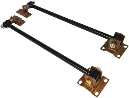

antiwrap bars ,i have never used but i feel like they could stop rotation either way and have thought about getting them, just for the heck of it, for my ranger. they look like they would do what you are talking about. one side bolts the spring seat at the axle and the other to the frame by the front spring mount. \/

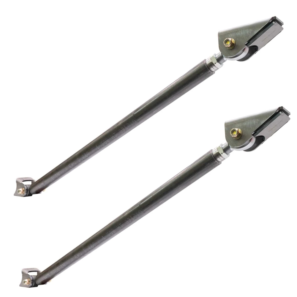

this seems to be the weld on style of antiwrap bars. \/

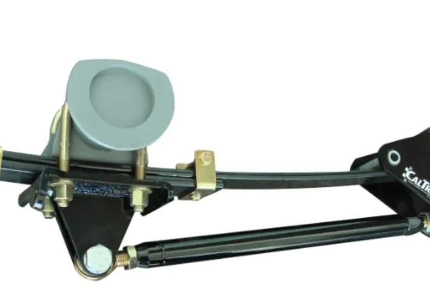

i think ricksrangerz sells traction bars for our trucks.
he does, calvert. they are kind of expensive and hang down alot and they looks like they won't help on the braking side. the front connection on the calverts seems to allow the axle to rotate when the brakes are applied
83-11 Calvert Racing CalTracs Truck Traction Bars (ricksrangerz.com)

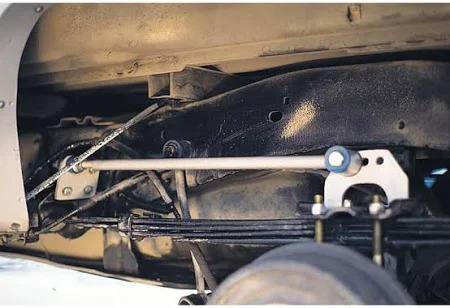

these are antiwrap for a ranger, from www.dufftuff.com
these are the ones i have looked at a few times

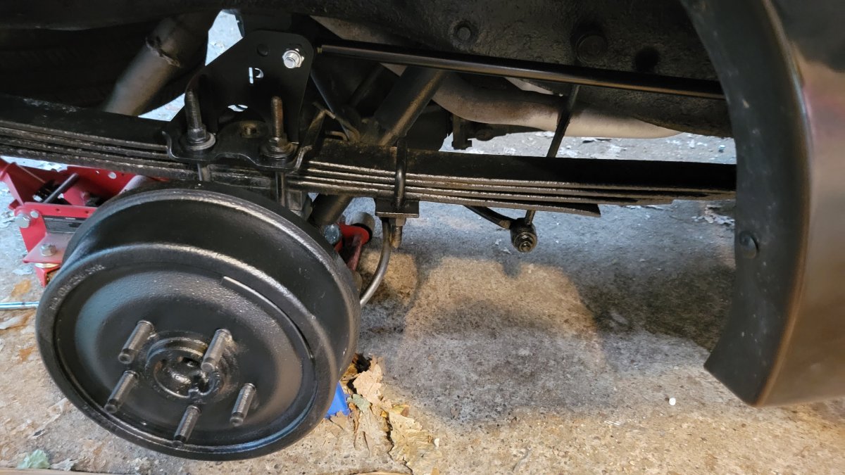

I really like that bar! I've got the James Duff type that bolt to the spring pack but run over the top of the axle.
i love how that looks on your truck
