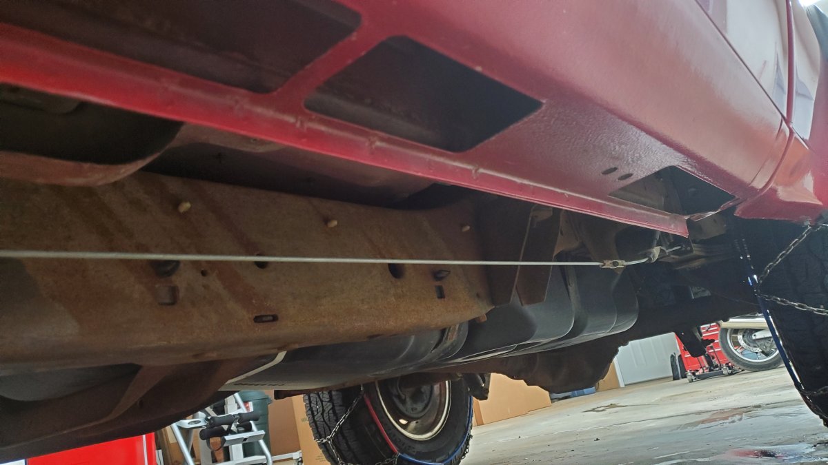

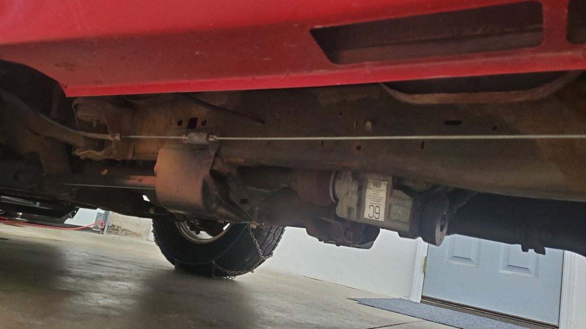

The cable looks clean (photos) but I thought there was supposed to be a helper spring on the cable itself? I've seen that in photos of some Rangers but maybe they were added?
