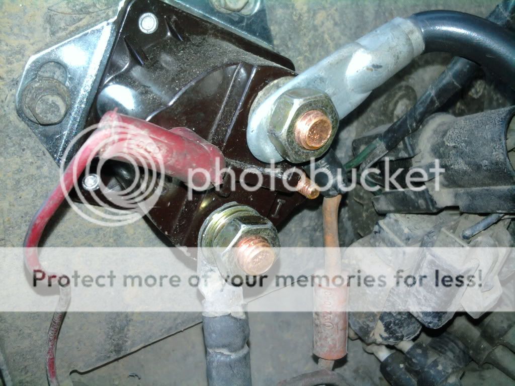

If you can show us pics of the start solenoid and the ignition module sometimes a pic tells a thousand words.
But take into consideration, he by passed the solenoid and still couldn't get the engine to turn over. Another thing, check your ground wire comming off your battery, could be loose and all the other ones too. Don't forget the positive one either. This samething happensd to my dads truck, turns out the positive cable was comming loose from the battery post clamp and visualy we couldn't see it, a volt meter told us when only ten volts was getting to the solenoid.
I will post some pics tomorrow.

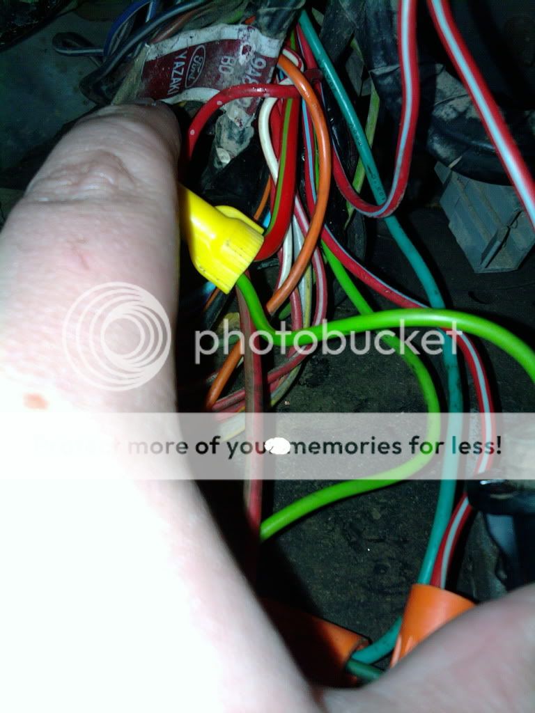

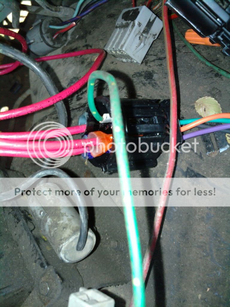

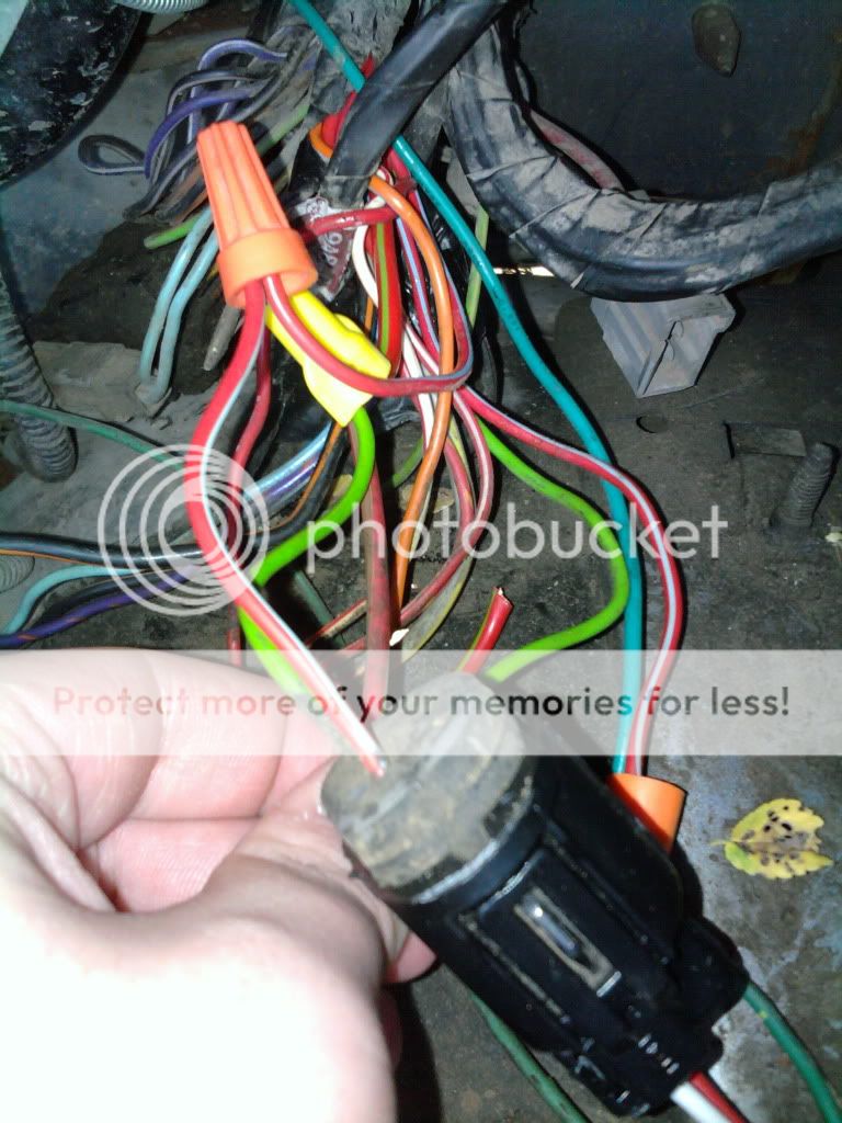

In the search bar type in duraspark and do your research. If you get rid of the computer harness and the vacuum lines you will be better off. Connect the 8 wire connector and strip the harness back to the alternator trace the wires you need all you need to cut is a couple of wires to remove the rest of the harness. Looking at the rats nest you have made no wonder you are confused. The only thing I can suggest is put it all back together color to color. If you havent got at least a test light maybe you shoud find someone to help you your obviously not listening.
I do not know what you are referring to as a rats nest, all the wires in the pictures are either other factory non computer related or ones associated with the durapsark conversion.. I understand the wiring and understand what i did for the wiring. I have followed the wire diagram on the duraspark page to the teeth. I have not had time to go out and hook up the rectangle plug with the alt wires, oil pressure and water temp. I am listening to everything you have to told me to check. I am going to go back and rewire everything to see if that solves my issue. I dont appreciate the tone of you response, if you dont have something that can contribute to the solving of my problem then dont post.
