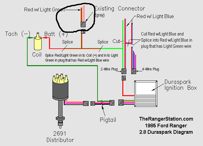

Yea same here I really dont know how it can be much simpler on the wiring if you remove all the wires for the computer first. On mine I only had to splice one wire and for the 85 you only need to splice two and cut two for the power to the module.

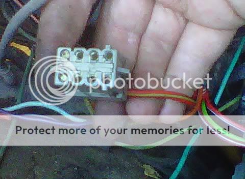

OK so i am pretty sure i got the dizz all the way down. Now the last bit of wiring i cant find the plug.
It says to use this plug in the tech page
IS the one the mean this one?
im glad im not the only one that doesnt understand what side of the wiring to use. I will have more info tomorow evening, after I talk it over with a friend.

I can tell that the guys on this site know their stuff. Im going with their expertice. I just wish that write up had info on vaccum lines and, where the ends of the wires showing coming into the diagram, are from. I think its just one of those things you know if you know slightly aged rngines that still use carb.
