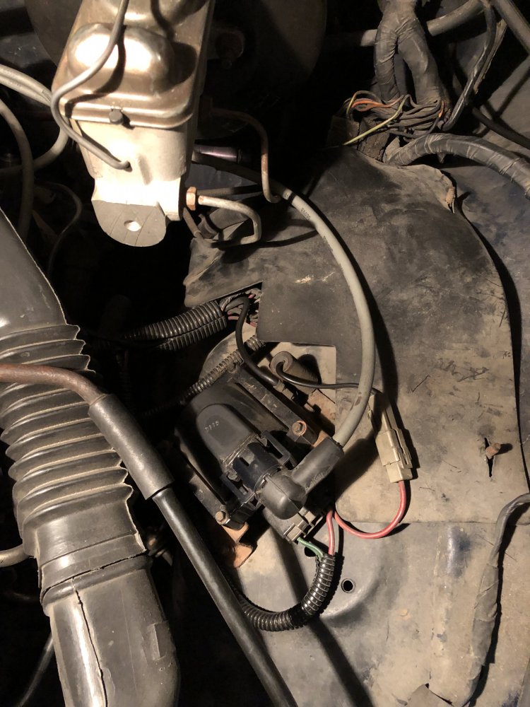

Are you missing the factory splash cover?
Didnt know they came with one. Both the 86 ranger and the 84 Bronco II didn't have one and had no remnants of one. I thought it was unusual the Ford engineers overlooked something so obvious. I wonder what people are doing over there that they are taking it off and not replacing it?
What year is that picture from?
1985
Hmm, I'll be working on an '85 and will be curious to see if I have the same thing. If not, I'm pretty sure you can buy those splash guards from Rock Auto. I know I got one for the driver's side front fender well for my (old) '04 Ranger.

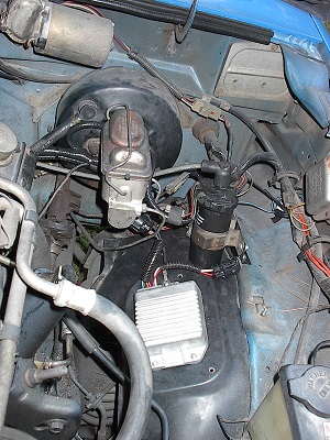

Doing the DS II conversion on an 84 - where is the best location to install the coil & ignition module. Experience is better than experimentation. :)
I hope it works for you.
You do not happen to have a link to that number do you for Cardone? I just got to thinking, I have all the records at OReilly's for my lifetime guaranteed distributor they sold me. O Reilly's tried and tried to get me another distributor under warranty, but they did not have any. Would Cardone be a stand-up company and let O Reilly's send my distributor back and get it rebuilt under warranty? I wonder.
Cardone has a "return & rebuild" program - give them a call. 800-777-4780 Customer Service
I have no practical experience with this (just my $0.02) but from what I've seen/read, the most common location is on the driver's side inner fender liner, just forward of the brake master cylinder. This location provides easy access to the two wiring connectors and there even seems to be holes (or indents for holes) already in the liner. The downside is that this spot seems to be susceptible to road spray & debris when the truck makes a hard left turn.
So, do you try to extend the fender liner so road spray isn't an issue? Or, do you build some sort shield/box for the ignition module? We already know that the ign. module is subject to overheat so you'd want it someplace where it can stay cool.
I've seen them mounted on the firewall, just above the distributor. I've seen them mounted in the cab. Of course, that means you have to extend the wiring.
I've thought about adding a heat sink (which I've done on a motorcycle I owned). The ign. module has ribbing on the top surface but it's nothing like a heat sink from a computer. You just need to purchase the correct epoxy.
At this point, you need to decide what kind of effort you want to put into your install. Keep us posted on what you decide and why. Hope this helps.
All the wiring you need is on the drivers side inner fender. I re-used the TFI ignition coil and just left it mounted where it was originally, which was on the driver's side fender also.
I usually mount mine to the plastic splash shield (on the driver's side) with 1/4" bolts and washers and space it abut 1/2" above the shield for air flow. I have seen ones mounted on the inner fender on the side panel, but, that may not have been stock.
