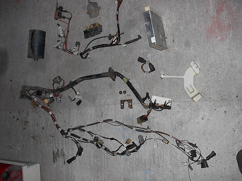

Yes, it cleans things up considerably to just remove it after the Duraspark conversion.
I removed all of the stuff which was no longer used or needed- the computer and its wiring harness, the vacuum solenoid bank, and its related reservoir and vacuum tubing.
My pile of removed "leftovers":

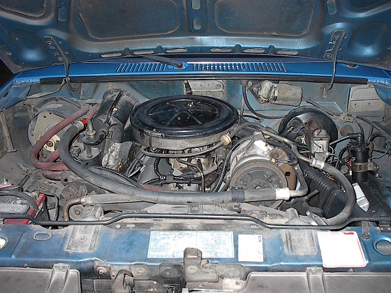

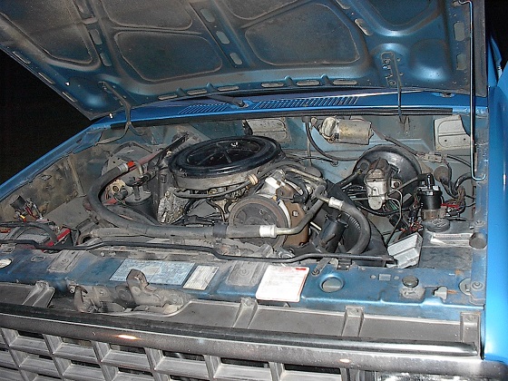

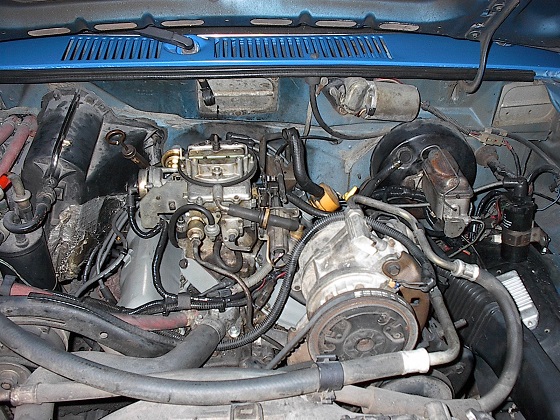

OK. Here's a few.
'84 model, automatic with AC and I kept the AIR pump. EGR was deleted, along with the several various sensors and actuators for the feedback system. Original 2150A carb was kept, but rebuilt and the idle solenoid replaced with a homemade metering block. Ford Duraspark module with a can style coil. Remaining wiring was reharnessed and cleaned up as needed.

Not really "clean", but definitely less cluttered.

Pop the hood on any mid-60s Mustang and that'll give you a good idea.
YES! With all of the crap removed, the old truck is now just like the old '60s cars that I grew up with.
