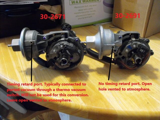

Being these distributors are really hard to find any more... there is an optional distributor with dual vacuum ports that can be use in this conversion.
This is a picture that shows the differences between the two. I marked up the photo to update the above mentioned Tech Article. I'm adding it here to maybe help you find either one and also let members critique the verbiage used to describe them before updating the article.
Shouldn't that be "timing challenged port"?
Otherwise, it's perfect! (y)
As of a couple of weeks ago, the dual port version is unavailable now also.
