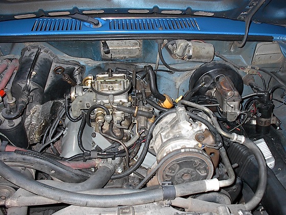

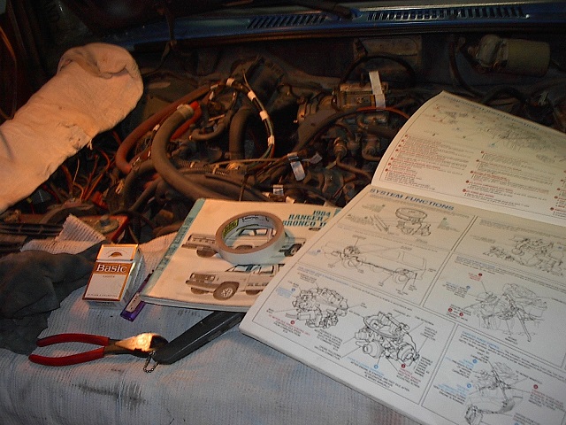

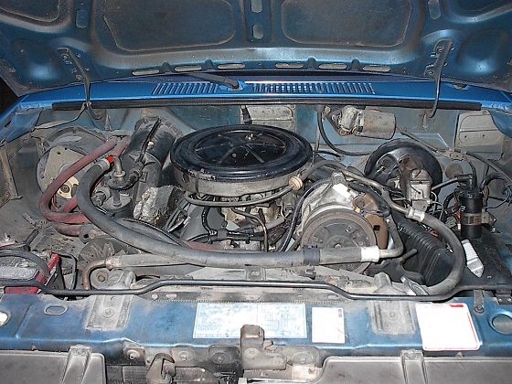

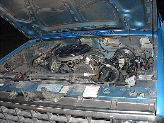

OK. Here's a few.
'84 model, automatic with AC and I kept the AIR pump. EGR was deleted, along with the several various sensors and actuators for the feedback system. Original 2150A carb was kept, but rebuilt and the idle solenoid replaced with a homemade metering block. Ford Duraspark module with a can style coil. Remaining wiring was reharnessed and cleaned up as needed.
Not really "clean", but definitely less cluttered.
YES! With all of the crap removed, the old truck is now just like the old '60s cars that I grew up with.
Robbie's wiring puts mine to shame currently... That's on my list to clean up soon.
