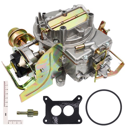

The carb came set up from Carburetors & More in Texas. They ran the carb on an engine stand on a V8. I asked if the settings would translate to a 2.8 V6 and they said they would. I have not messed with the carb settings at all. They told me to set the timing to 30* BTDC at 3000 RPM. I don't have an external tach so I'm not sure how I'm going to do that.

As far as the carb goes......................... what size venturis does it have? What jets do you have in it? I am just sort of questioning whether it's grossly oversized for a V6 if they have it set up for a V8. That would explain why it's running rich... those Motorcraft 2bbls were used on pretty much everything up to big engines like the 429. The adjustment screws on the carb will only control the engine at idle so if you have those dialed in correctly and it's still rich while driving around, there is another problem.
It has the 1.08 Venturis but I do not know the size of the jets. I can ask. Do you know what jets it should have in it?
1.08 venturis sounds right, I do not recall the jet size exactly. #51 or 52 seems to pop into my head but again it's been a lot of years.

Just for reference purposes, I bought a carb just like the one in this link
And it has been working fine for the last 3 years on my 2.8. I did have a few problems in the beginning, I did end up swapping the float and the power valve out of my old original computer controlled carb into this new carb. It ran great the first test drive, but was doing some bucking in the 2nd test drive. I wasn't sure if the float was acting up so I changed it, and I didn't like the look of the power valve they had in there so I changed it also. The problem went away. I then had a minor leak around the top of the carb, their gasket was not cut accurately and fuel was leaking around the top in one corner. So I stole the gasket off the old carb and everything has been good since. Typical made in China stuff.
But I am confirming that a carb made for a v8 will work fine on the v6, jetting and all. I did not change the jets. This carb says the venturi are 1.16, I think mine were 1.21. The only thing I notice about it is I can't lug the engine as well as before. In other words, when in town if I am below 45mph in overdrive I need to shift when I didn't before. I noticed on the sunvisor the shifting instructions do tell you to shift out of overdrive below 45, so I guess it's not a big deal but it did run better below 45mph when in overdrive with the original smaller carb.

A 2150 with 1.08 is around 289 cfm, with 1.12 is about 351 cfm, and the one from a 429 2 barrel( I don't know how they were marked) flowed 500 cfm. The 1.08 is what you'd want, I've seen them on 2.8 Mustang II's and 79 Mustang 302's.
