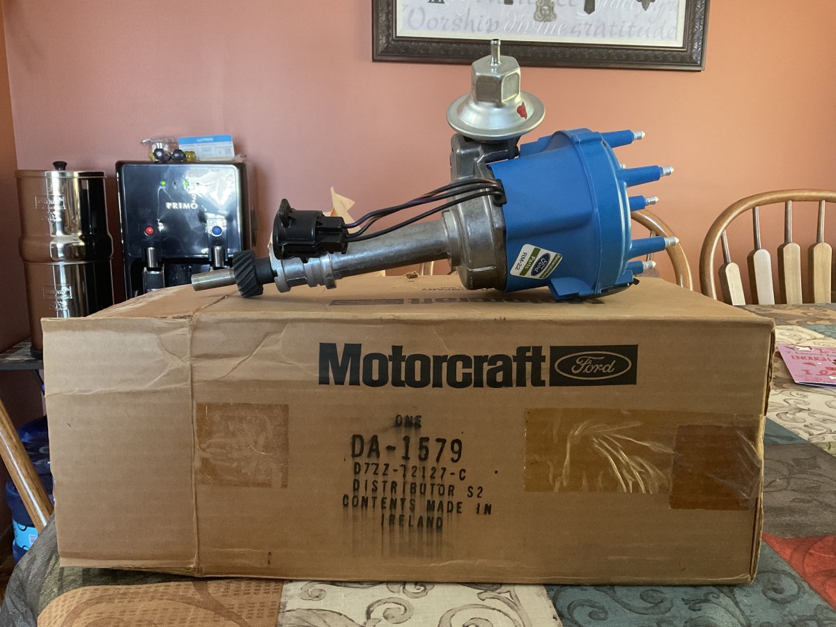

I wasn’t able to find one, anywhere. I called Green Sales Company and found they have one for a 78 Mustang 2. As soon as I get it I’ll post the Ford part number and info. $150 plus shipping.
Just what I needed NOS 45 year old distributor. $170 delivered.
They only have 3 left now.
D7ZZ12127C is the part number you need to enter on their page
I’ll update again when it’s installed and running.
Pretty much exactly what my re-man Cardone unit looks like except I have NAPA rotor & caps which are grey. (y)
