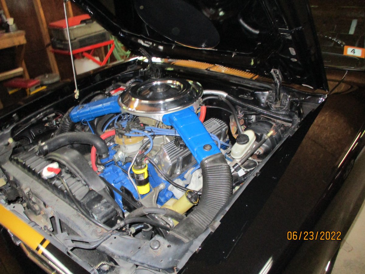

I always use a duct to bring in cooler air instead of running an open air cleaner. My favorite air cleaner is all aluminum except the snorkels and was used on a bunch of late 70's/early 80's cars and trucks.
This is the one on my Mustang, they're usually kind of dull bare aluminum but I polished it up. The right side air duct is original, the left side duct and convolute tubing came off an 85 Crown Vic with CFI. The upper lid from a CFI car will fit, the lower air cleaner body won't because the CFI was slightly bigger diameter than a carb.
Nope. The hot air tube from the manifold was to prevent carb icing and to keep the fuel from condensing into droplets during cold weather. In the late 70's/early 80's if the air cleaner vacuum motor failed and vehicles drew in ice cold winter air they ran like crap. A 78-80 Fiesta with a dead vacuum motor would barely go 50 mph, sucked fuel like a big V8, and the cat would glow red form unburned fuel. Once the air is 50 degrees or warmer the hot air pickup isn.t needed.
This is the one on my Mustang, they're usually kind of dull bare aluminum but I polished it up. The right side air duct is original, the left side duct and convolute tubing came off an 85 Crown Vic with CFI. The upper lid from a CFI car will fit, the lower air cleaner body won't because the CFI was slightly bigger diameter than a carb.View attachment 83886
