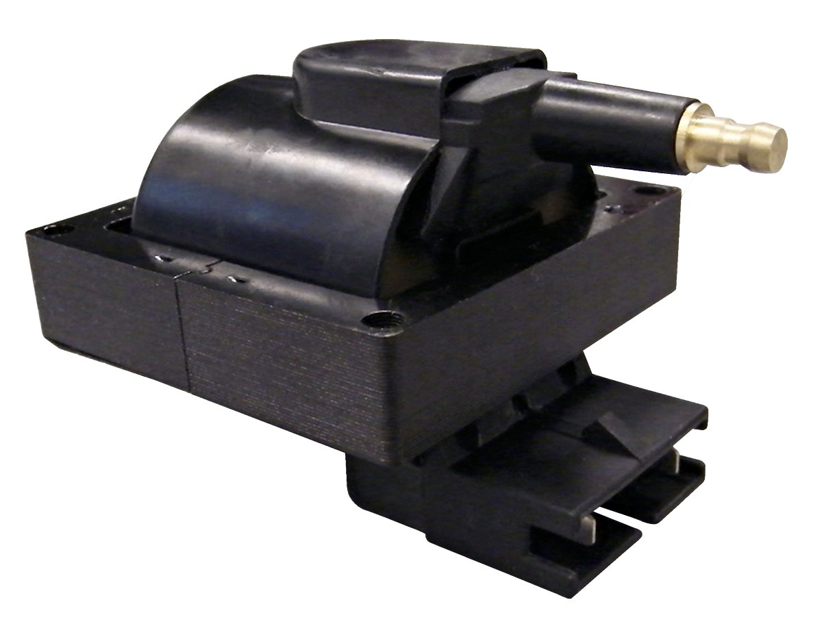

So, like the original one, like this?
There must be a leak somewhere then. I tried shooting a little starter fluid around the intake, vacuum tree & carb. The RPMs never changed.
That is a square TFI coil, don't use that one unless you are running a HEI setup.
You need the round duraspark coil.
You need a ballast resistor if you run the round cannister coil, not necessary with the TFI coil though.

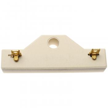

I am running a ballast resistor, the same one recommended in this thread (BWD RU19, O'Reilly 2015-05-01):
And, interestingly, the Accel 8140 is listed as a replacement for the Duraspark coil (on the O'Reilly & AZ web sites).
