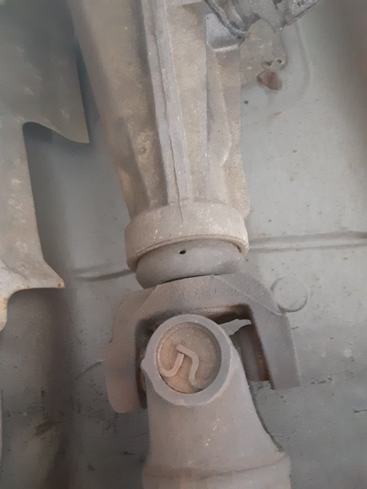

Hey all,
I got a 91 Ranger Supercab that the Drive Shaft Center Bearing gave out on.
I got the part between the center bearing and rear off.
Can I just unscrew the nut on the drive shaft and slip the bearing off? Or do I need to drop the driveshaft between the transmission and center bearing?
If it's the latter, how do I slip it out of the transmission?

Unbolt the carrier bearing from cross member and the short part of drive line will just slide out of the rear of the 2WD transmission, but have a pan under it as it may/will leak some ATF out, not alot, but some
You can change that rear seal in trans, its not an expensive part
But....if you don't have a vise it might be easier to loosen that nut as is with trans in Park or in 1st gear

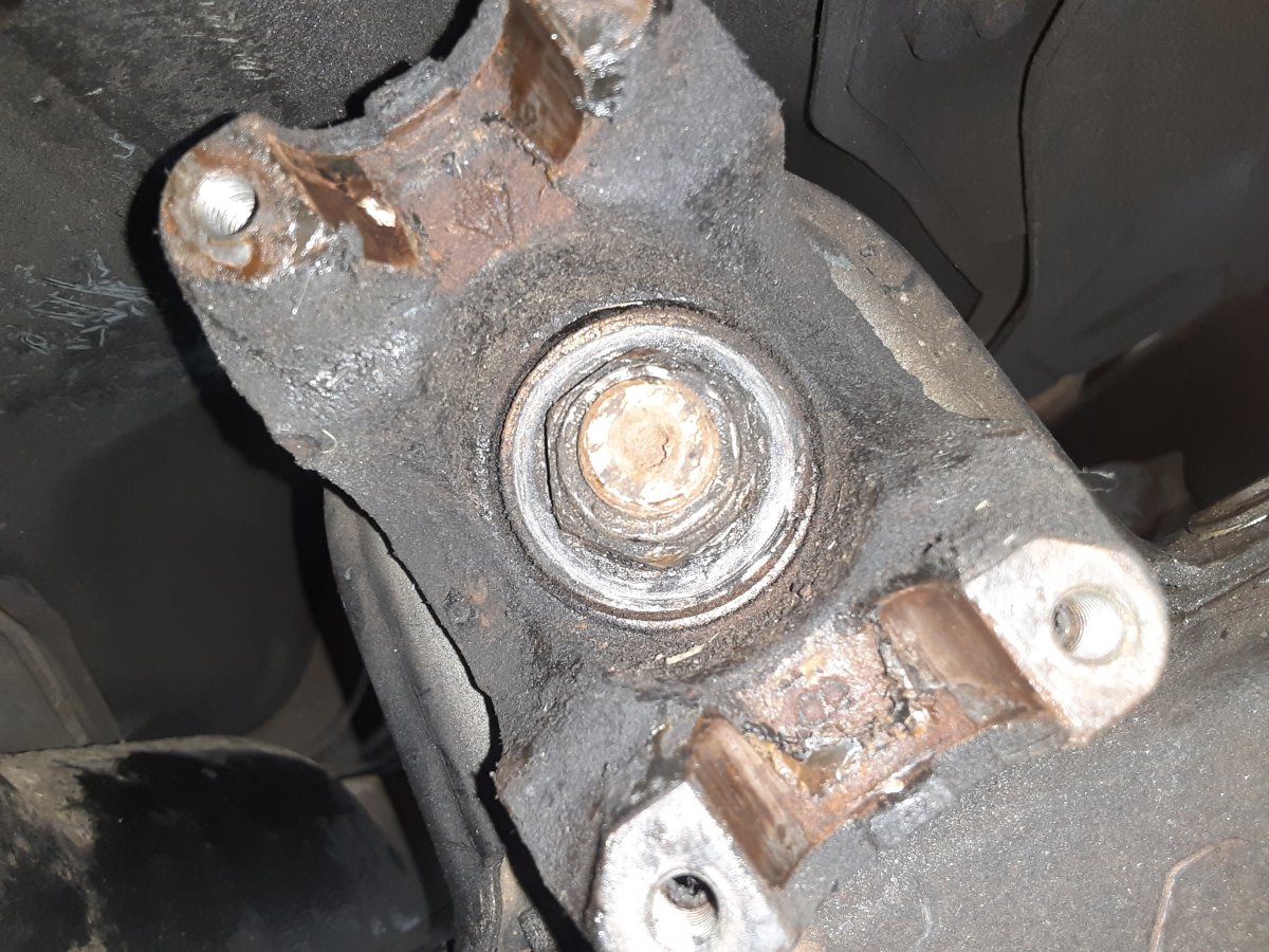

I got the bolt of the driveshaft too, but the wide piece that connects to the 2nd part isn't coming off. I've tried a hammer, twisting it and whatever else I can think of.

If you are trying to take the u-joint yolk off the shaft, put the nut back on so it is flush with end of shaft and hit it with a hammer

Yea the yolk, I was watching a couple YouTube videos and one guy tooka claw around the yolk and pulled it.
Since I dont have a claw. I'll try your method
You use the claw/seal puller to remove the seal AFTER the driveshaft is pulled out of the transmission.
My method was removing yolk from shaft, nothing to do with rear seal, just to be clear
When I did mine I used a 2 jaw puller to pop off the yolk and the bearing. I suppose a 3 jaw would work also.
