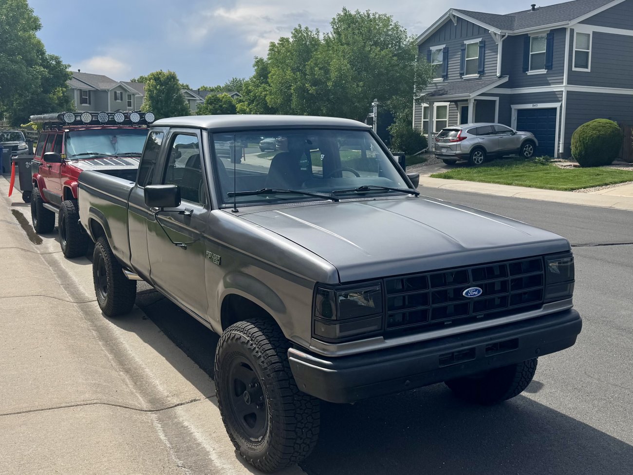

Looking for a company or someone who makes or could make a pre runner, tube style front bumper for my 91 ford ranger xlt. I’ve no luck finding one. Thank yall! This is a repost since I posted it in the wrong thread.

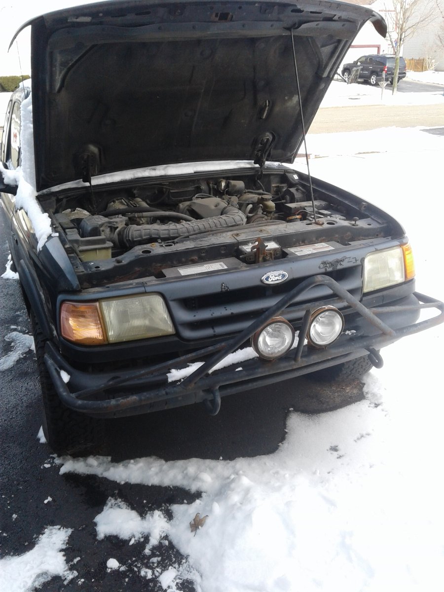

I actually used a stock bumper on one of my 3rd Gens as a base and just added tubing. It was pretty robust in the end.

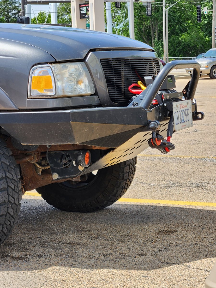

I will vouch for AOR though... I have a pair of their bumpers on my 06 and my Bronco II. They do some nice work.
