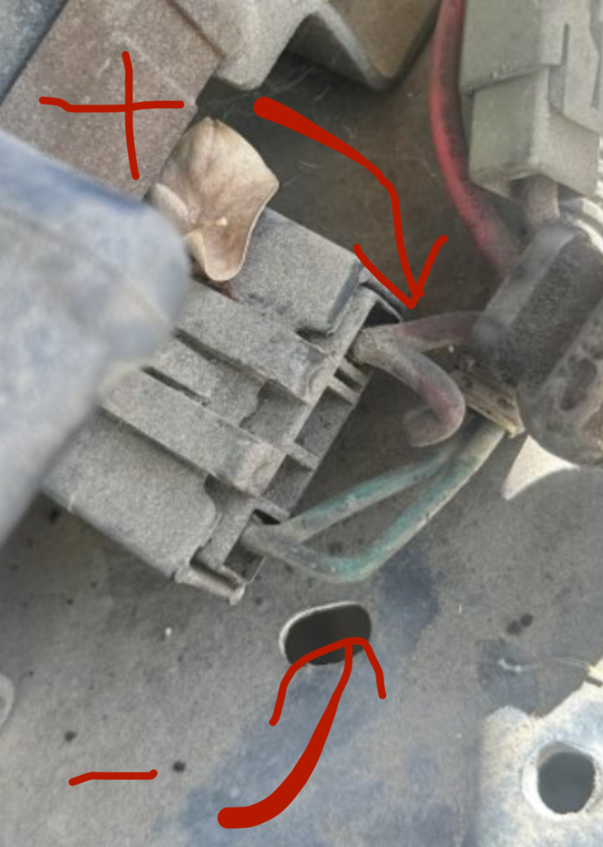

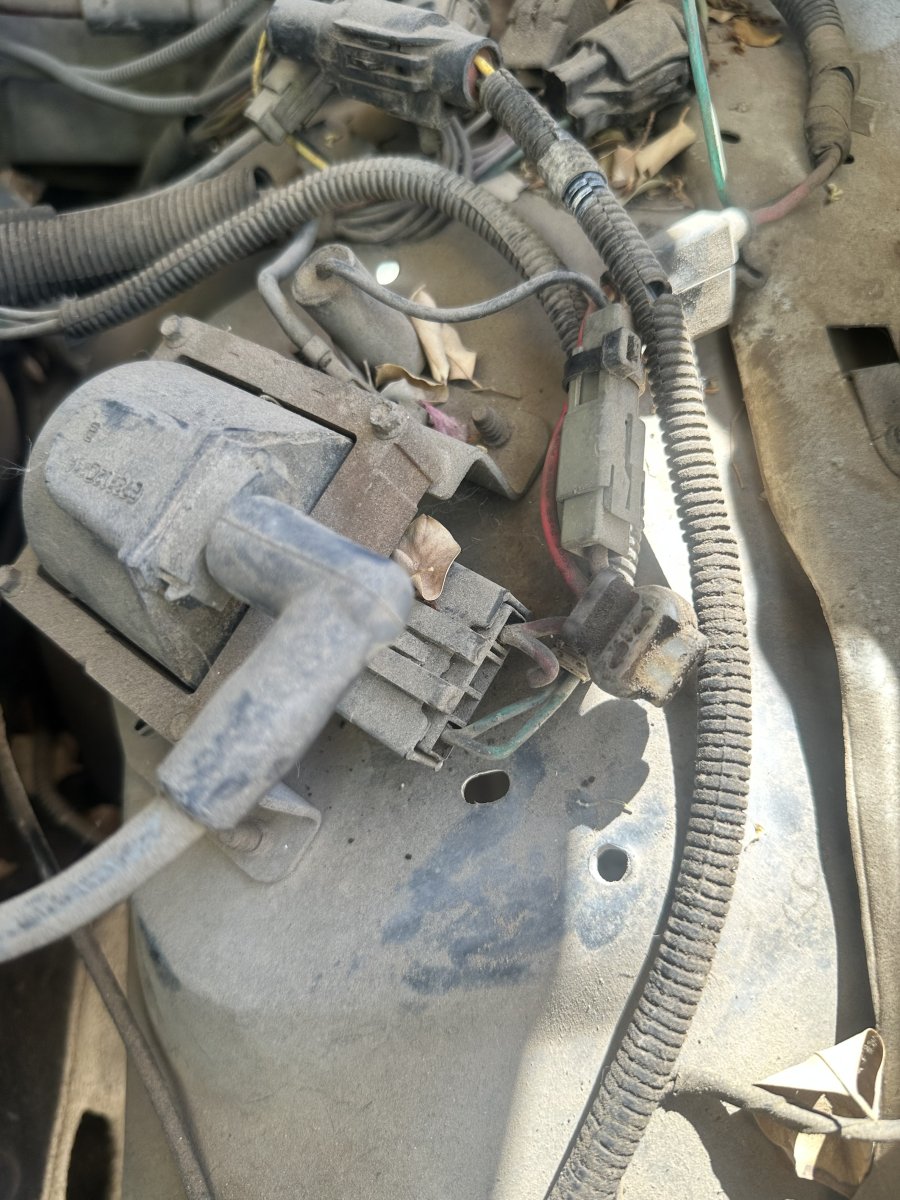

Later on i want to replace the coil with something nicer and clean up the bay. Does that harness to the coil look factory? Either way green to coil neg and red to red?

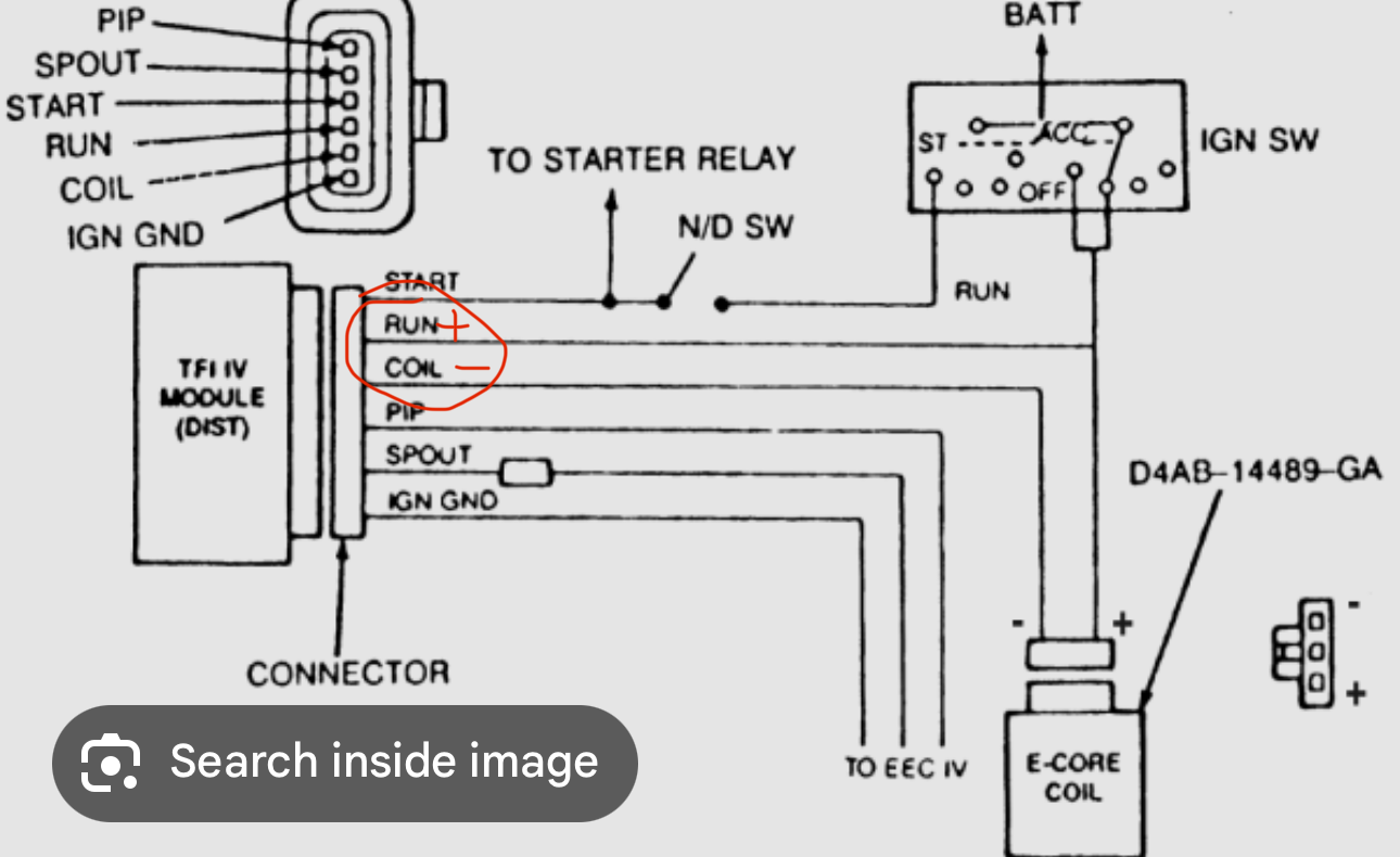

Yes, that looks factory. The TFI module mounted on the distributor drives the coil.

so when i replace the distro, leave the factory connector to the original distro unplugged and just tapped the green and red?
Yes, tap into the red/green that goes to the coil. That will still supply 12v to the coil, and your tap will supply the same 12v to the new distributor red wire.
There is a darkgreen/yellow dot wire that goes to the negative of the coil. This wire made it's way to the TFI plug originally. Cut it with some length to it, and tie this wire to the new distributor black wire.

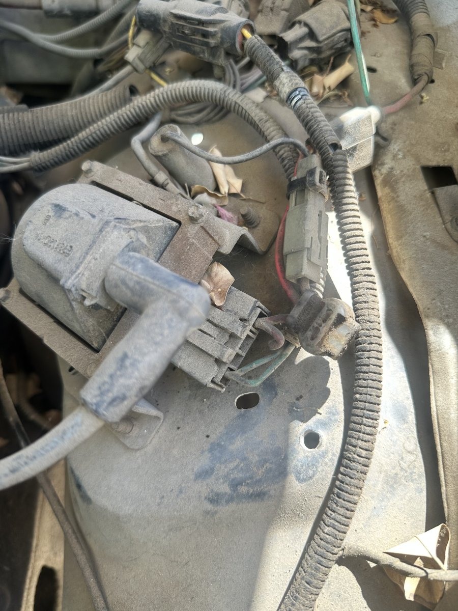

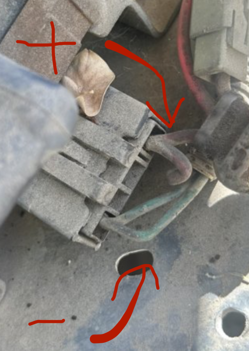

so closer to the distro those are what im tapping into? Obviously going to do this once i have the new non feedback carb installed. Just making sure i know exactly what im doing. Sorry for all the questions. Once this is done what harnesses can i remove from the engine bay? Vacuum solenoids? Etc..

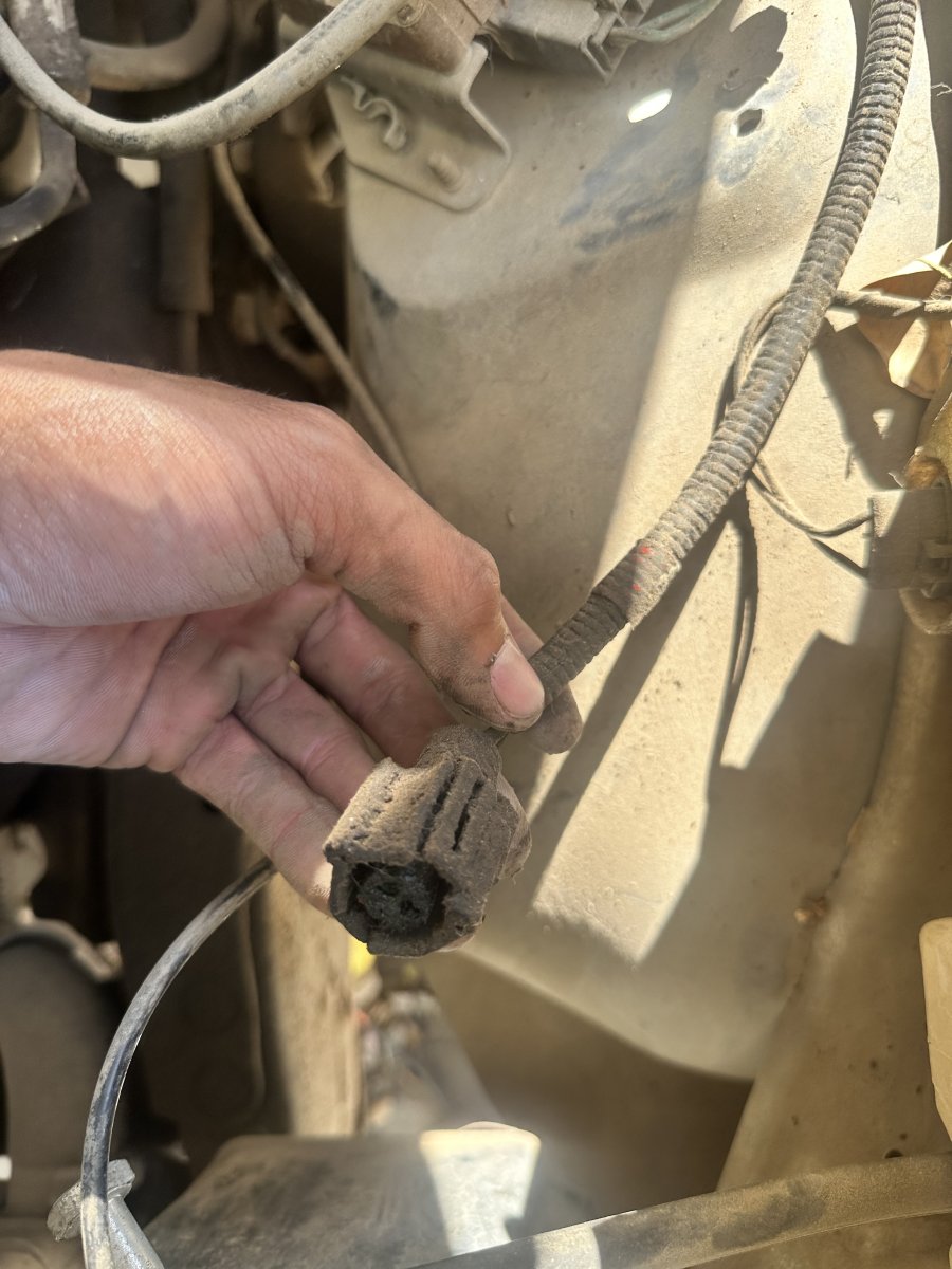

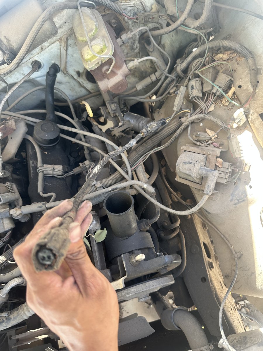

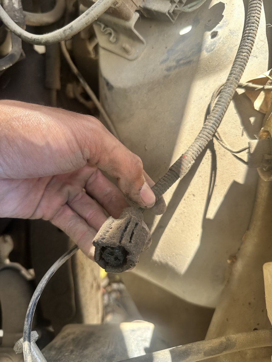

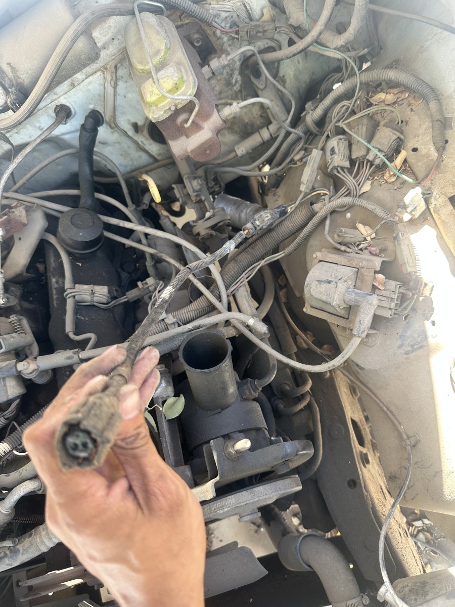

And does anyone recognize what this yellow black harness for? Left unplugged.

Yes, that is the spot. But drop back about 6 inches or so away from this connector for the red/green tap. And move 24 inches or more away from this connector and cut the green/yellow dot wire. It will stay plugged into the coil, and the far end of the green/yellow dot you cut will go to the black wire on your new distributor.

Gotcha thank you. Any idea what harness that is mentioned? Yellow black wire. Is it for my washer fluid or something other?
