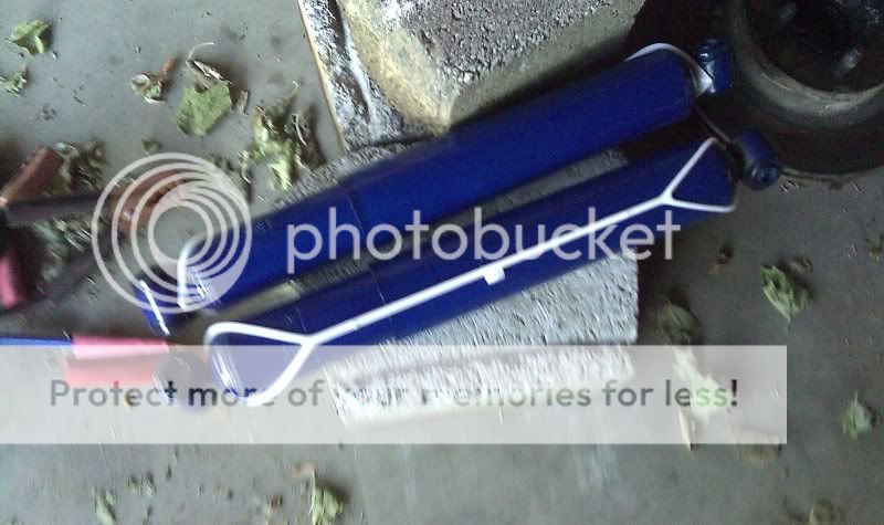

Gotta love the lifetime warranty. Got me some new shocks.
disciplerocks's B2 build thread
[/IMG]
What application are those shocks for?
Think they were for a full size Dodge. I just looked up the size I needed on a Monroe length chart.
