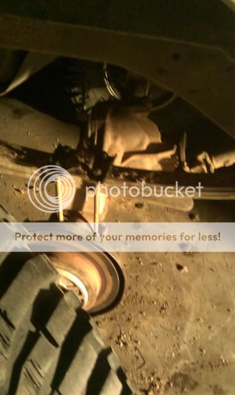

Got the old rear axle out and the new one in. Old axles officially for sale. Nothing hooked up yet. Gonna warranty out my rear shocks and I am still wanting to replace my leafs while its apart, but I don't think that is going to happen.

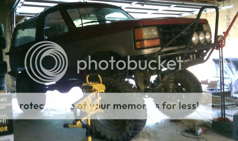

Couple random things to hook up, finish steering, add brake line extensions, align it, then hope there are no issues.

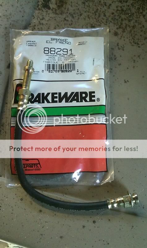

Do you have a part number for the brake lines? Or where did you get em?
I am using the 26" lines in the tech library and plan on picking up the extensions also in the tech library. Part number 88291.
Also found the part number H49757 works too. Some places can't find it by the first one. I did some searching and found the extension is actually for a 64.5-66 Mustang. Might be easier to look it up that way.
Extensions

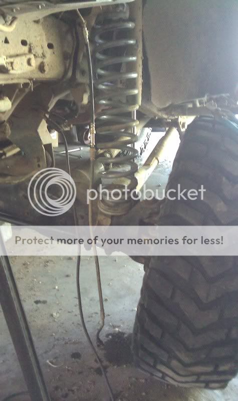

disciplerocks's B2 build thread
Installed. I think its long enough :D

And a droop pic :headbang:

Looks like you'll have some pretty decent wheel travel up front.
