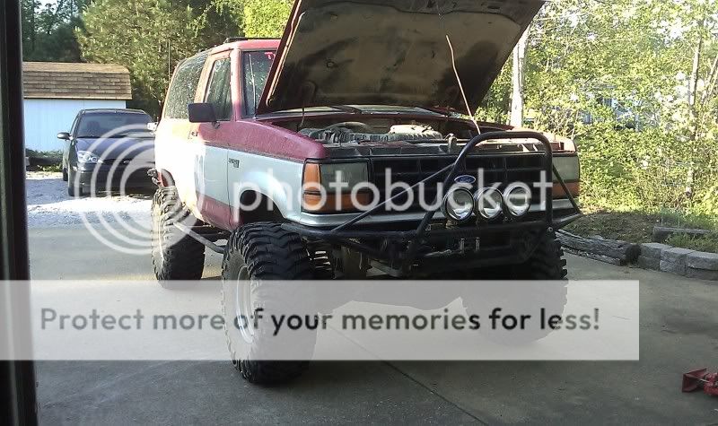

And she's all together
disciplerocks's B2 build thread
Looks good, did ya get a test drive in yet??
SVT
Not yet. Hopefully tomorrow.
Let us know how you like that 4.LO with those 456's!! I got the tub out of the knuckles on that 60, so I'm slowly making progress...
SVT
Good to hear. Can't wait to see SVT and WCB2 on the trails!
It'll be a close race to see which one gets on the trails first, if not at the same time :icon_thumby:
