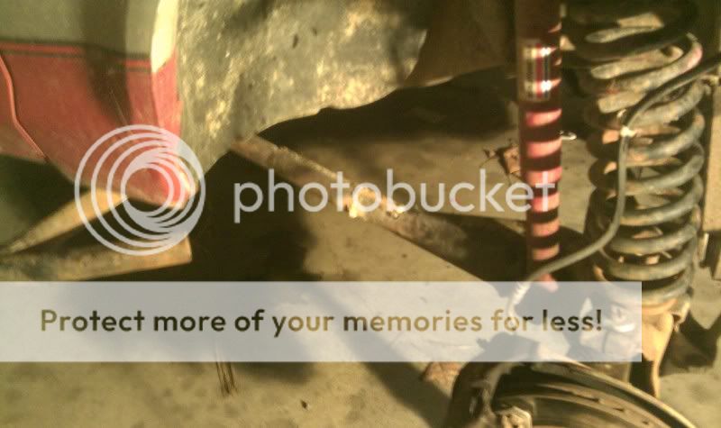

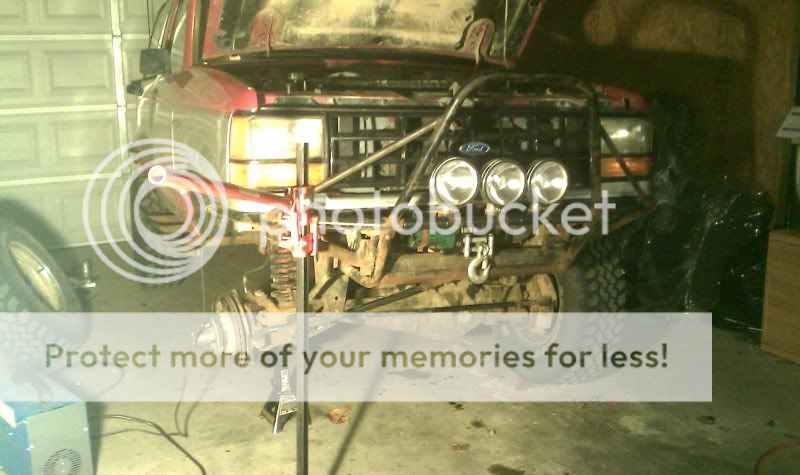

Well since its still not running right and I can't make it to the junkyard to pickup a different MAF until I am off these 12 hour shifts, I decided to work on some other stuff. Braced passenger side extension (which already had a D28 arm on it) then I got the driver side D35 arm removed. Ready for the D28 to go in and get braced.
