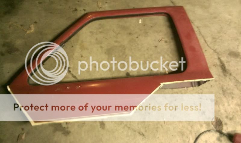

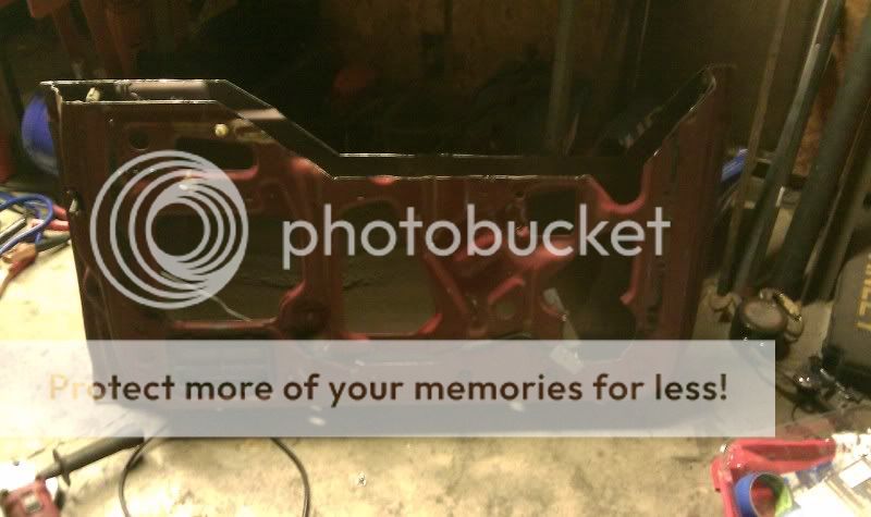

Also welded the brace onto the drivers side arm, got my tach working again, burned some boxes that were left from moving, cleaned the driveway and garage floor of leftover parts and tools, and started a new project

I'd say I had a pretty productive afternoon.
