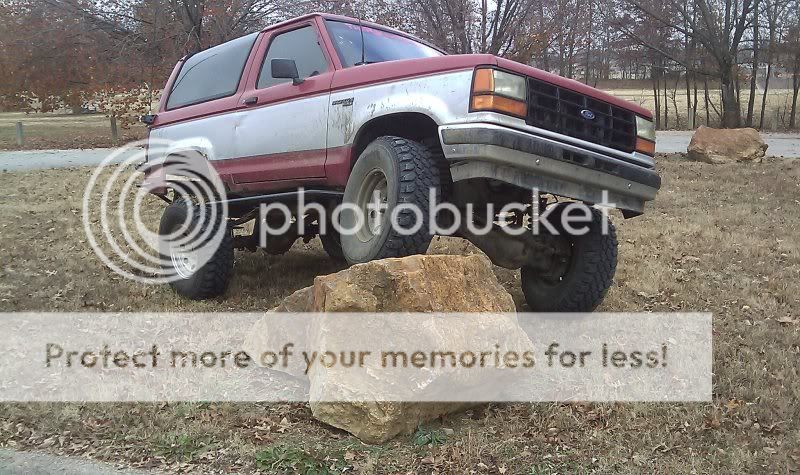

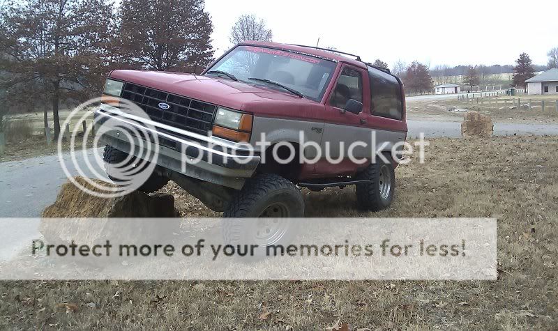

Is it tweaked up cause the body is flexing or is it normally like that?
The body is flexing. Rear ds body mount is poor and the ps one doesn't exist anymore. Damn rust.
i was thinking the same thing. looks pretty good man. fab you up a nice front one to match!

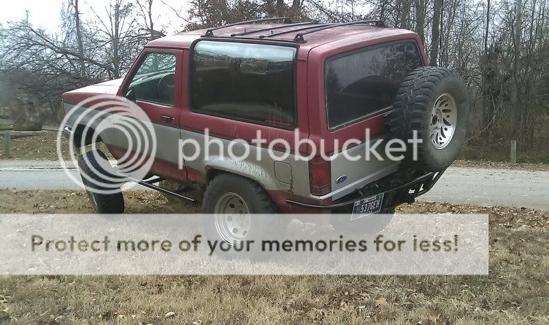

Ok so I replaced my ball joints last week and finally found a place that had the tie rod I needed in stock. Now I still have a problem. I am camping right now, but on the highway coming here I noticed a lot of swaying. Pretty sure it wasn't the steering. It stayed straight, but everytime I hit a bump the hole body rocked back and forth. I don't know if it is bad body mounts or if I am just too tall. Going to put the front sway bar back on with some quick disconnects and see if it helps.
i would say body mounts....
the rear of the body was riding on the rear bumper...now the new bumper isn't as high....
l8r, John
Thats probably it.
