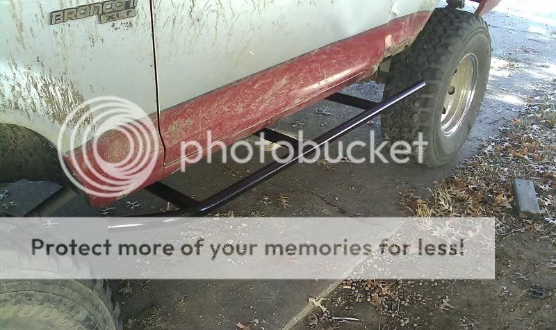

disciplerocks July 2011 OTOTM Winner OTOTM Winner V8 Engine Swap Solid Axle Swap TRS Banner 2012-2015 Joined May 27, 2010 Messages 4,521 Points 3,101 City Evansville, IN Vehicle Year 1989 Transmission Automatic Nov 14, 2010 #211 All done
B2Guy 15+ Year Member Joined Jul 21, 2010 Messages 410 Points 3,101 City Lafollette, TN Vehicle Year 1989 Transmission Automatic Nov 14, 2010 #212 looks good man
railman December 2011 OTOTM Winner OTOTM Winner Solid Axle Swap TRS Banner 2010-2011 TRS Banner 2012-2015 Joined Mar 31, 2009 Messages 2,660 Points 3,101 City Madisonville, KY Vehicle Year 1996 Transmission Automatic Nov 14, 2010 #213 i hope you capped the ends and added some gussets on the frame side mounts.... looks good lord knows i really need them.... l8r, John
disciplerocks July 2011 OTOTM Winner OTOTM Winner V8 Engine Swap Solid Axle Swap TRS Banner 2012-2015 Joined May 27, 2010 Messages 4,521 Points 3,101 City Evansville, IN Vehicle Year 1989 Transmission Automatic Nov 14, 2010 #214 I have no way to cap them. And I will be adding some gussets at a later date. Need some smaller tube. And why do you need them? Can you possibly do MORE damage? Lol.
86 slo-vo 02/2011 OTOTM Winner OTOTM Winner TRS Banner 2010-2011 Joined Jan 5, 2009 Messages 4,510 Points 3,101 City owensboro, KY Vehicle Year 1994 Transmission Manual Nov 14, 2010 #215 they are going to need alot of gusseting out that far, drop on a rock and it just going to push up into the cab

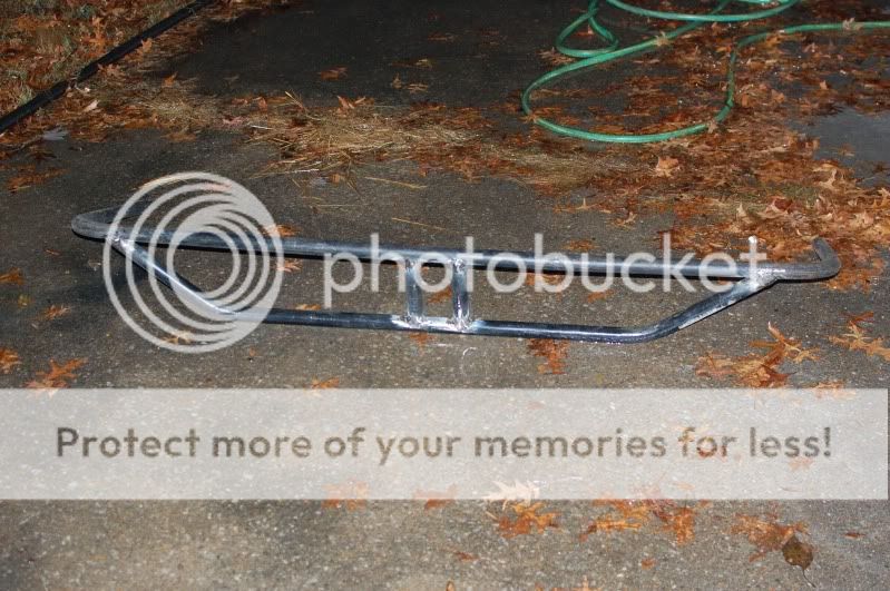

disciplerocks July 2011 OTOTM Winner OTOTM Winner V8 Engine Swap Solid Axle Swap TRS Banner 2012-2015 Joined May 27, 2010 Messages 4,521 Points 3,101 City Evansville, IN Vehicle Year 1989 Transmission Automatic Nov 16, 2010 #221 More progress.
Kyle M. GOING FOR BROKE OTOTM Winner V8 Engine Swap Solid Axle Swap Joined Mar 24, 2008 Messages 2,218 Points 3,101 Age 46 City Howard City Michigan Vehicle Year 1993 Transmission Automatic Nov 16, 2010 #222 Having fun notching tube yet??? Looks good! But better be sure to add more beef!
disciplerocks July 2011 OTOTM Winner OTOTM Winner V8 Engine Swap Solid Axle Swap TRS Banner 2012-2015 Joined May 27, 2010 Messages 4,521 Points 3,101 City Evansville, IN Vehicle Year 1989 Transmission Automatic Nov 16, 2010 #223 Thanks. Thats just for the hitch receiver to be mounted in. Still a bit to go before its finished.
railman December 2011 OTOTM Winner OTOTM Winner Solid Axle Swap TRS Banner 2010-2011 TRS Banner 2012-2015 Joined Mar 31, 2009 Messages 2,660 Points 3,101 City Madisonville, KY Vehicle Year 1996 Transmission Automatic Nov 16, 2010 #224 the way i capped mine, was that i took a cheap bolt with a washer the same size as my tube..... tacked the bolt to the washer.... held onto the bolt while i tacked the washer to the tube.... then took a cut off wheel and cut the protruding bolt.... welded her all up.... and yeah you will need to add some more tube to strengthen it up..... looks like a really good start though... l8r, John
