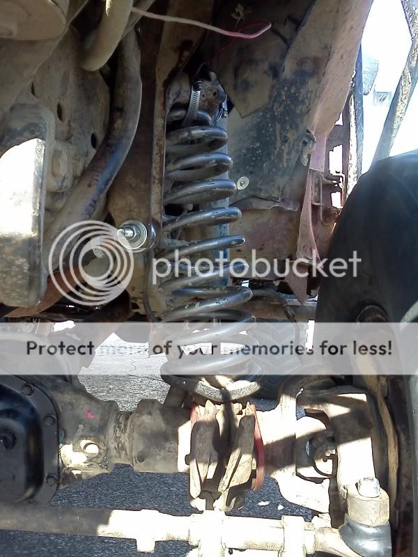

Moved the perches in an inch and let the coil make up the rest. Going to replace or modify the stock buckets though.

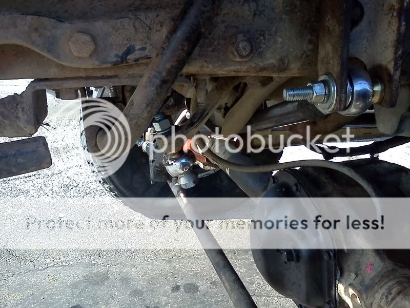

Crossmember still needs clearanced. Trac bar hits it. And the drag link still has the old bracket welded on.

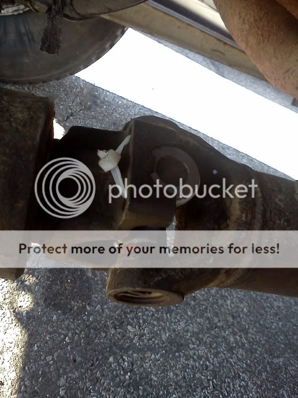

And my heavy duty u-joint straps. Those aren't permanent btw..

you may as well just order up some fullsize coil buckets from the bronco graveyard so you can avoid those upper spring retainers and space the buckets out at the same time. other then that and the you joint strap it looks good
Still might steal the buckets off the truck at the u-pull.
And I have to find the right size ubolt or strap for the joint.

How the hell is that zip tie still holding up?
That crossmember is going to need a good trimming from the looks of it. Anyways of modding the track bar for it to fit better around the crossmember?

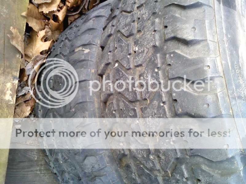

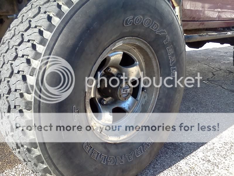

What do you all think of these. 4 Goodyear mtr 35s on 5x5.5 wheels.$130.
disciplerocks's B2 build thread
Not much life on those. if your gonna run adapters on the rear id say its worth it for the rims, that way theres no need for two different spares with different bolt patterns.
For tires and rims that you need, I would do it.
My local JY sells rims for $25 each and tires for $20 so you are getting a deal for all of them in one.

Get em. Run them untill you find something else. Ot come up here and get those 37 claws.
They are better than my current tires. And cheap.
