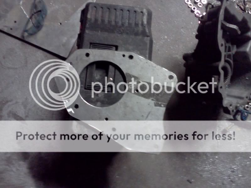

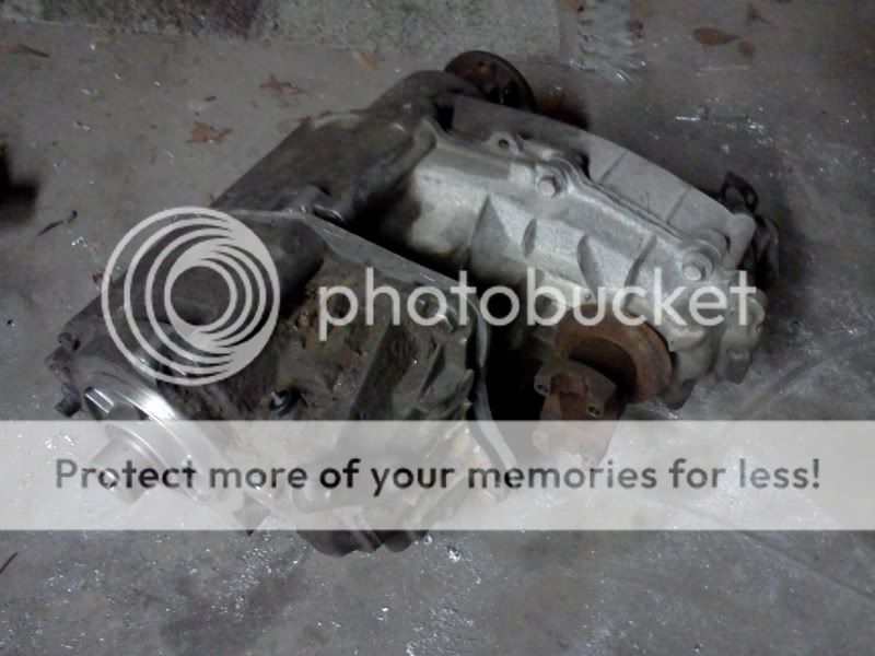

So if I was to attempt this doubler thing... How much money do you have in it?
$40 for t-case, but I bought another so I could build and assemble it without having the B2 down in the process so $80 there.
$50 for shaft. He said it would cost $70 for anymore though.
$15 for 5" hole saw
Aluminum plate was free from work.
No not done, but damn close. Shooting for installing the week between Christmas and New Years. Couple things left on the doubler and need driveshafts adjusted.
