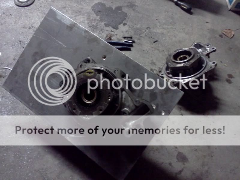

Got a little work done. I'm using a 1350 planetary as a mock up. You can see the 6 gear 1354 set I will be swapping to.
Also figured out what I am going to do about shifters. I will use the stock linkage for the doubler case. And building my own linkage for the 1354e case. I will only need to be able to shift from 2hi to 4lo so it shouldn't be too bad. If I do need 4hi, then I can crawl under it and shift it manually.

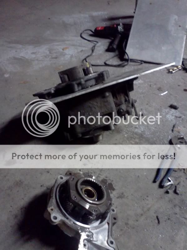

Ok so the doubler is ready to bolt together. Just need to tie up some loose ends. I got about half of the plate cut and my grinder died, the shift fork shaft needs cut, need to pick up a couple more allen bolts (they are stronger and provide more clearance around the bolt head), the planetary set needs swapped on the doubler case, and the whole thing needs disassembled and cleaned out.
Also going to make a pattern of the plate for a backup. Or just in case I do add a third case :D

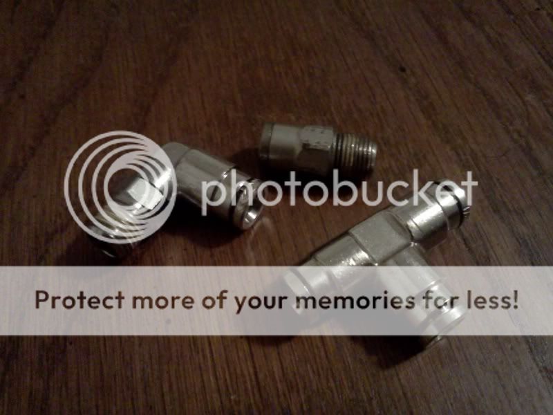

New breather fittings
