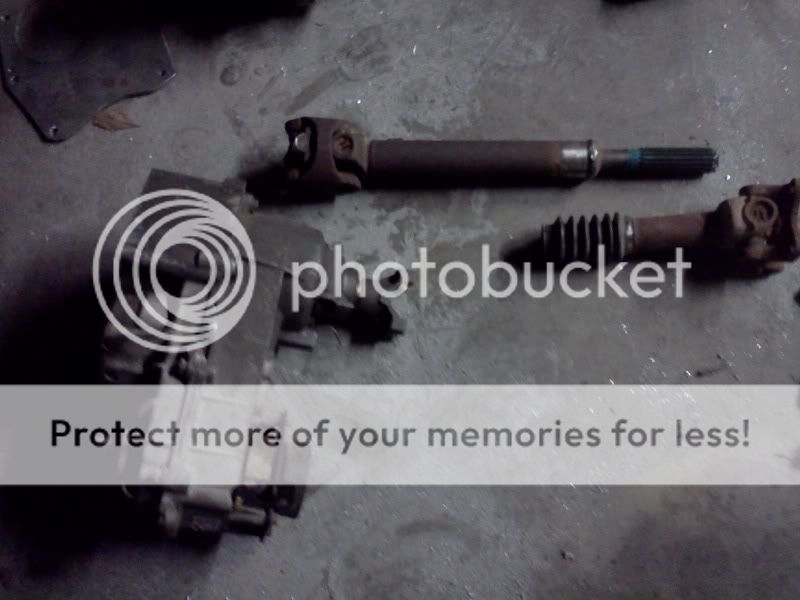

Picked up my driveshaft from being shortened. And moved the front yoke to the rear to make it work (yes you can do that). Working on getting another to replace the front one.
