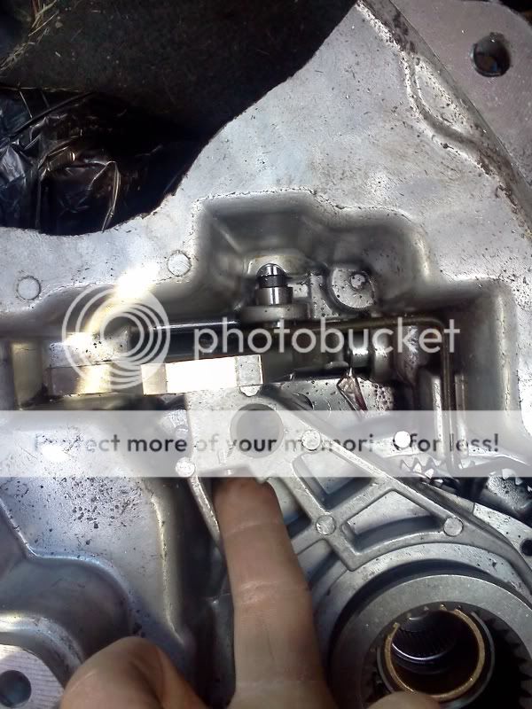

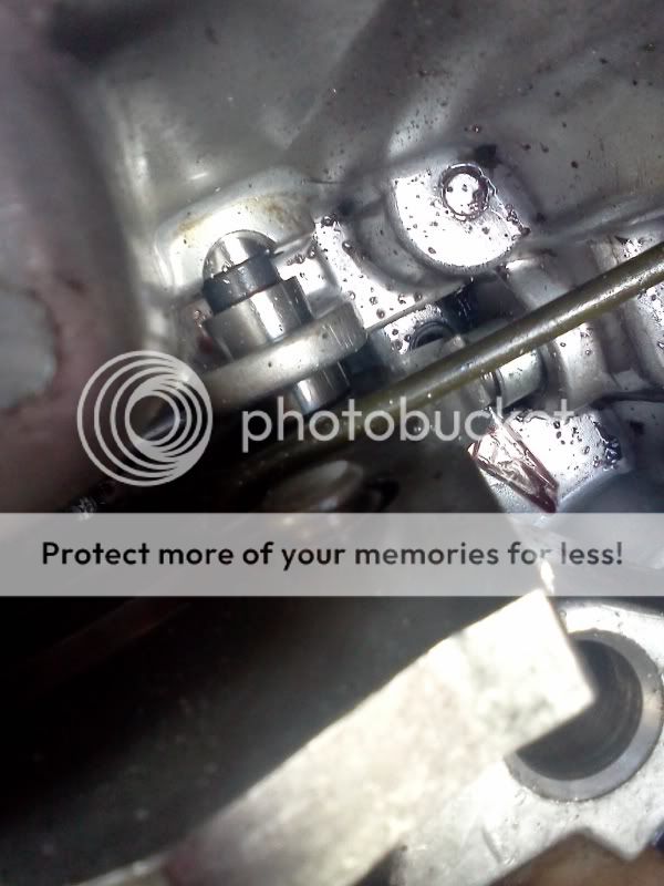

Does anyone know if there is supposed to be a c clip on the end of this pin to hold the fork in? I makes sense, but there's not one there.

Yes. It should be an e-clip
Edit. Nevermind I thought I was looking ay something else. No there isn't any clip
Figured as much. I'll have to pick one up.
yes there is a small c-clip that goes there.
I picked one up. I think there's supposed to be a pin between the case and fork for a pivot point too. Why is this thing missing all the little pieces? Good thing I noticed before assembling it.
Better watch the slip on the front with alot of droop. Could slide all the way out or even worse just to the edge then the yoke could bind and break the case off.

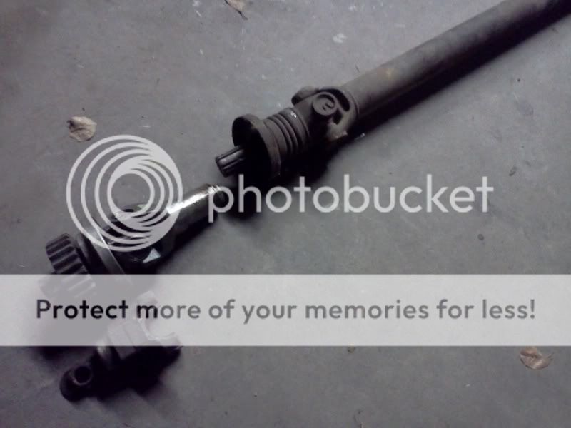

Really wish i had a 1354 to throw on there. I just found and easy way I could have lengthened the front shaft.

are they the same splines???
l8r, John
Thats the female end from a 1350 t-case.
Dustin, pick up a 1354E, they are a dime a dozen and cheap. Split the cases and use the rear half of the 50 and front side of the 54, and all the internals of the 54 (6 gear planetary over the 50's 4 gear)
