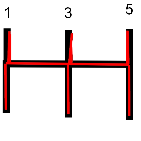

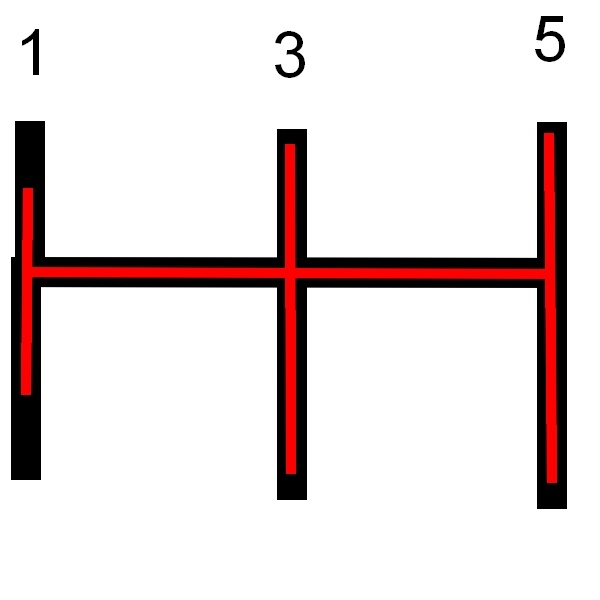

actually with all that done, I would suspect bent shifting forks first... does it slip into gear easier if you kinda "ride the edge" meaning after you find the notch you push the shifter all the way to one side or another of the notch.
normal shift pattern in red - you look for the center of each slot:
Difficulty shifting into 1st, 3rd, and 5th - M5OD-R1
riding the edge, (this example the right/right/left - 1/3/5), you find the notch then hug the edge of the slot (try both right and left):
only do this as a diagnostic don't use it as a "oh it works, I'll just get by like this" - pushing laterally (or resting your hand on the knob between shifts) bends the shifting forks.

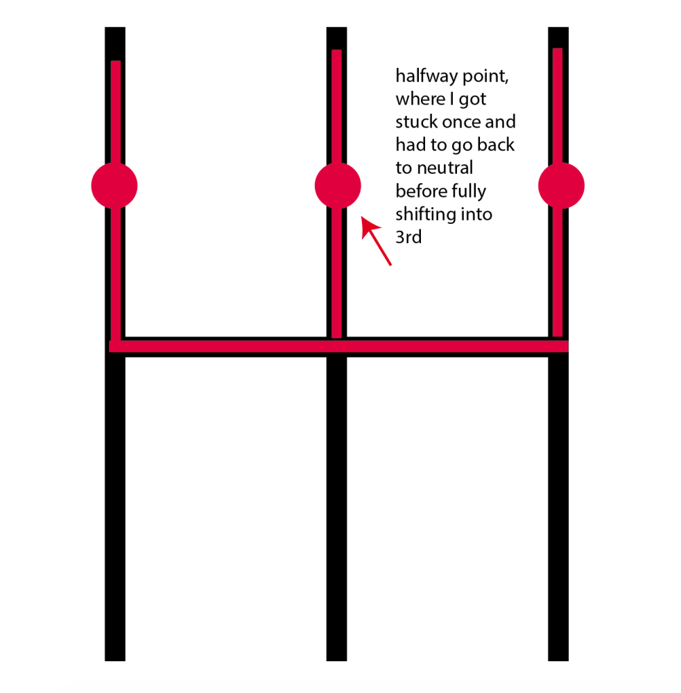

Thanks for the diagrams @Brain75 those are super helpful. I just went out and played around with the shifter again (stationary at first, then driving around) and I don't think I had to change which "edge" I was on in order for the gear to go into place. However, I did notice that what I mentioned before ("When at a stop light, I’ll test 1st gear to see if the resistance to it happens two, three times in a row: it seems like for 1st gear, after the first try, I’m able to slide the shifter into place with no resistance.") also applied to 3rd and 5th.
The specific type of resistance I'm experiencing has to do with how far I'm able to move the shifter before it goes into place. It seems like there are two stages required to move the shifter into place. Starting from neutral and going into 3rd, for example, I move the shifter up halfway (where it seems to settle in place) before moving it the rest of the way. In the spirit of diagrams, I made one as well. Once when I was driving, I went to shift into third and the shifter stopped at this halfway mark. I couldn't go any further and had to pull the shifter back into neutral, at which point I tried to shift into 3rd again and it shifted no problem.

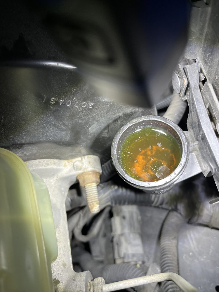

I attached a photo of the fluid in question to see what y'all think. I think it looks sort of murky (is that sediment gathered down at the bottom of the reservoir?) but could be wrong.
First, that doesn't look like enough room for the diaphragm in the clutch reservoir, is that rubber thing there?
@scotts90ranger the diaphragm was in there (I removed it for the pic), although I guess the fluid could be too full? Any guidance on this or the stuff that seems to have settled in the bottom?
