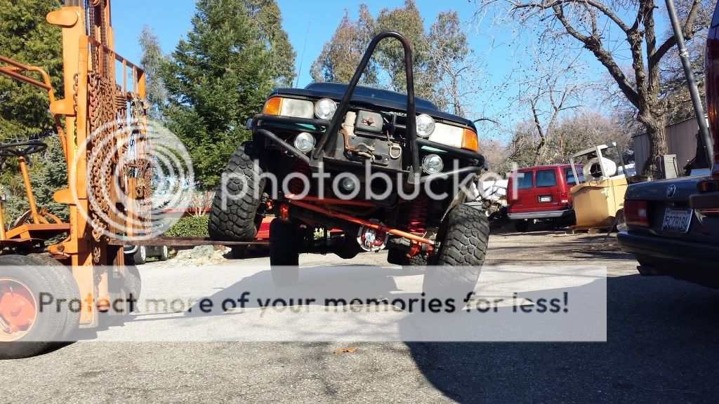

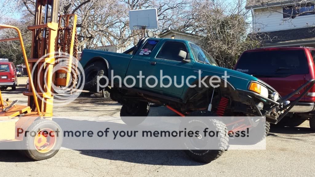

My dad finally got his forklift up and running, so I flexed it out to see its max and make sure nothing was bottoming/topping out.
First I lifted the passenger front tire:
The front tire only came up 27" before lifting a rear. That was pretty disappointing to me, but it is what it is.

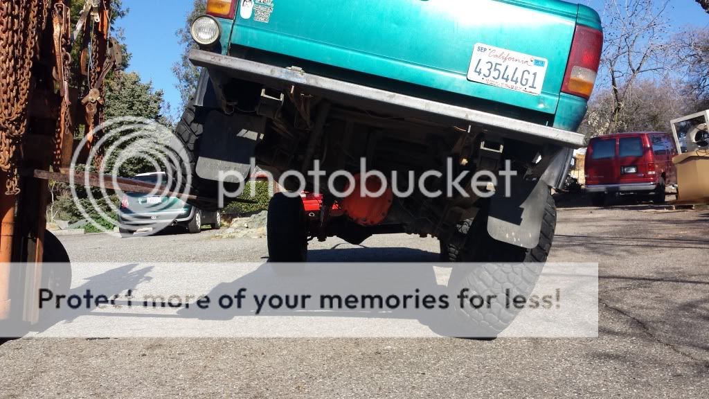

Then I lifted passenger side rear. I got the rear tire 42" off the ground before it looked like the other rear tire was going to try and lift.

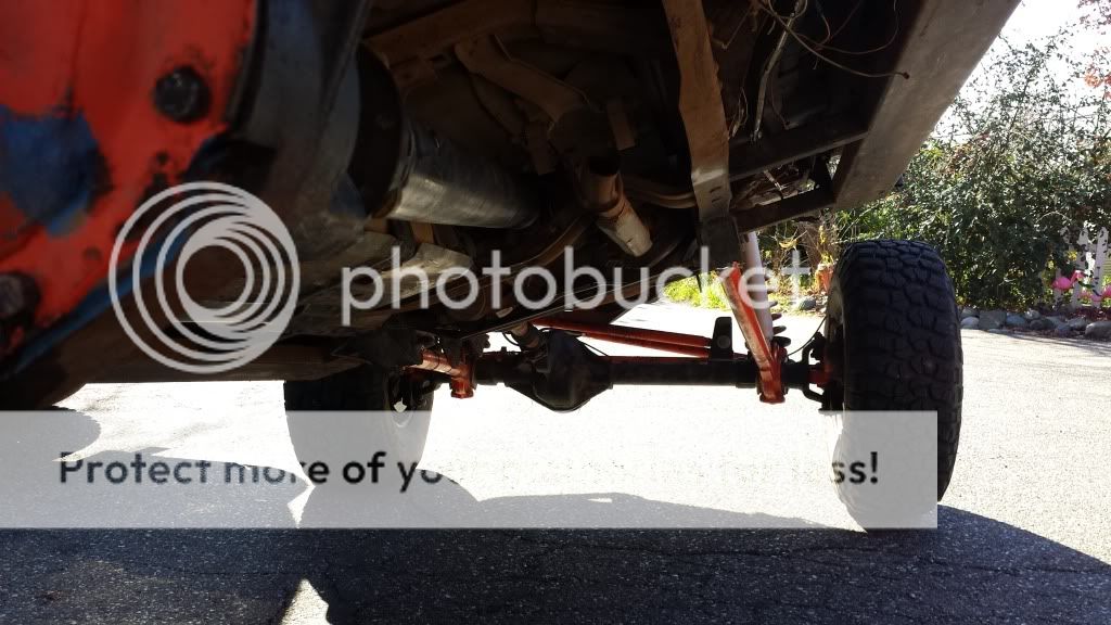

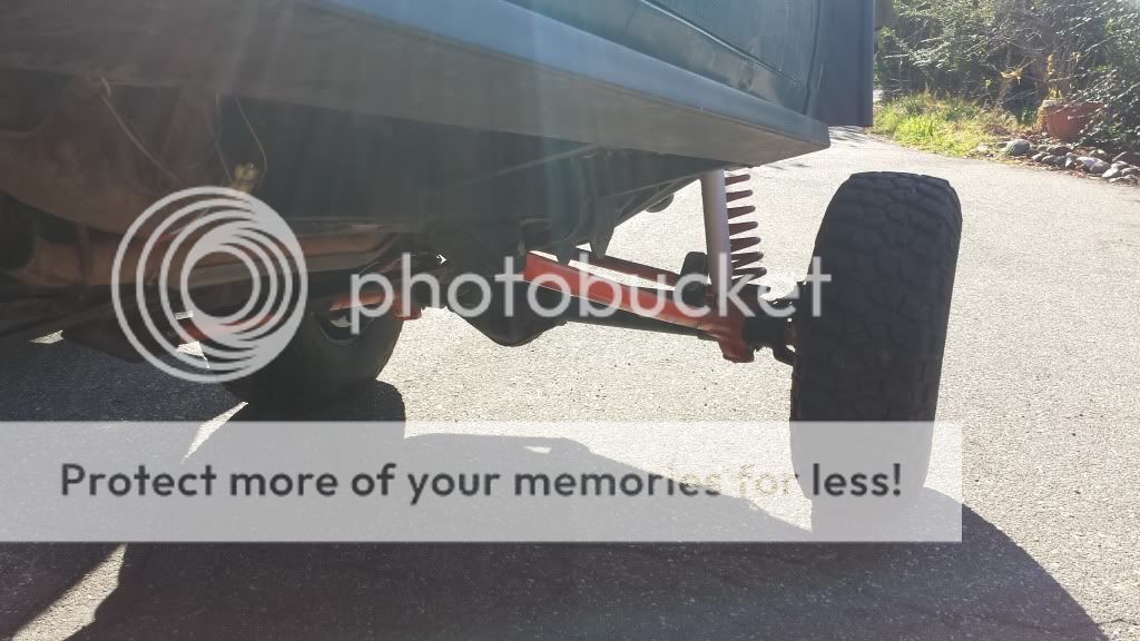

When it was flexed all the way, check out the radius arms:
You can see that they are starting to arc pretty heavily from the axle twisting. I'm really glad that I went so long with the radius arms. OR maybe I kind of wish I had done a 3 link instead :dunno: . idk, coulda shoulda woulda...

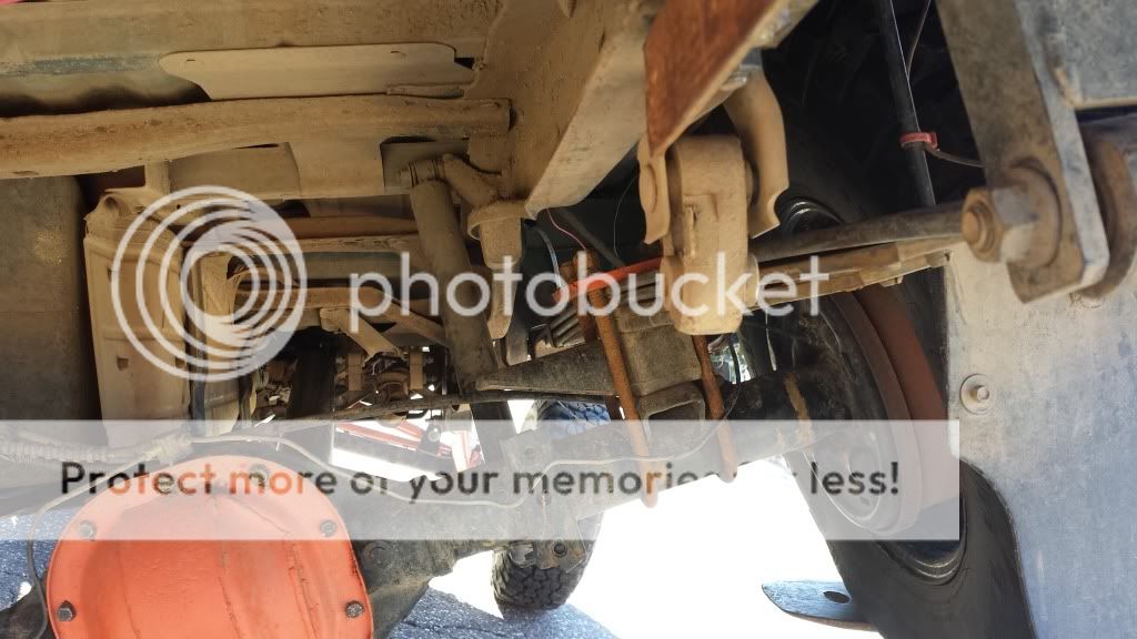

Also, the leaf springs will reverse pretty good when they are in full compression
Is that horrible for them? I know that it isn't good, but the leaves are oe so its not like I am super worried for them. I just don't want to break a leaf spring in the middle of BFE.
Next up I lifted the drivers side front tire, and got it 36" off the ground, but forgot to grab a pic
Lastly I picked up the drivers side rear tire, and got it 33" off the ground
So why the discrepancy? There was a slight incline, so when I was lifting the passenger side, there was more weight forward. could that have caused such differing numbers? It also seemed that consistently when the passenger rear tire was drooping the flex would be less. The driveshaft IS hitting the gas tank skid when the flex gets pretty extreme, so maybe that is limiting it? I guess Ill check it all again once I get my skidplate to stop interfering.
If you could have gone 3 link (eliminating the ford radius arm setup) I would have. It would almost eliminate axle hop, driveline binding, and suspension binding.
So far I dont have driveline binding or axle hop, just the suspension bind. And it seems to flex good imho, I just don't like seeing the arms bend. Maybe my next axle (assuming no cast wedges) I will just have to bite the bullet and do 3 link :-\
Sent from my SCH-I545 using Tapatalk
My driveline hit the tank skid too so I put a bII tank in the rear,fit like a glove and was easy to plumb in.plus it moves a little weight to the back where youhave none
